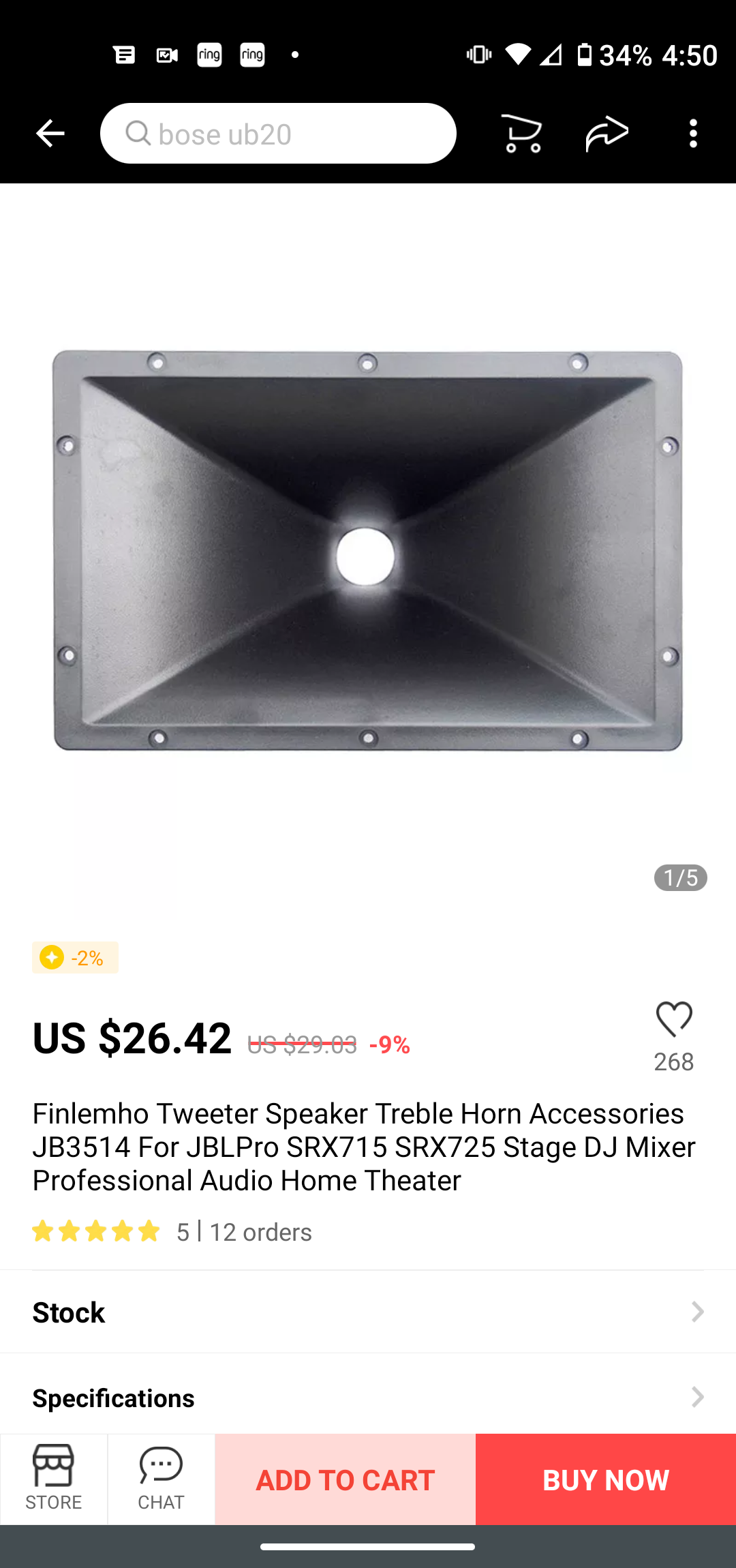

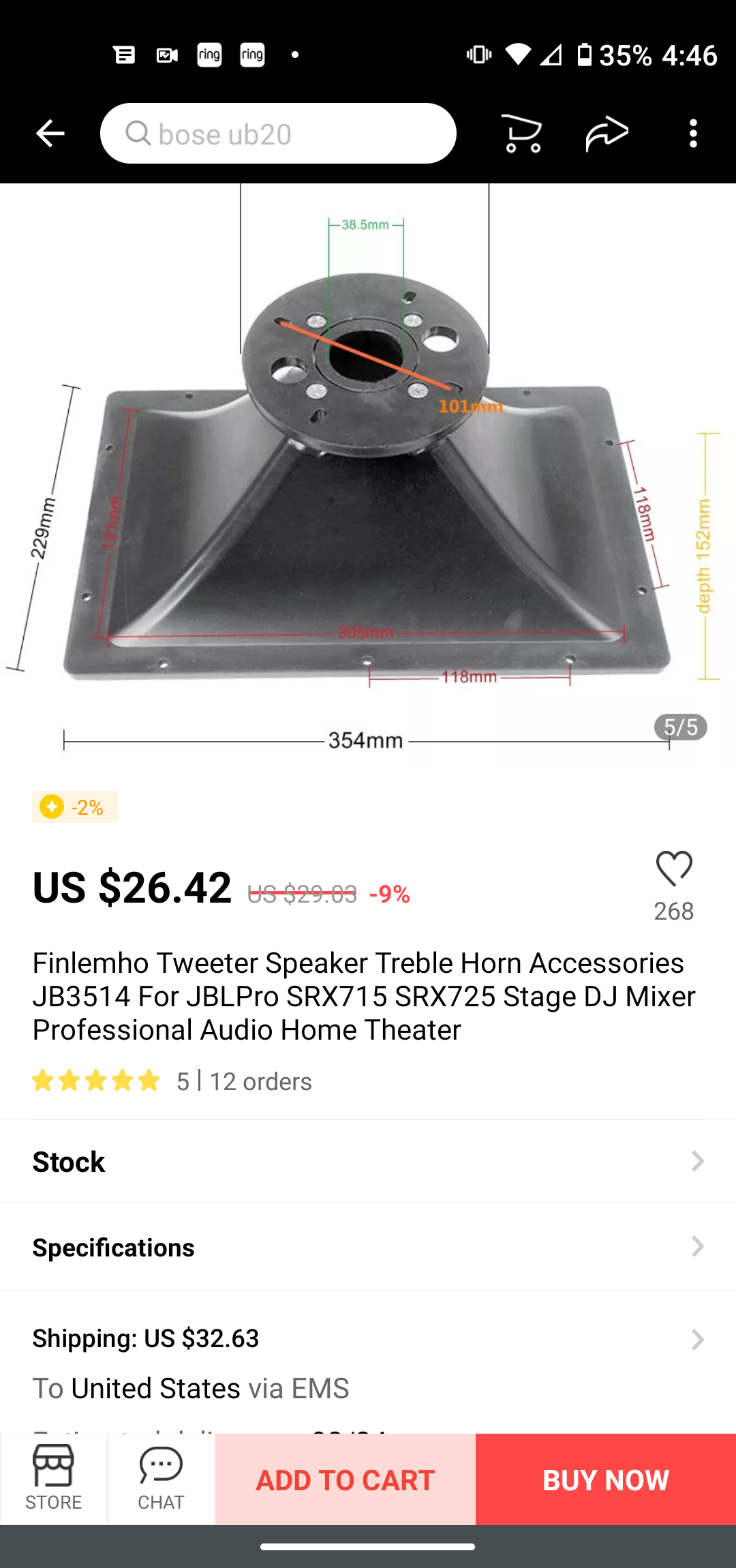

I also think that a waveguide of similar dimensions would probably work fine. For instance, there are some plastic clones of the 18Sound XT1086 out there which would probably work nearly as well. The 'real' XT1086 won't work because it's metal. (Unless you're prepared to figure out how to cut through the metal sidewalls!)
Just checked, and found clones of the 18Sound XT1086 on Aliexpress. Wasn't able to find any QSC clones. For the XT1086, they didn't even bother to change the name, just search 'xt1086' and look for the ones made of plastic.
