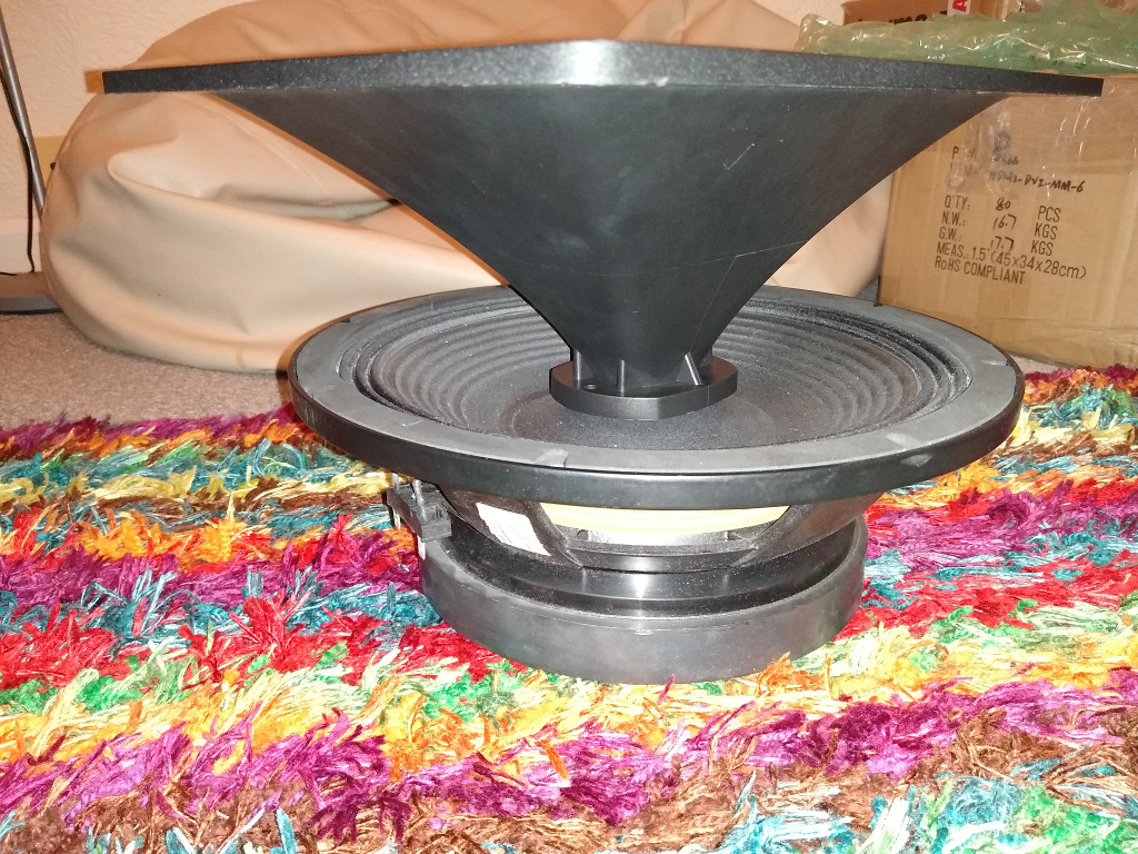

My waveguides arrived, how are people going about measuring the curved walls to make adapters?
I was thinking of sticking as much woofer as I could cram onto the waveguide and using it as an ultra compact PA top, I would need to do some simulations but I was thinking of mounting a woofer directly behind the compression driver (small BMS) and using 3D printed tubes to route the output of the woofer into the waveguide. Am I right that if the tubes are continuously expanding from the woofer to the horn I will avoid a pipe resonance mode?
This was one of the things that became an issue for me.
Basically my adapters have a flat face, and the walls of the waveguide aren't flat.
So I had to use a TON of liquid nails to fill the gap.
Ideally I'd like to minimize that space between the midrange adapter and the waveguide walls. Because the longer that the midrange taps are, the lower the crossover is. (Which is BAD.)

I cut thin sheets of cardboard templates to match the walls at several intervals (4 or 5) and then digitized the shapes as jpg images which were then fit with a 2-3 point spline, and used as profiles for doing a loft operation in SolidWorks. It’s a lot of work vs having a 3D scanner - but works if you don’t need to do it all the time.
I've been using tools like this for odd shapes/contours since before school age: Saker(R) Contour Gauge Profile Tool – Smart saker

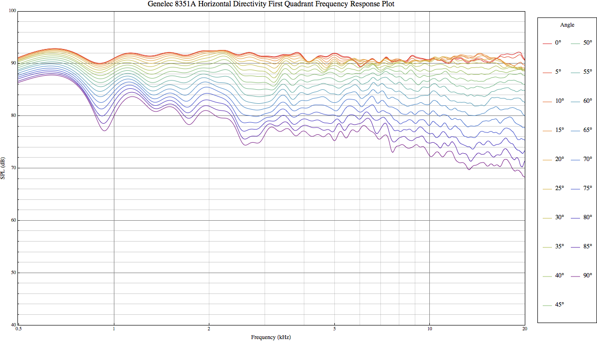

Here's the polar response. This is pretty darned good I think. I've been building speakers for over 20 years and this polar response is Top Ten I think, among my designs. Keep in mind, these measurements are very early. The speaker is mounted on a cardboard baffle and I invested a grand total of about 30 minutes tweaking the crossover. IE, these results will improve.
To me, the Gold Standard is generally Genelec. From the measurements published at audiosciencereview and Princeton.edu, their directivity is about as good as it gets.
Here's my speaker
And attached are the polars of the $6000 Genelec 8351A
The parts cost on my speaker is about $500 per pair.
Here's my speaker
