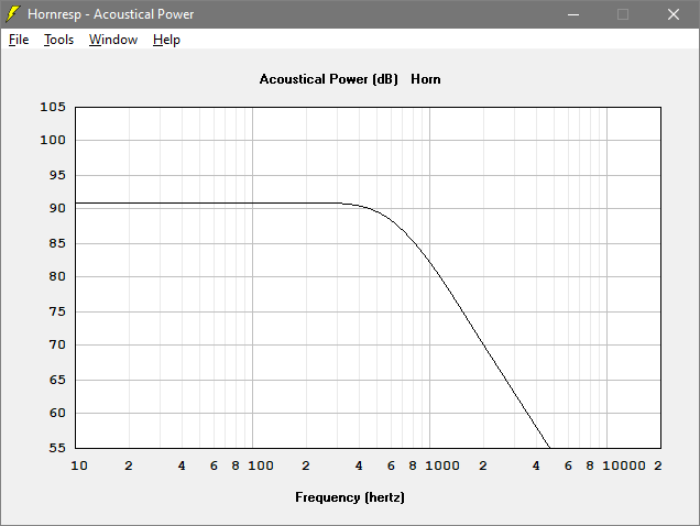

And theoretical 😎 FR for four Qtc=0.0.. subs:

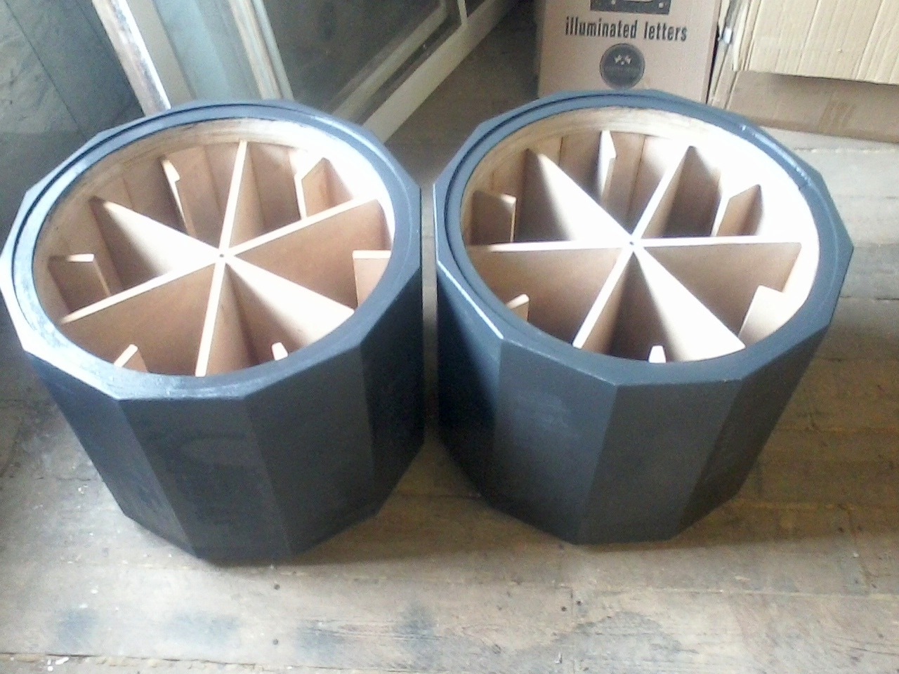

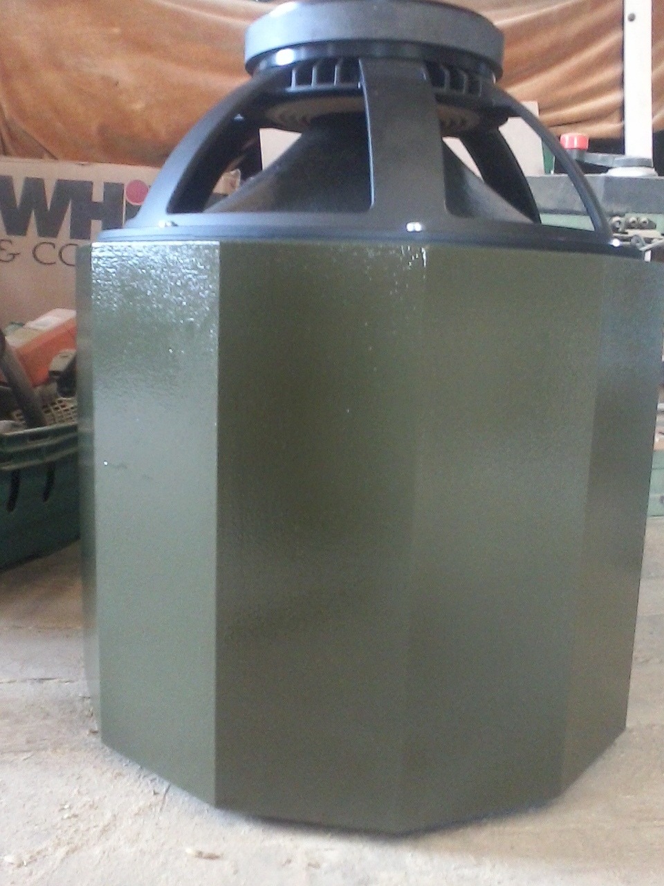

I use exclusively sealed subs (Qtc ~ 0.5; 18"=Qts 0.24; 21"=Qts 0.37; Vd total ~15l; amps ~20kW) for my PA and have never had any complaints about it being too quiet, or lacking bass (DJ classic rock). I use digital sources but the system requires a 25Hz HPF if a guest is using vinyl to avoid feedback. Plenty of enclosures, plenty of EQ and plenty of power required though - that's the price of high fidelity, dynamic headroom, and low efficiency...I may need to do a bit of experimentation. Have you guys found the bass extension of low Q sealed enclosures to be really lacking or not as bad as it looks? Thoughts?
Curious How many enclosures? Size of boxs?I use exclusively sealed subs (Qtc ~ 0.5; 18"=Qts 0.24; 21"=Qts 0.37; Vd total ~15l; amps ~20kW) for my PA and have never had any complaints about it being too quiet, or lacking bass (DJ classic rock). I use digital sources but the system requires a 25Hz HPF if a guest is using vinyl to avoid feedback. Plenty of enclosures, plenty of EQ and plenty of power required though - that's the price of high fidelity, dynamic headroom, and low efficiency...
Simmonds
sealed subs
What room size? Subs placement and EQing? FR and SPL in LP? Size of LP?))How many enclosures? Size of boxs?
6 x 18" 50l; 6 x 1.5kW amp, 4 x 21" 130l; 4 x 3kW amp. (18" in photo).Curious How many enclosures? Size of boxs?
