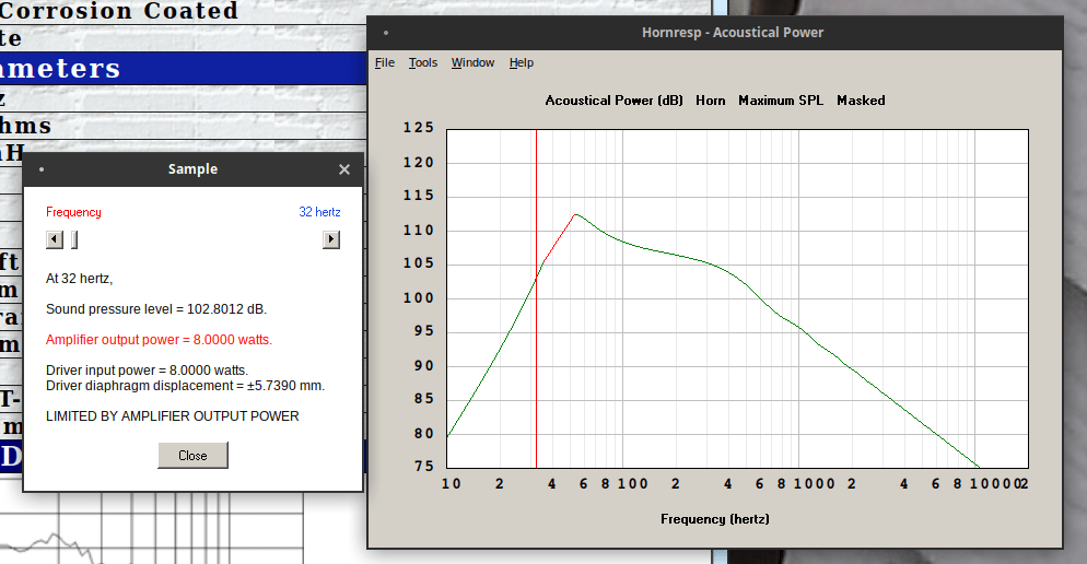

Here is an example. The Beyma 15WR400 The fs is 36Hz and the Qts is a very low 0.3 but though the rolloff starts well above 100Hz it is only down 11dB at 32Hz (Low C 16 foot rank). And the slope is only about 6dB/8va between 32Hz and 64Hz so even if room gain is only 6dB/8va you would be essentially flat once you hit that first room mode. If you wanted to tweak it a little to make the slope a little more linear and lifted up a little below 41Hz a 1200uF cap could do the trick. As a bonus the cap would provide a little bit of protection if someone hooked it to a big momma solid state amp and cranked it. Any way you slice it you will need a sub for the last 8va below 32Hz. Seems like an acceptable compromise. If you did have a big room and a more powerful amp you still have some room for EQ.
Using my current KT-88 SEUL of about 8W/Ch you could get max 103dB at 32Hz without any room gain assuming the OPT is up to it.

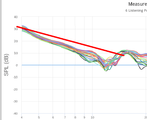

Yes and no. The 4 subs at the front wall are positioned within about 5-10 mm as ideal for a DBA versus width and height. The 4 sub at the back wall are positioned ideal versus width but about 5 cm off versus height, due to practical reasons. Subs at front wall are 18”, at the back wall less efficient / lower pump volume 15”. But the diagrams does not show a ”real DBA”, -as there is no EQ applied like 20 ms time delayed back wall subs, nor any correction for the efficiency differences between front and back. If that had been applied, the 40 Hz bump / dip would have evened out and also some less wiggles at other bass frequencies.
What can be taken from comparison between simulated and the in room response curves, is that room gain plays a role and that pressure gain (for me) starts to kick in a few Hz below 20 Hz and for pressure gain it doesn’t matter if subs are playing in phase or not.
But looking a response simulations the difference in -10dB points is not as great and I suspect that the -10dB point is really the more pertinent figure especially when room gain is taken into account. But on top of that many times the low Q drivers tend to have lower fs which further mitigates the issue.

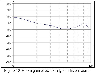

As you suspected: I am quite certain my room would have been a bass boomy nightmare if I had chosen the ”typical” Qtc of 0,707 when I built my subs. All 6 surfaces are thick concrete, half below ground level, with small windows and solid wood and steel doors. Also as my room is well sealed, it should have an even stronger augmentation than what is shown in the Fig 12 for a typical listening room in America. (Results in the link in post #2.)
A paper by John Krevskosvsky very well worth reading: http://www.geocities.ws/kreskovs/Box-Q.html . The paper was one of the reasons why I chose to build subs with such a low Qtc as 0,36, F3 around 118 Hz and with Fb around 48 Hz, well above the lowest room mode. (Theoretically 21,8 Hz, versus length 7,86 m)
Some excerpt from it:
”However, if a sealed box woofer system is placed in a relatively small, closed room, with room gain as depicted in Figure 12, the response below the fundamental room resonance will be augmented by room gain. If the room was perfectly sealed and the walls were perfectly rigid, the room gain would results in a 12dB/octave increase in SPL with decreasing frequency below the room’s fundamental resonance. Coupled with a speaker of correct resonance and Q the resulting response would extend flat well below the speaker’s and room’s resonant frequency. However, if the speaker’s resonance is below that of the rooms, then room gain effects can result in a blotted, boomy bass response. A low Q woofer system will help reduce this effect because of the greater roll off of the bass response from the woofer above it’s resonance. There is clearly a need to consider the room size, woofer resonance and woofer Q when trying to achieve the smoothest, most extended bass response in a given room rather than building/buying a woofer simply because it has the lowest fs. If fs is well below the room resonance the room will be overloaded and the bass will almost certainly boom.”
Plus: ”In summary, when you hear a speaker that sounds boomy but is otherwise well designed it is more likely not so much due to the overhang in the step response of the system. Rather it is because the particular woofer alignment (fs and Q) does not interact well with the local environment.”
