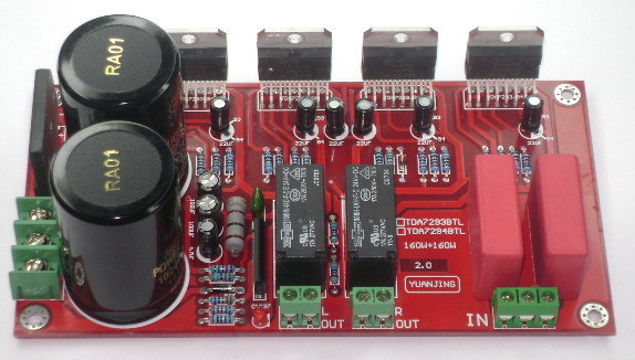

hello
is there a difference between them
besides 2 x and 4 x tda7294 tda
yes, they are very different.
The red PCB is a pair of bridged channels and can only be used with 8ohm speakers.
The blue PCB is a pair of channels and can be used with 4ohm, or 6ohm, or 8ohm, or 4 to 8ohm speakers.
The Blue has UPC protection chip.
The blue has opamp input !

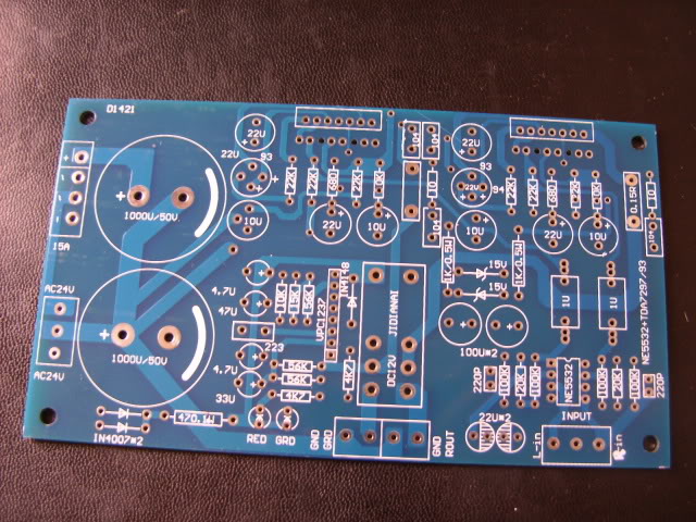

I see NE5532 on the PCB.
It can't be a DC servo, it's the wrong opamp for that.
It must be some input opamp.

I want to make a PCB for my TDA7293 IC pair so
help by Posting the poto of other side of the 2X PCB
Thanks !
Thanks !
svsommer
Thanks !
try this design TDA7293V
Sorry I dond have any PCB designs as your requirement right now. If I can manage to get that, I will definitely post it for you.DEAR diptangshu !
THANKS BUT I WANT PCB WITH SPEAKER PROTECTOR.
I THINK THIS IS BEST PCB.
