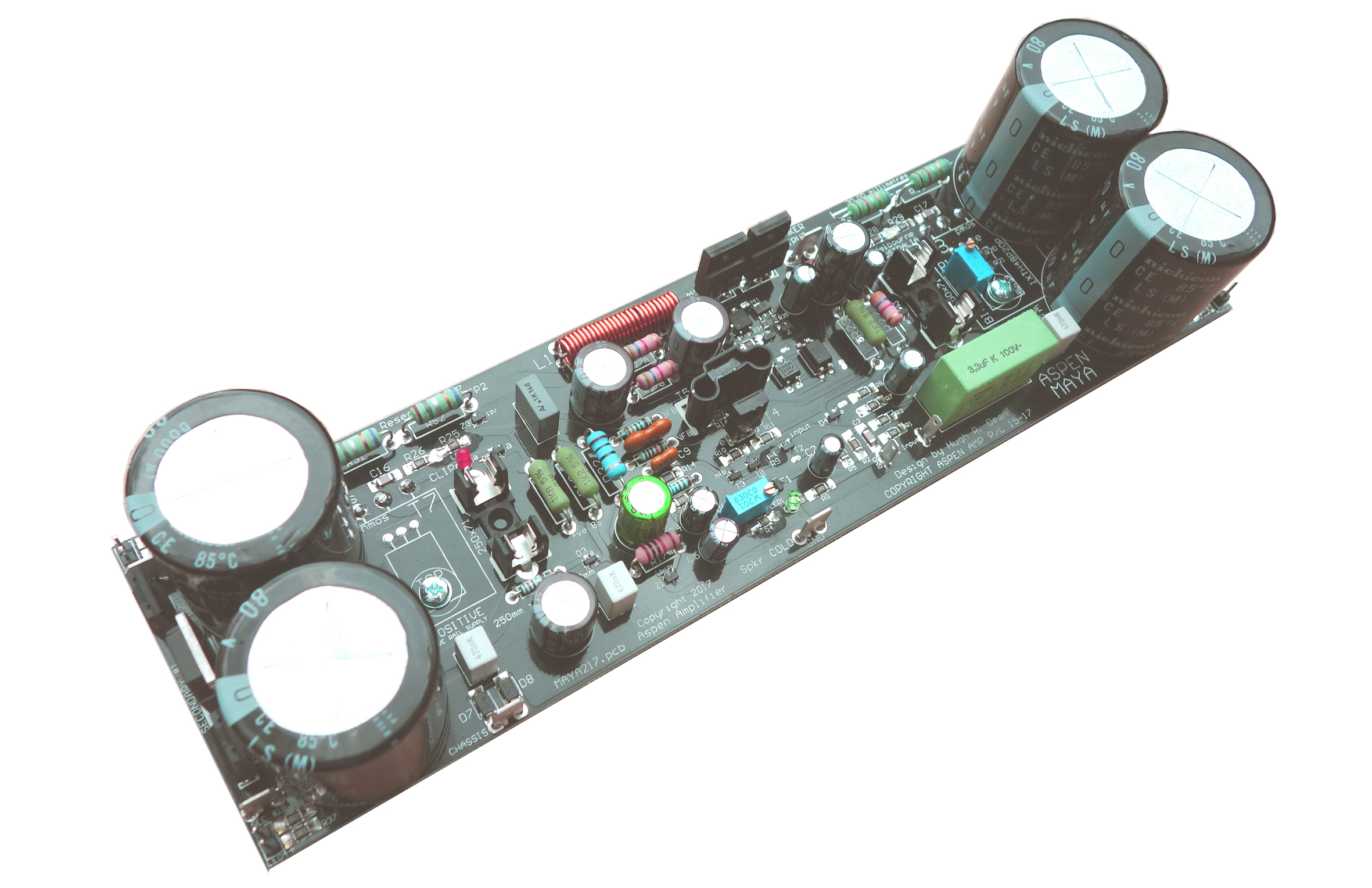

Congratulations on completing your build.

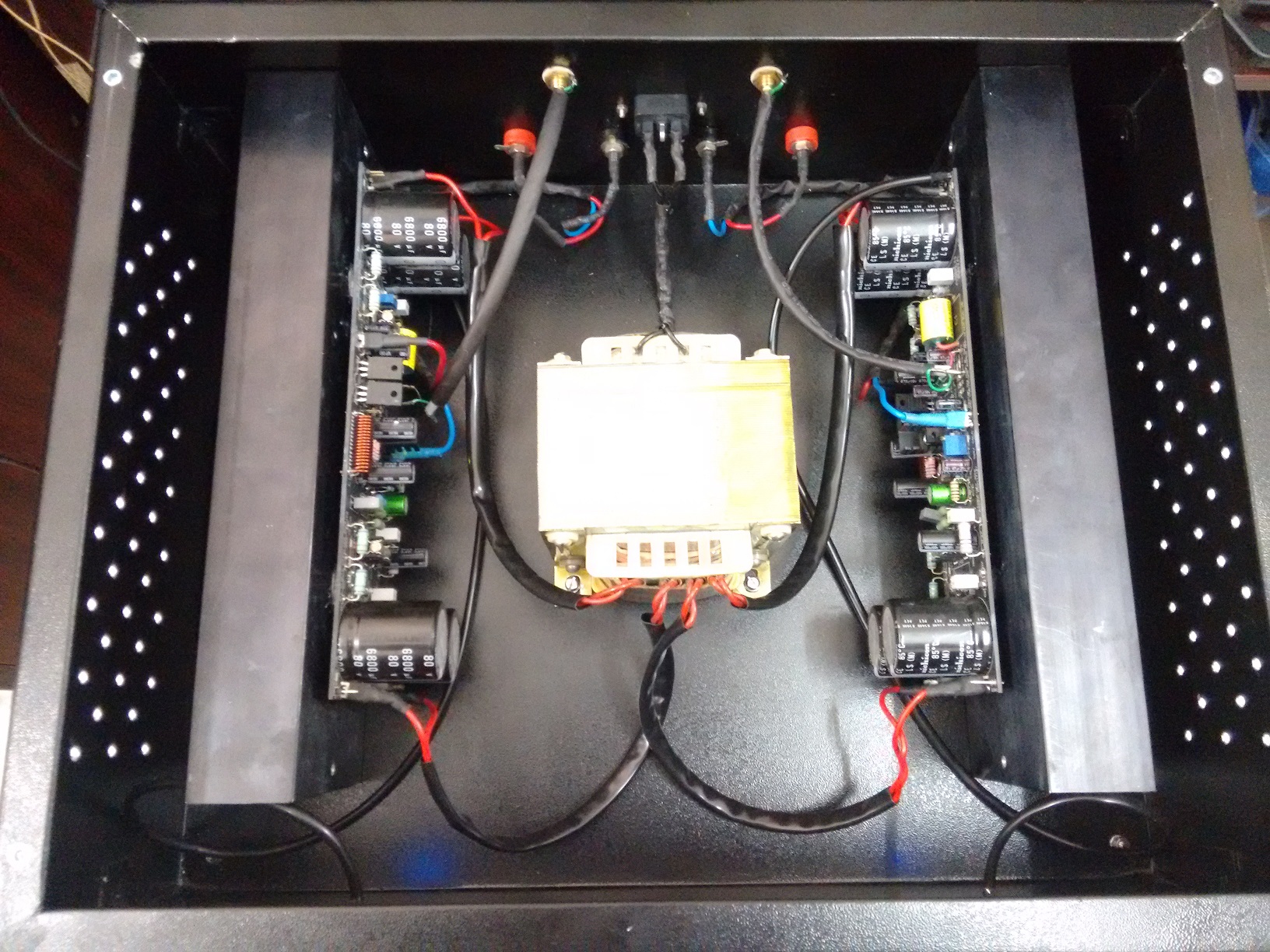

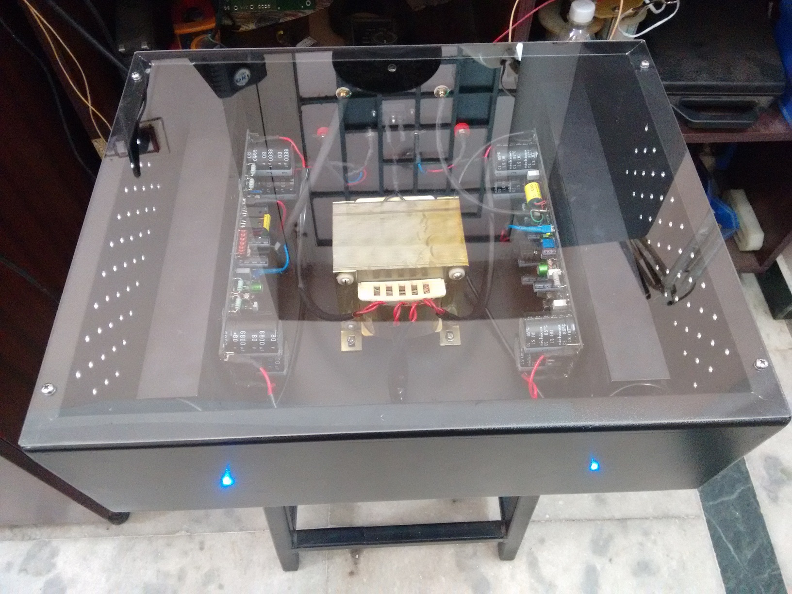

Great job on the DIY case - from the pics I cannot see any joining marks, and the corners look nice and tight. Maybe a a bit OT, but what did you use as an etch primer for the aluminum before powder coating?
The Maya PCBs look beautiful. Have you put them facing upwards so that they can be viewed through the see through top plate? 🙂
Hi Raj,
Very nice case with lots of ventilation and lovely Perspex case, WOW!
We have talked about the horizontal heatsinks, Steve mentions it too, but if it is not getting hot all is well in a domestic audio system.
To constrain the AC emissions and wiring I'd suggest you twist the secondaries - and the primary - and enclose in heatshrink. Twisted wires hugely reduce AC emission and all your red wires are running AC current.
Your case is elegant. I wish I could have access to good metalskill at moderate price. Australia is so expensive now, arguably one of the most expensive countries in the world.
Thank you for showing your Maya, Raj, I hope it gives you huge pleasure for many years.

Thanks Zman01 . Thanks for Hugh and Steve for your suggestions on heat sink placement. i didn't got it when hugh said earlier but now steve's comment made me to think twice . i will do all modification suggested and post the final one. i can gaurantee good metalskill at moderate price but what about the shipping cost to australia?
after maya purchase Narendran met me yesterday . we are going to have listening sessions this week . will let you know his feedback as well.
As per suggestions here is the assembly with wires twisted and on sleeve, heatsink reoriented .

Thank you Raj,
You did a great job; this looks a professional, beautifully built stereo amplifier and it will be cooled a little better too. The only issue with the fins is that are not vertical, but exposed as they are horizontal it will never get too hot.
I hope my suggestion did not offend; but I love all wires twisted and clothed!
