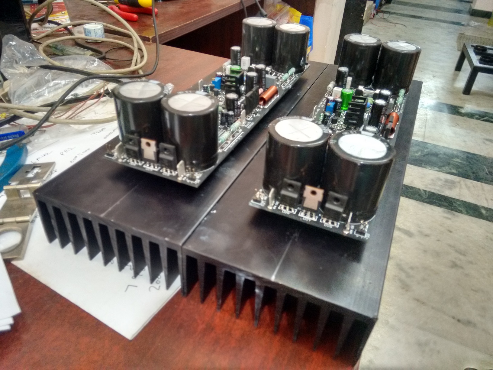

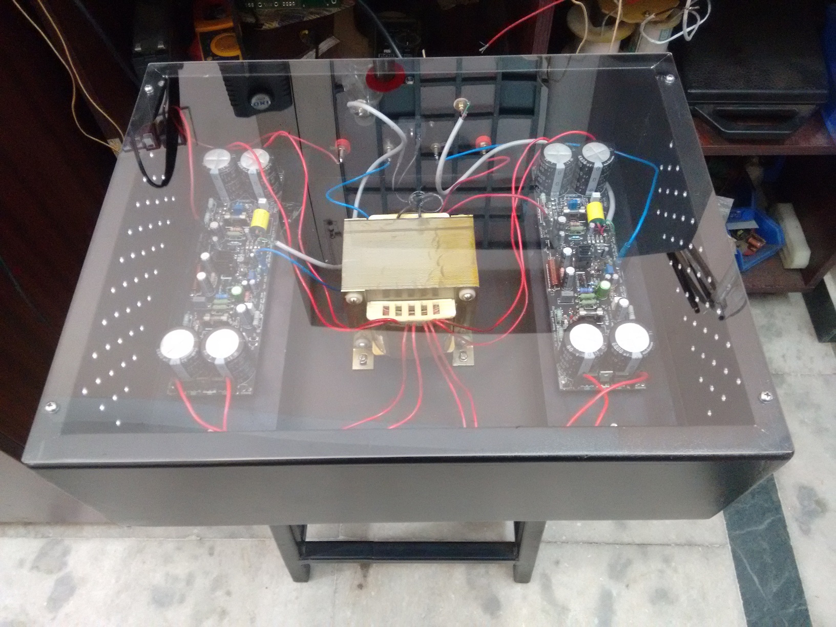

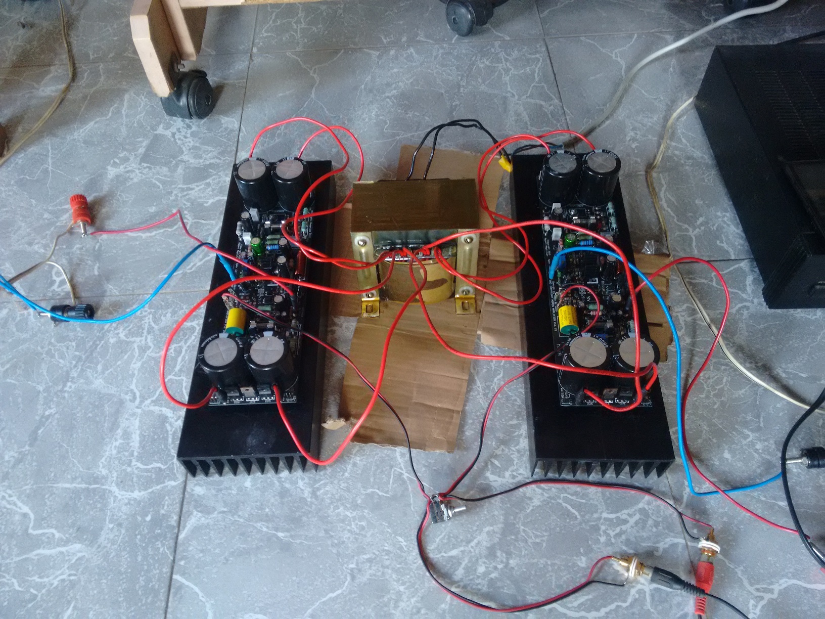

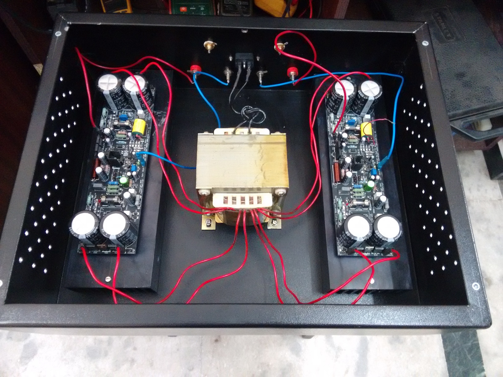

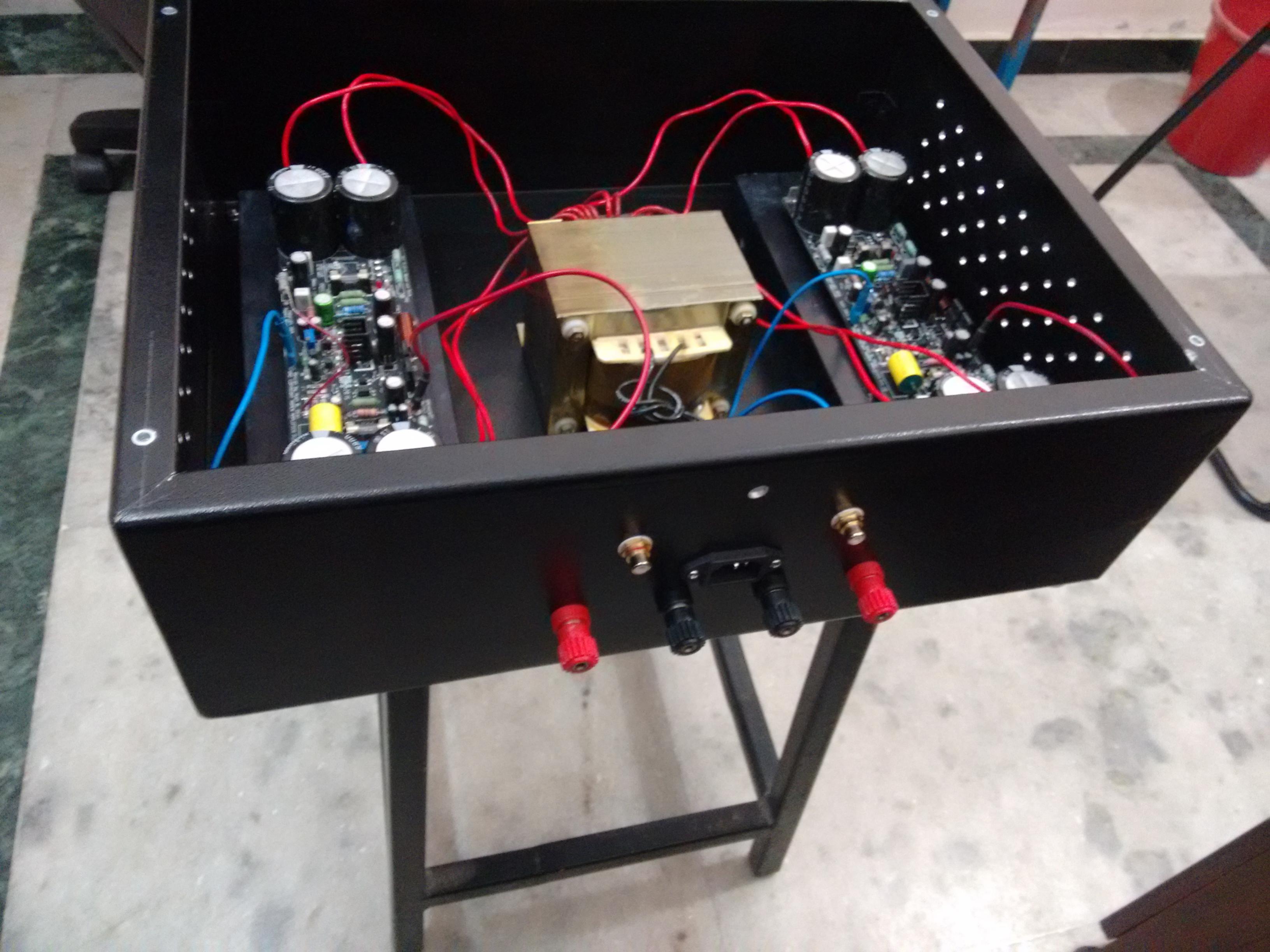

Attempting my first DIY cabinet . aluminium 3mm sheet folded on 4 sides and black powder coated . planning the top cover with glass or polycarbonate . not yet prepared the aluminium face plate . in spite of my tight work schedule i am forced to do the cabinet since my son broke one input pin while playing (by pulling the input wire from the table) will post once all work is completed .

This is very nice metalwork, and I love the transformer. I have found over many years that a good EI with a large core sounds better than any other transformer; and if you can run the core at no higher than 1.4T, just under the magic 1.7T, you will never have hum.

Very nice case work, I'm very impressed with the quality of the work and the finish. BTW, the thermal issues, particularly the heatsink orientation, are they sufficient?

this is the only heatsink available here for the pcb size and i think it is ok so for. at full volume for 1 hour i am barely able to touch the heat sink. also the heat from heat sink will get transfered to the case which is 3mm aluminium (may be contact area will be less). the heat sink dimension is 330*104*45 mm.
