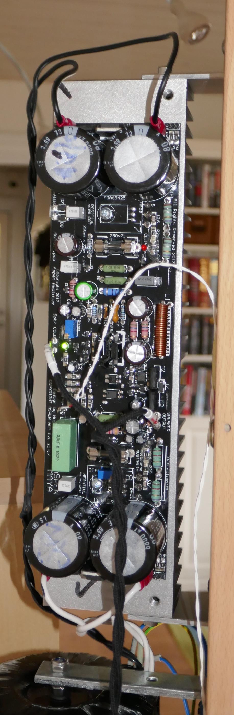

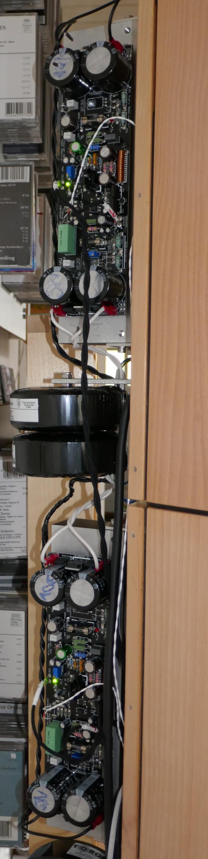

Mayas at work
Just a couple of photos of Mayas in operation 😉

my next project with the Maya,,,i shall have the Heatsink outside the cabinet...to hot inside...18" with low impedans give some heat...it take a little time to figure out , the best way to do that

Bjarne,
Sometimes to reduce heat, as with Jens' Maya, I have suggested lower voltage on the rails. He uses 40Vac secondaries, compared to your 45Vac. This does reduce his heat, but you are absolutely correct with putting the heatsinks outside the enclosure. If this still keeps it temperatures high, consider either more heatsinking, or pulling a few turns off the secondaries, to reduce the rails to 56V DC rather than the present 64V DC.
No issues to the amp itself; it's just that it's now running lower efficiency and a lot of heat on the sink rather than in the speaker drivers!

i will go for bigger heatsink,,not lower the volt,,,but to start i will see if the outside mount is enough
i have not the feeling the Maya have any problem to drive my 18",,sound deep and dynamic in the bass but heatsink inside is not the best here,,,

so ,i will think the best way is to get the heatsink big enough, to my cabinet i can mount
300* 4 * 165 mm heatsink 0,31 c/w will this be good ??
