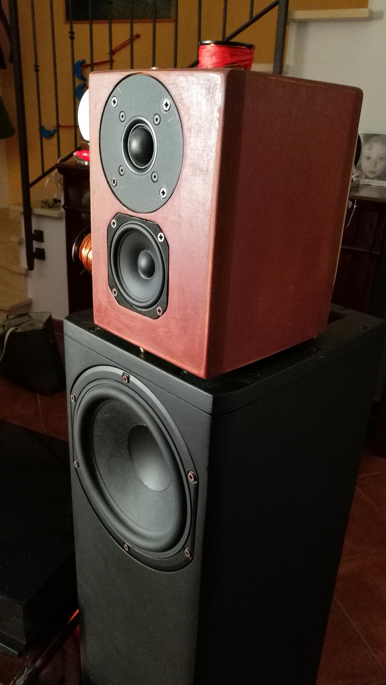

May my problem be diffraction?
Please, do you refer to this mounting solution?
Isn't it a flush mounting? I've always took for granted that this is the correct way to mount every driver..
What do you intend for same distance from 3 edges? Is that a better way to fight diffraction rather than different distance as I've made?
Yes, That's the picture I refer to.

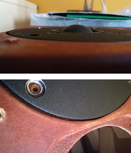

The tweeter baffle plate looks like it is not flush with the baffle, but a little bit too deep into the speaker. (if you put a straight edge across the speaker is there space between the edge and the tweeter baffle plate ?)
If that is the case you can place a couple of 'cereal box cardboard' gaskets behind the tweeter to bring it up flush with the speaker baffle. The cutout for the tweeter is a bit large so some sort of putty could fill the gap to smooth any discontinuities.
I meant the distance from the tweeter to each edge was quite similar to each other, concentrating the diffraction issues into a narrower frequency band. I would make the differences larger to spread out the effect. (and make the cabinet edges have much larger roundovers)
Before changing out all your plans try your tweeter in a large baffle to see if that eliminates your problems. Also try setting up the speakers for flat response outside away from walls and then place indoors. They will no longer measure flat in room but should sound a lot warmer and natural.

Tweeter is really flushed, indeed cutout is rather larger than faceplate so there's quite 1 mm of distance all around..
Unfortunately my wood working skills aren't perfect (it's a miracle I succeded in forming Vifa DC9 cutout..!).

In that case I apologise, the original picture looked recessed to me but must be due to the shadow of the gap / angle of the camera.

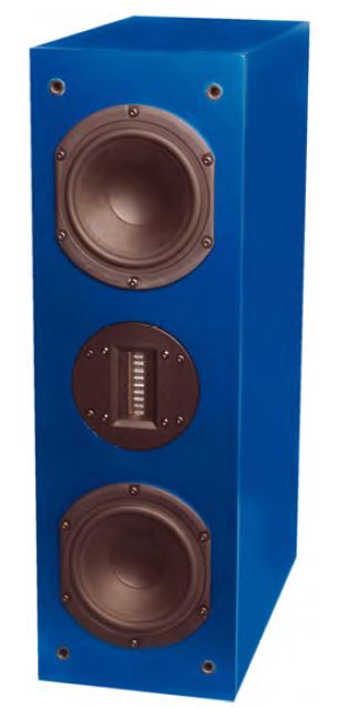

This whole business of sibilance from dome tweeters has fascinated me.
I think we have made some progress with simple questions.
Certainly the disjoint between dispersion from small HF drivers and woofers has dogged our efforts for years:

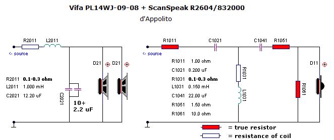

635014d1505220144-home-theater-speakers-vifa-pl14wj-dappolito-mtm-jpg
635015d1505220144-home-theater-speakers-troels-vifa-pl14wj-09-08-dappolito-jpg

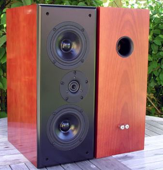

A decent Troels Gravesen design.
Better is this sort of thing, IMO. Just has more symettry, IMO. And symettry is everything in our Universe:
733281d1549059344-speakers-parallel-serial-wagner-net-au-kit-260-5-inch-mtm-jpg

Hello Steven! If I don't go wrong, from what I've last learnt, D'Appolito configuration should unify advanteges rolloff and flat power response of BW3 with a vertical polar response without lobing coming from temporal disalignment of this topology, am I right? Of course, genial, despite the expense of a double bass driver.

This is what I still misunderstand at all... Why some famous and brand project uses a symmetrically positioned tweeter when it's almost a certainty that asymmetrical position reduces diffraction problems??
You don't know till you build something whether it wins a cigar really. 😱

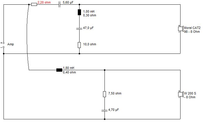

Easy as anything IMO. Just an LCR for the Fs and a single capacitor. Michael Chua will send you a circuit for the speaker:
Finch (Morel CAT378 + Vifa PL18W0-09-08) – AmpsLab

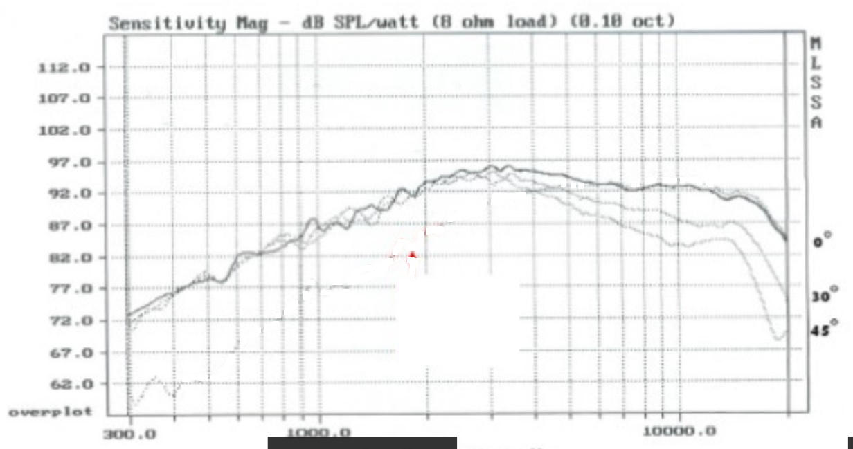

On the cat378, if you subtract the on axis response, you are 8db down 10khz vs 3khz 30 degrees off axis.
The dispersion may be like an 8" full range driver.
Think 1 pair of ears at 7', 2 people (maybe 3) at 12'.
But on axis with the 5.6uf cap, it is 6db down at 2khz, 12db down at 1khz, no kufuffle where its Fs is, and deeper than a surface dome.
So you can do 6db time alignment / phase alignment if that is what rocks your boat.
And it can take 80 watt receiver (crossed at 200hz).

But abandon not all Faith. We can get this working. Me, I might try about 3.9uF cap here, given we are attenuating the output. Just how it works.
