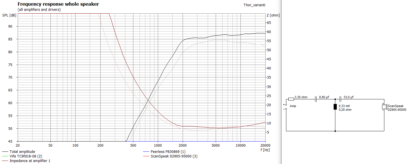

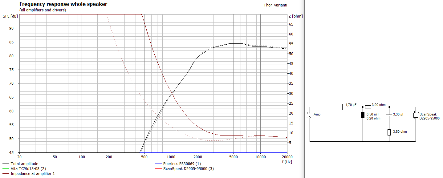

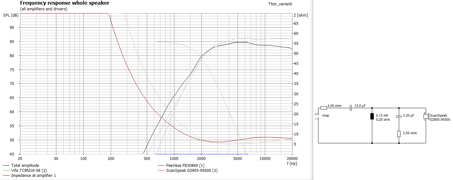

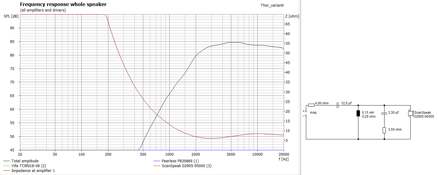

I dug up some power response simulations aka energy frequency response in Boxsim:
3/4" tweeter:
685152d1528226024-linton-2-upgrade-monitor-audio-r300-md-seas-19taf-tweeter-jpg
599664d1487267698-restoring-monitor-audio-r300-bookshelf-speakers-monitor-audio-r300-md-fr-png
2" cone tweeter:
685153d1528226024-linton-2-upgrade-monitor-audio-monacor-ht-22-cone-tweeter-jpg
685155d1528226024-linton-2-upgrade-system7-darkness-speaker-fr-png
The simulator uses the size of the radiating area (Sd) to work this out. It also allows for the box edges which often produce big ripples around 3-5 kHz. There is an exagerrated power at bass frequencies due to box bafflestep too.
Very good example of Power response not being the same as frequency response. In the first example the power response dips around x-o, and then peaks octave above. With LR2 the dip is wider and gentler, and peak is smaller in magnitude comparing to LR4.

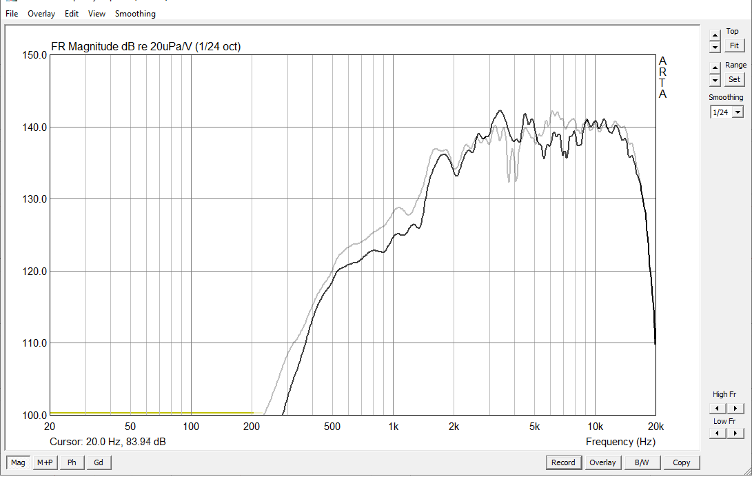

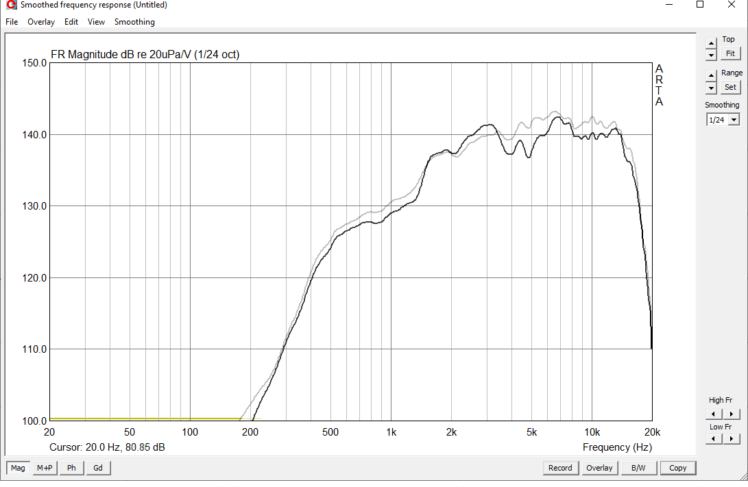

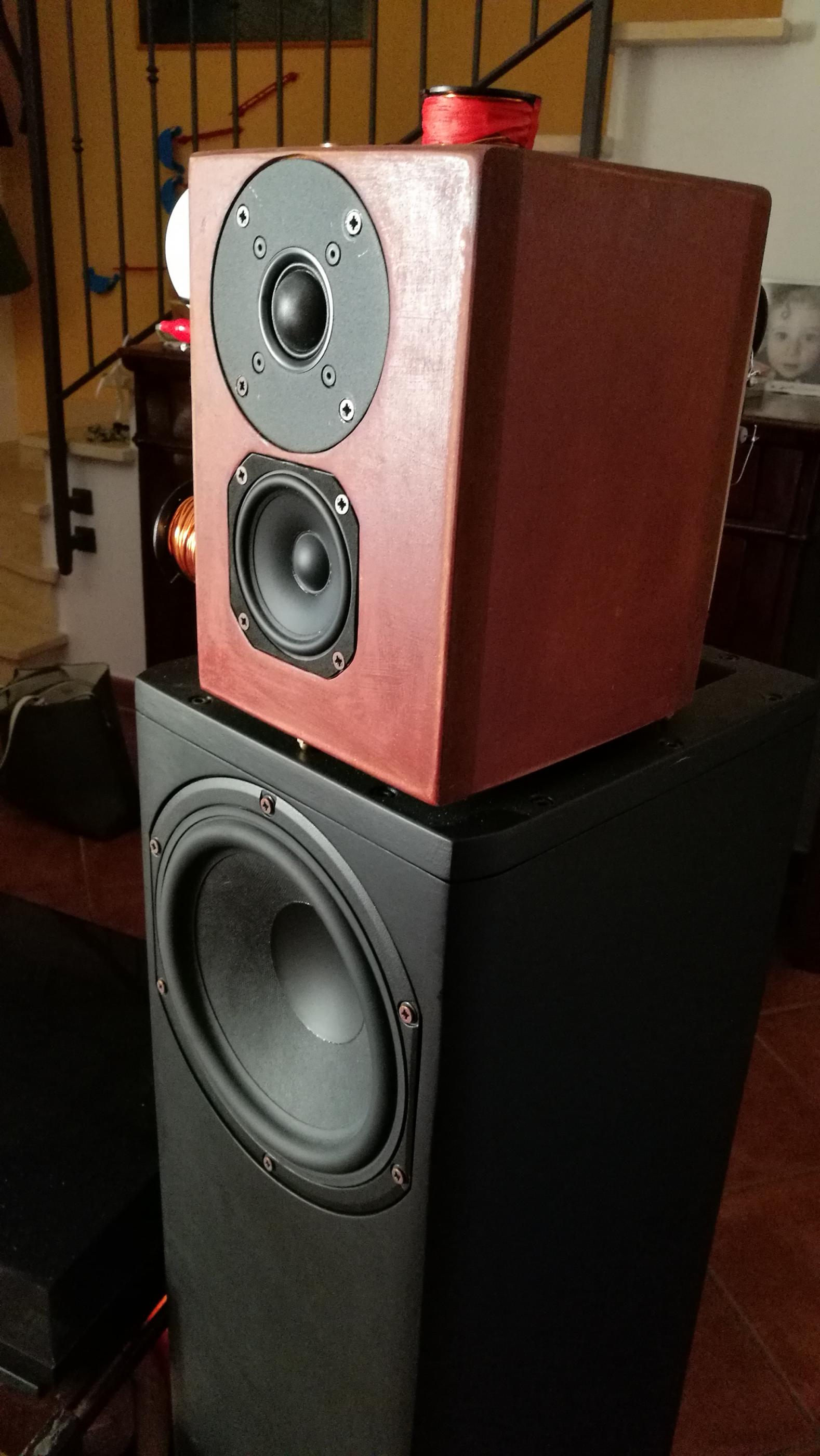

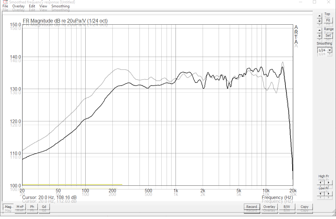

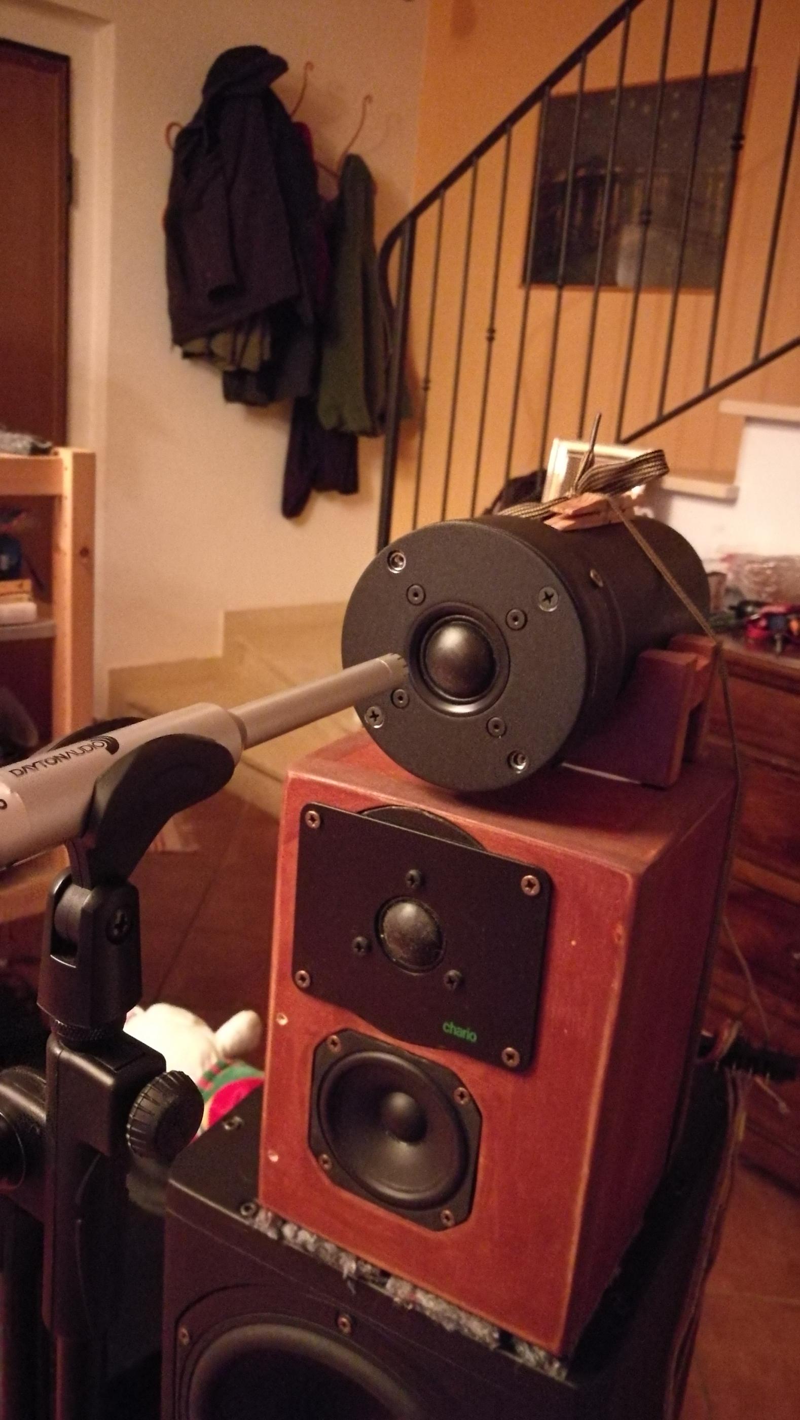

Hello, I'm here, my proposal was to be not until I've made some measurements about waveguide and baffle relationship. All measurement was made using the same driver unit ScanSpeak D2905-9500, 1 volt rms MLS dual channel gated method in ARTA, graphs dB scale forced to 90 dB average, 10 uF cap in series with driver, baffle made with the largest shoes-box I've found among my wife's ones..!
Let's begin with SS on baffle:
Here's the response at 100 cm (black trace) overlayed 5 cm one (grey trace):
It's possible to see that with a quite good dimensions baffle like this there's not any particular problem but the 1,8 khz dip, so I understand that my previous baffle gave me horrible problems due to its dimension and quite certainly due to the slot between the highs box and the woofer box, that may explain that strange behaviour with two very near and deep dips around 3 khz);
SS on baffle through waveguide:
Certainly that represents a better situation than prevoius one because there's not its 1,8 khz dip, which ensures that waveguide leads less interactions between driver and baffle. I can imagine that here the difference due to diffraction is however not impressive because of the baffle quality, maybe with a worse baffle there would be major differences.
What impressed me is however the enormous gain that waveguide leaded to onaxis response, with a max of 6 db at 3khz while we can see a loss of about 3 db at the highest frequency around 15 khz. From this I can imagine that off axis response could decrease rather heavily going away from axis.

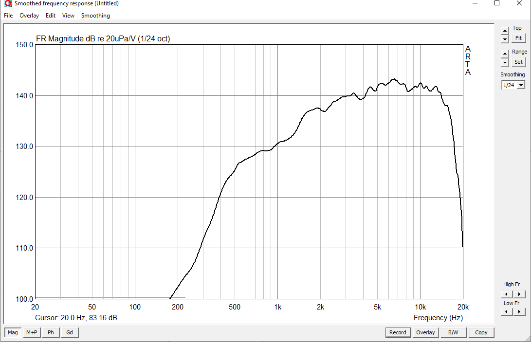

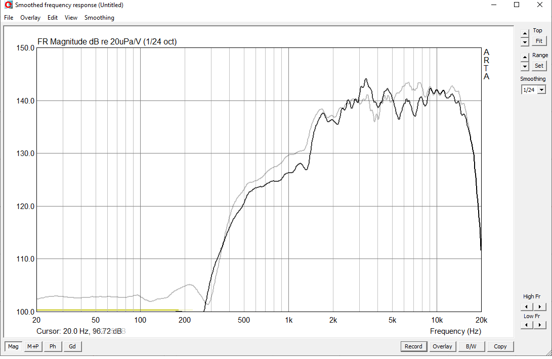

I've made also some trial without baffle because that situation keeps on fascinating me from aesthetic point of view.
SS without baffle:
SS without baffle but with waveguide:
Comparing SS plus waveguide with (black) and without (grey) baffle at100 cm:
Comparing SS without waveguide with (black) and without (grey) baffle at 100 cm:
Unfortunately (for me) these results seems not good at all because it seems that waveguide didn't help much response when there's not any baffle; evidently, even if waveguide narrows the emission's solid angle, the missing of baffle makes itself feel with big strenght.

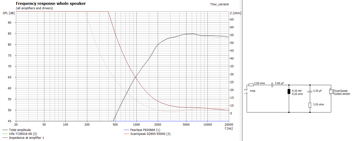

I just had a look in Boxsim Simulator at what happens with 104mm baffles, like a bare tweeter. Its inhuman brain seems to know what it is doing... :worship:
Seemed the bafflestep point moved up to about 1.5kHz. Which is what you get.
But this sibilance or harshness issue with tweeters is mainly happening higher up IMO. And I still think the Morel CAT378 might be good.

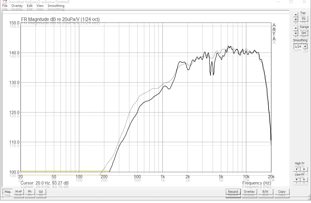

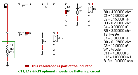

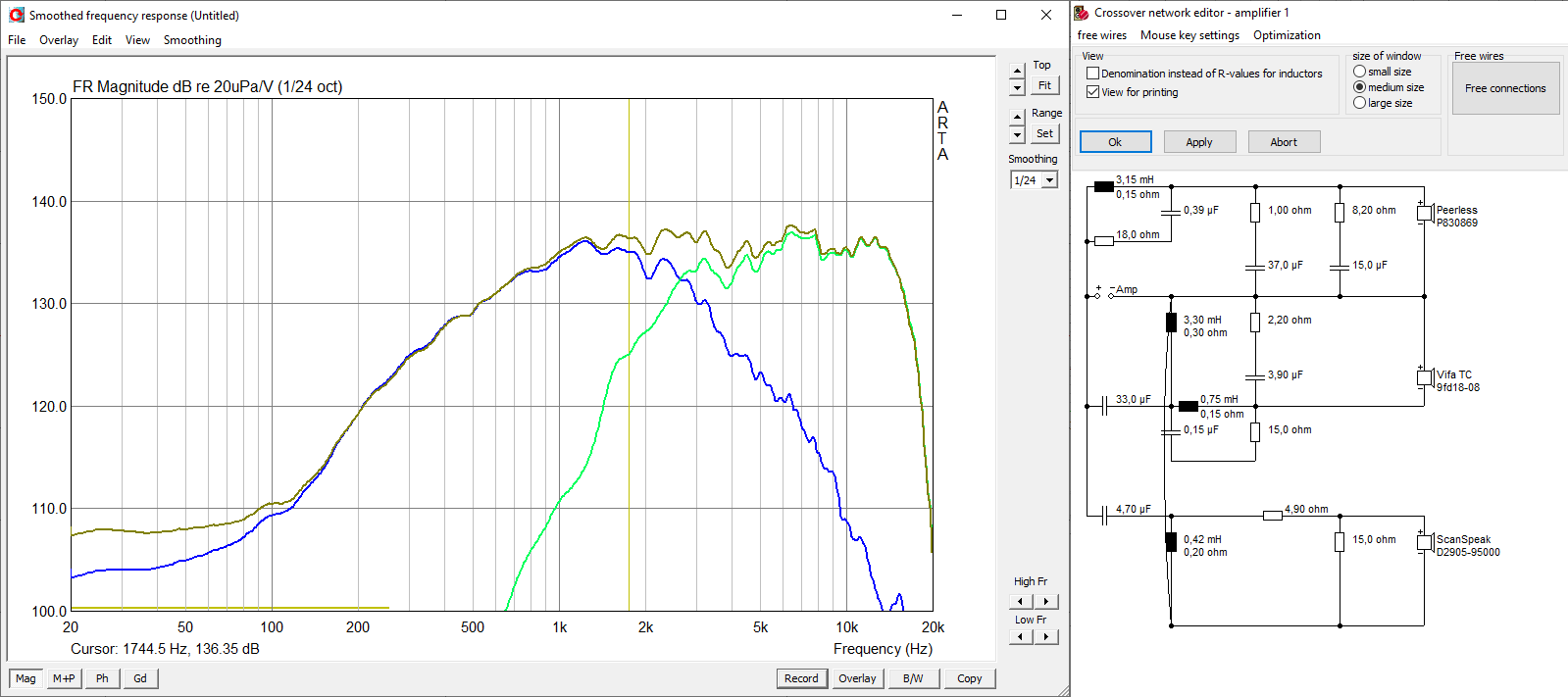

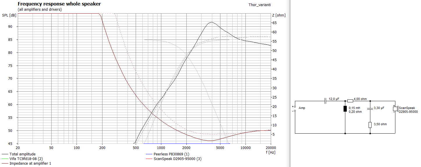

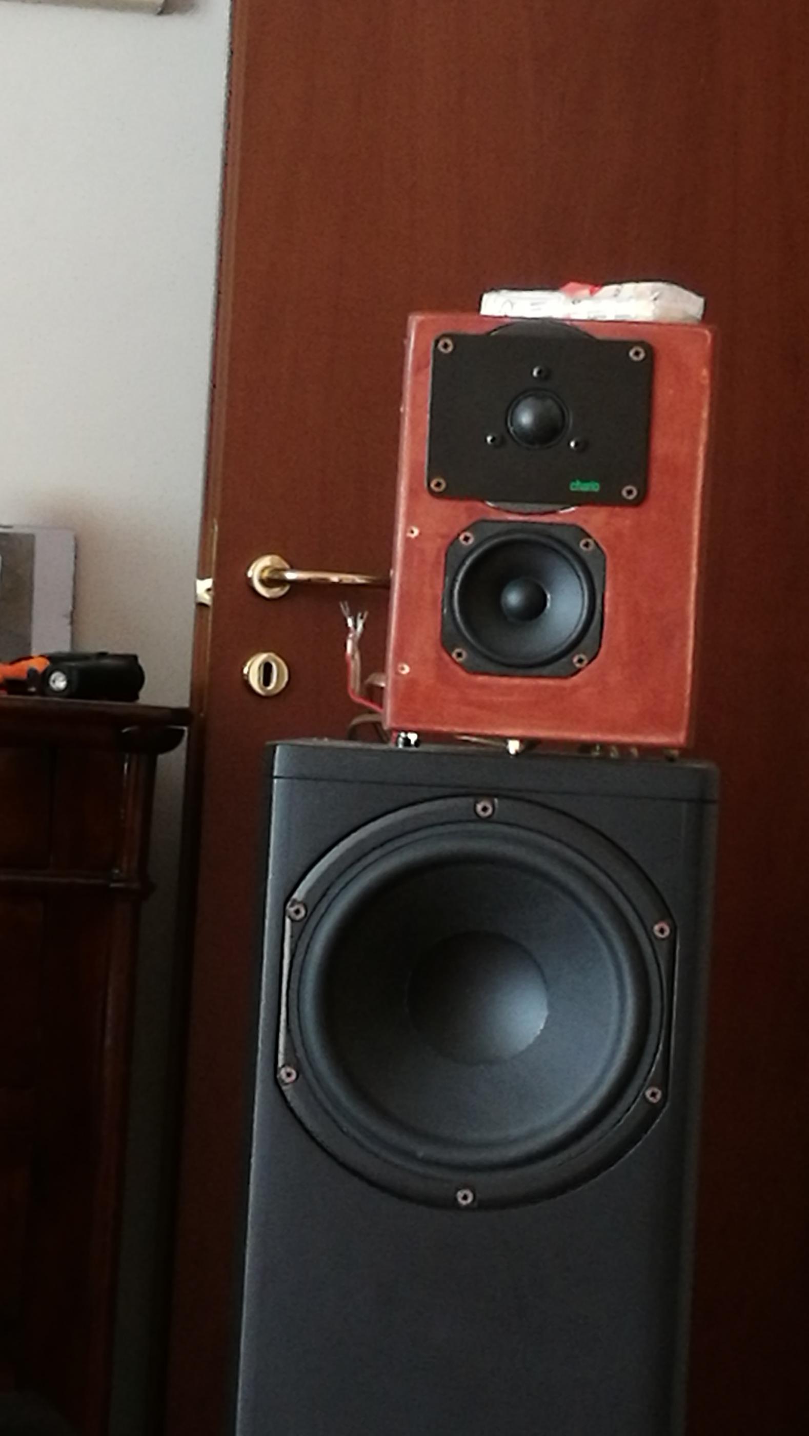

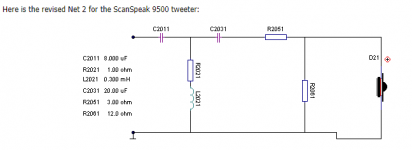

Hello, finally I think to have found the response to my answer about diffraction as possible source of my sybilance and harshness problem.
Diffraction creates a lot of problem and irregularities in response and we have seen it clearly in measurements, every of each was however useful for me to learn using instruments for designing and verifying a loudspeaker, for which reason I'm now happy to have spent time and money. But I think my problem is not diffraction, and we'll see why.

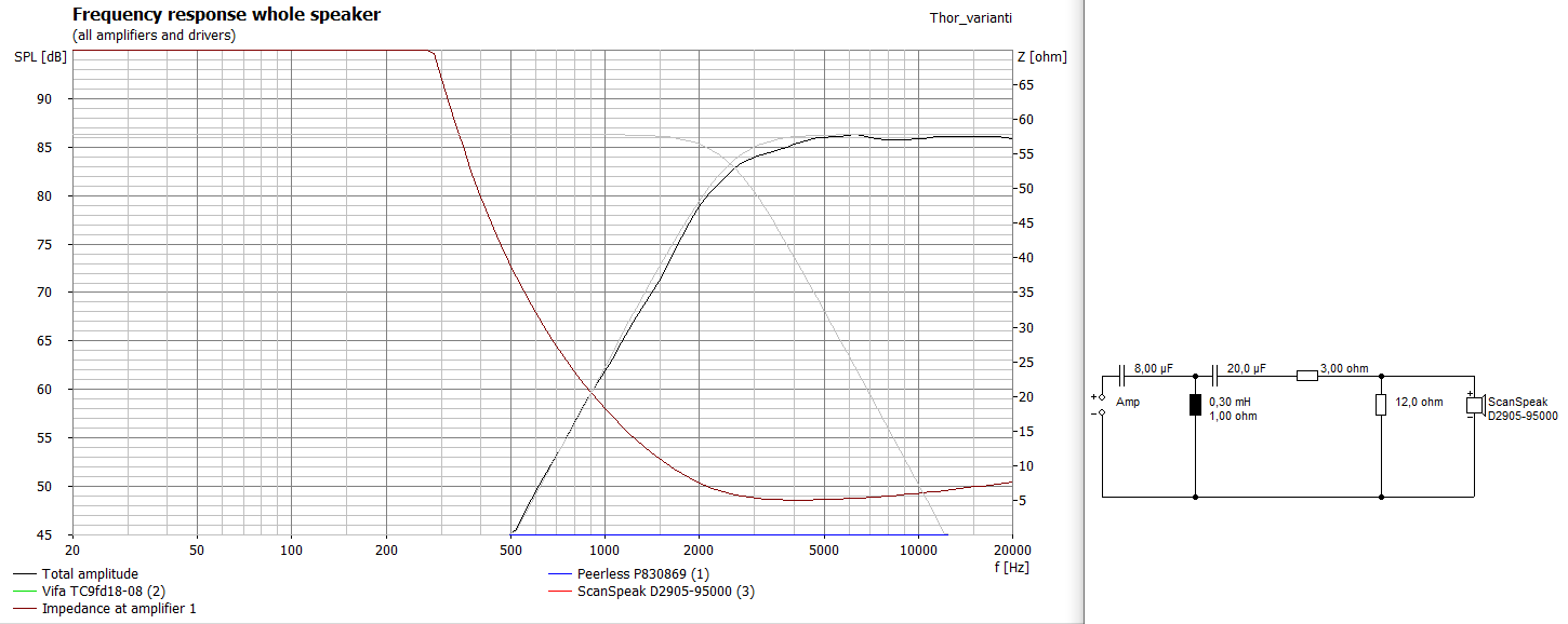

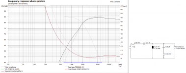

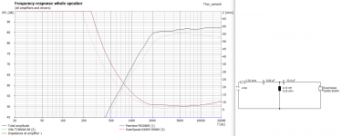

This is the result of the last step of my project:
in this project I've learnt to measure drivers already mounted on baffle, simulating them with crossover and measure them again to verify results:
simulation
time aligned measured response
Not bad!
I can see it overalying this response with a reference brand loudspeaker's one:
(blue line my project, green line reference loudspeaker)

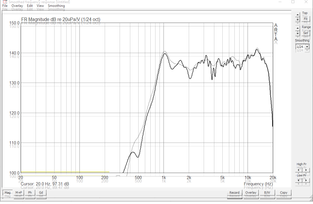

But coming to listening, STILL REALLY BAD! Putting on my preferred Pearl Jam's "Elderly woman", ssssss are still in evidence and unpleasant, while this not happens sounding the same song from reference speaker, even if its 5-8 khz response is higher than mine. Not useful at all lowering high regions through digital spline equalizer.
Trying not to cry, looked for other measurement types in ARTA: distortion is quite regular, not bad; but what strongly struck me was Cumulative Spectral Decay, from which I think to have found explanation.
This is CSD of my reference speaker:
while this is CSD of my project:
It's clear that there's a strange tweeter behaviour at 5 khz, just the sybilance frequency!
Let's see single driver's CSD, filtered and baffled on cabinet as they are in final speaker:
woofer
and... TWEETER!!
What a disaster!! Tweeter rings like a bell at certain frequencies!
So the question arises spontaneously: may my tweeter be damaged? May ferrofluid oil dried out? In this last case, is there a method to refill oil? Can I say now that my problem is not diffraction but a not properly working tweeter?
What I didn't understand at all is why tweeter works more badly if alone and less badly if together with woofer, even if filtered with the exactly same crossover?
Thank you.
Play with the starting point in the gated measurement to get similar frequency response in the CSD top curve as the measured axis frequency response.
