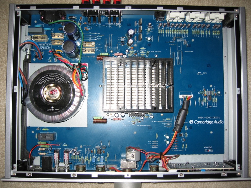

Gino what amp do you have ?.
Can you post internal pics ?.
Dan.
Hi Dan !
i am using one of these ... Cambridge Audio 340a
![15404d1335552317-innmat-hva-du-vil-340a.jpg](https://www.hifisentralen.no/forumet/attachments/hi-fi-generelt/15404d1335552317-innmat-hva-du-vil-340a.jpg)
honestly i am liking the sound quite a lot. Really.
I would like only a little more "rounded" sound. When pushed it becomes harsh and hard on voices particularly.
But i am surprised by the sound quality. It is one of the cheapest around here.
Regards, gino
P.S. now that i look better i think that two 15-20mF caps can be fitted in the PS at the place of the existing one ?
I would be tempted to fit a larger size same voltage toroidal transformer, there seems to be space. I can not see how that can fail. The capacitors later. If you do the other thing sometimes it can sound worse.

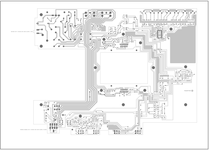

Cambridge-Azur-340A-int-sm.pdf
![Cambridge 01.png Cambridge 01.png](https://www.diyaudio.com/community/data/attachments/425/425977-3d6e3f9bf2ffad015c5b9d77ee5580cc.jpg)
Ok, looking at the pcb layout it's a mess, not dissing your choice in hifi.
What you have is an amp that should be ok generally, but has limited output, and expect it to get messy at higher levels.
Pretty hard to decide where to start...seriously.
Good amp performance depends on good earthing techniques...this pcb has hopelessly long earth traces with multiple components connected to the same earth line.
This all adds up to IMD, and is a cause of the harshness that you are experiencing.
Do you have a soldering iron...if so, there are plenty of kits available that will give you much better sound.
Dan.
That would probably be coming from SPiKe protection being
enabled. It severely distorts the signal and that can't be pleasing
at all.
