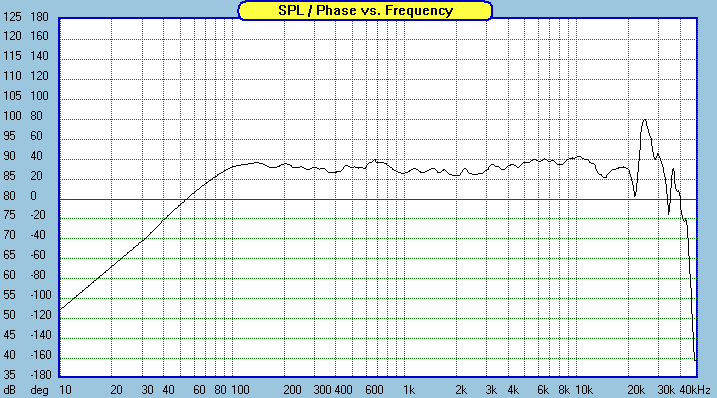

FIY Zaph Audio measured the passive version of those speakers :
zaph|audio
Search b2031p in the page.
Hi i am not an expert .. but this looks impressive indeed

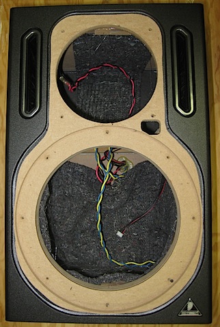

1 - just put your face into the woofer hole and make all the dumbest sounds you can think of in order to excite/find internal resonances.
2 - ensure that nobody hears you doing this.
Speaker cabinet internal damping is everything.Regarding the cabinet, as i said, i am impressed by the construction also of the stock version. The internal bracing looks particularly well executed.
I will try the new and very interesting damping material not only with this speaker. 😉
Thanks a lot again, gino 🙂
Internal reflections cause resonant peaks, and also delayed sound to retransmit through the woofer cone.
Both of these faults conspire to cause distortions, and obscuring of depth information.
Most production speakers can be much improved by optimising internal damping.
Dan.

Now i reread carefully the damping process description
Kind regards, gino
The point is to excite the box with vocal range sounds....ie, find the box nasties in the (critical) vocal range.Hi ! ah ... now i see. I have to speak in the hole 😉
Interesting ... I have really to try. Original test indeed 🙂
They talk BS....lots of BS.You should not say this to the Audio Note speakers designers ... they say that the cabinet must resonate with sounds
Yes and no....a little bit of the 'right' colouration can add excitement, for critical monitoring little or nothing should be added or omitted.But I agree with you ... a speaker is not a musical instrument
It should add nothing to the original signal
The photos will explain better, but you should get the gist from my explanations.😉Take your time Dan ! we will wait
Yes please. It will be very interesting.
So i guess this picture refers to the original ? the damping material is the original ?
the speakers are currently at my parents' home in another country 😱
it will take some time to check them
thanks again
gino

The Behringers are no Ferrari's, that's absolutely true. The units are not first class either, that's a fact too.
BUT:
The electronics seem quite OK to me and the lack of damping inside the cabinets is easily fixed. Adding enough damping to the Behringers removes a lot (most) of the muddy sound improving reproduction of voices and soundstage dramatically.
Adding two little pieces of damping material to my B2030A's resulted in a land-slide change.
So, besides the units are not first class, their qualities are not fully exploited by the manufacturer... not by far!
