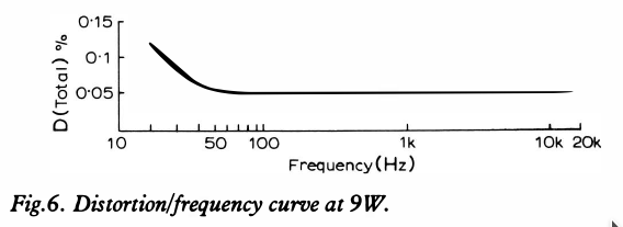

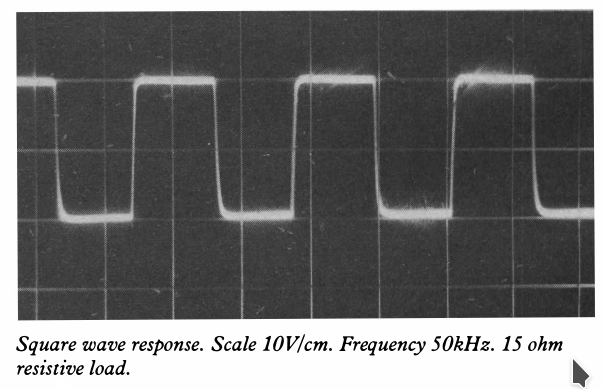

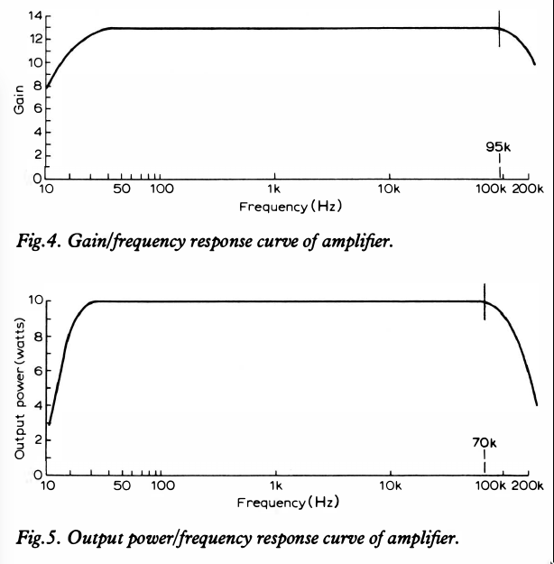

I think these posts are missing practicalities - what an entire amp needs to achieve for good distortion characteristics. As it's handy I chose JLH's class A. It's not just slew rate really in the terms that have been mentioned in posts.
Taking the TL072H distortion is low with a gain of 10, 1Vrms out and and an input impedance of 1k. Slew rate typ 20v/uSec. With a 40v supply. Bandwidth with a gain of 10 is similar to JLH's.
Higher spec amp's - bandwidth goes up.
Slew rate at 80kHz is 4 times that at 20kHz.
