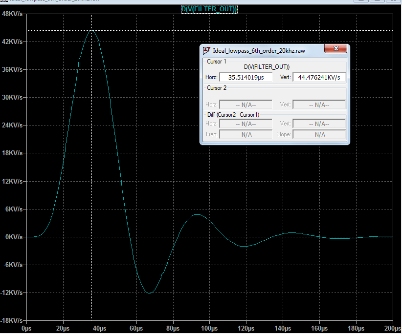

So, did a simple sym. A single pole RC lowpass with 20 kHz -3dB corner. Not close to a "brick wall". This is a reasonable worst case frequency roll off whether it be the ears or the program material. In reality there are many stacked poles in the 20 kHz region.
Results with a 10nS rising step to 1V gives 121mV/uS slew rate output.

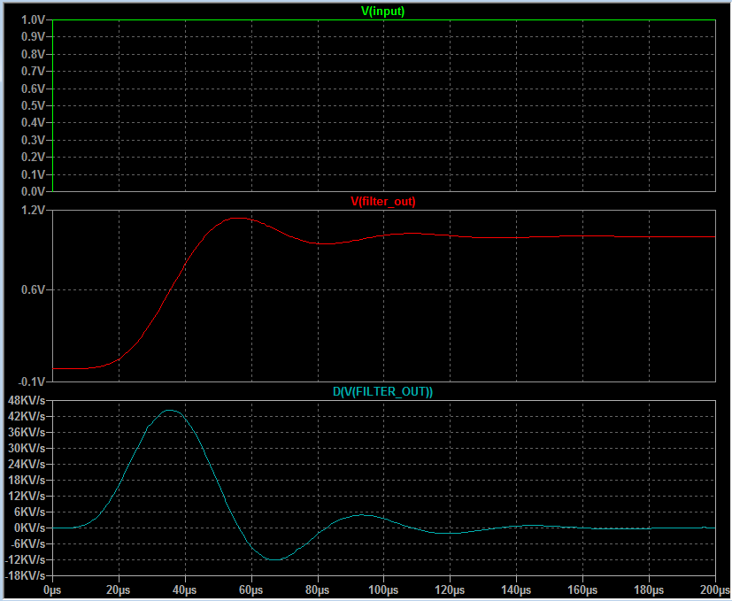

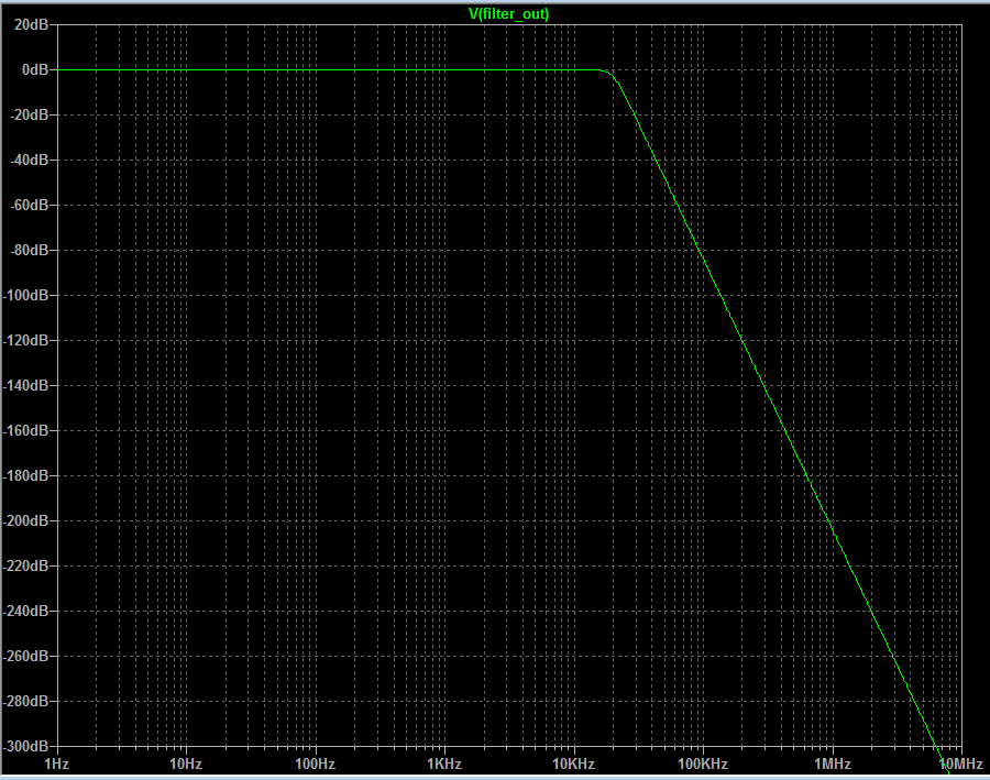

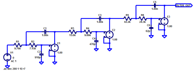

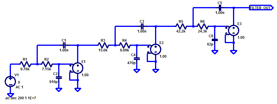

I repeated this experiment except I simulated a six pole Butterworth lowpass filter with a 20 kHz corner frequency. For simplicity of simulation I chose a Sallen-Key implementation, and I used ideal unity gain buffers (spice "E" devices) having infinite bandwidth and infinite input impedance.
As you can see, with a 1V step input, the six pole filter's step response hits a maximum slew rate of 44.5 volts per milllisecond , which equals 44.5 millivolts per microsecond, i.e. 0.0445 volts per microsecond. The Butterworth "maximally flat" criterion looks like it was met.
