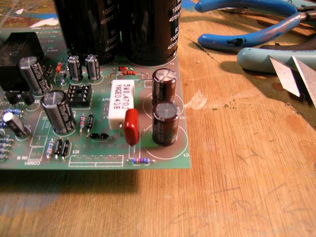

What you probably could do is place .1 ohm 3-5W resistor on the output of each channel on one board and use the board as a monobloc parallel mono amp. Then you would need two boards for a stereo amp of course. 🙂 I may just try that. 😀

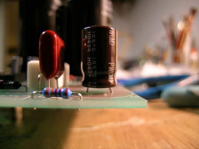

Oh, I wanted to mention that dispite the slight pin spacing issue with the lowESR caps, they do mount close enough to be secure (not all floppy). I might add a drop of hot glue under the edges just to be sure though.
Also, I found out Mouser had to backorder one cap ($0.18). I have some extras of those around though, so no big deal. They did inform me that it should ship by the end of August 🙂

BrianDonegan said:Oh, I wanted to mention that dispite the slight pin spacing issue with the lowESR caps, they do mount close enough to be secure (not all floppy). I might add a drop of hot glue under the edges just to be sure though.
Yeah, I have mounted 5mm caps in 7.5mm holes plenty of times. 🙂 Its never been a problem for me.
