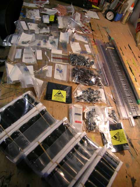

The DigiKey and Mouser portions of the parts arrived today. Still waiting on the heatsinks (no tracking) and a couple extras I will be including.
At last check we had 4 transformer orders on the Wiki. Any od those interested in the super-cheap parts express transformer mentioned above? I could include 2 for each kit.
