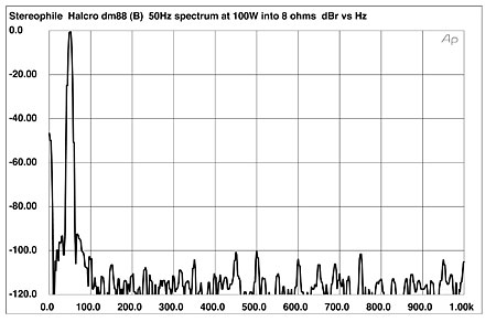

And here is the Halcro dm88 spectra at 50Hz, although in fairness it is not measured at the same power level as the JC-1.
regards
trev
Calling me a liar, Scott? I am not saying ANYTHING about what I once referred to. I am working with Michael Cotter, now. I will rely on his input as Matti apparently did, decades ago. We have seen PIM on the screen, and we now know that it can be measured effectively. Why it is so important sonically is now the REAL question. Scott, I have never knowingly lied on this or any other website. What would be the point? To be found out, in future? To sell some sort of gizmo? Please, be civil, and I will return the civility. You may not agree with me on what is IMPORTANT in audio design, that is understandable, but I am pretty darn successful, sonically, in my own right, especially when I avoid IC's if I can, and only use the 'best' when I can't.
100W Trevor, 100W, into 8 ohms. Measure the JC-1 at 100W too! What is wrong with you, can't you read a graph?

john curl said:100W Trevor, 100W, into 8 ohms. Measure the JC-1 at 100W too! What is wrong with you, can't you read a graph?
It's the sound of purity, John !!
You're quite welcome to supply your measurements at the same levels 😉 After all it's not about buying a amp to drive induction motors in a laboratory 😉
regards
trev
Hi John,
It is certainly true that the power and load impedance are different, so it is a bit unfair to the JC-1 to make that comparison.
However, it is still an important subject to look at (i.e., 50 Hz THD).
With regard to the JC-1, here are a couple of relevant questions about that 50 Hz spectrum.
1. At that power level and impedance, how close was the JC-1 to clipping?
2. At that power level and impedance, and at 1 kHz, what would the 1 kHz THD of the JC-1 be?
3. Do you know what in the JC-1 is causing that 50 Hz distortion?
BTW, if I needed an amplifier and could only choose the Halcro or the JC-1, and recognizing the prices, I would choose the JC-1 in a heartbeat. I think the JC-1 is a fine amplifier.
Bob
This is the usual style of a competitor 'trasher' and not an objective engineer. The graphs that you are comparing and NOT measured at anywhere near the same power level, OR output impedance.
As we have said before, Halcro is the true winner of the 'use feedback, get low measured distortion' award. There is no contest here. However, if you removed the feedback, you would find our topologies comparable in distortion, and I prefer the highest open loop bandwidth, possible.
Please note the second harmonic. My amp is MORE balanced in topology than the Halcro, so why do I have so much 2'nd harmonic distortion? Everything is balanced and beta matched.
To save endless speculation, it apparently comes from the fact that I use complementary power fets in the VAS, rather than the bipolar transistors, that I used in the past. The complementary drivers are 200V IRF type devices and their output conductances don't match. IF I wanted to try to compete with Halcro in distortion, I would CASCODE these devices and the 2'nd harmonic would drop away. It would also, up my forward gain as well and add more feedback. I didn't add a cascode for several reasons: First it would necessitate an even higher driver power supply voltage, Second, it just so happens that 2'd harmonic is not really so bad, after all, in quantities of less than 1% or so at PEAK LEVELS, so it is not going to effect the sound much, and it MIGHT lower my open loop bandwidth, increasing the tendency to generate PIM.
Now, this is my choice, and it also gets an A rating in 'Stereophile' along with anything that Halcro has submitted, is almost twice as powerful, and 1/2 the cost, for people who can't afford the Halcro. This design is not my BEST design, it is my best PARASOUND design. My Sequerra design, researched, and on paper 15 years ago is a BETTER design than the JC-1, but it would sell for $25,000 or so. It was never made, because Dick Sequerra decided to use a Krell, for the bass, instead, and stick with tubes for the midrange and above, with his $100,000 collaboration with JC Morrison (the other JC, and he is a good engineer).
I hope this enlightens those who wish to be.
