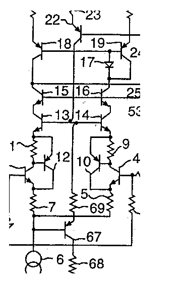

john curl said:It has only enough feedback to meet THX, that is all. I don't like to use feedback, and at 625W, trust me, your loudspeakers make even more distortion. Also, the Halcro should be making even more distortion, if it is still functioning, at that power level and measurement. Want to measure it and get back to me?
PS, anyone can make a low distortion amp at 50 Hz, it just takes an op amp and lots of feedback. It is at 10KHz, that it is more difficult. I should not have to explain this to an engineer.
I don't think the Halcro amps are just an opamp and lots of feedback. I think there is a bit more to them according to the patent description 😉
regards
trev
Scott, Scott, get up to speed. Feedback pairs on the differential input! Where have you been, or is the new stuff like this?
