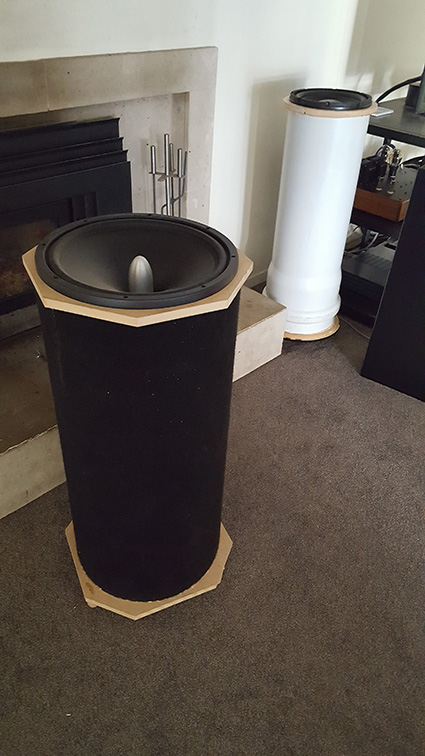

I used a section of this that I pulled out of a skip on a construction site. Twin walled = more rigid.

I would have preferred a thicker and smoother wall on the outside because of a termination theme, I thought to cover the cylinder with black jersey cloth and make the base and top in varnished wood .....
This complicates me, the fabric will not take the shape of the ribbed .... I will continue investigating....

What you put in post 6 would be fine: PVA with a bit of internal reinforcing.
The only reason I used the stronger corrugated pipe is cos it was free 🙂

Concur about not needing reinforcing. PVC cylinders are super-rigid anyway -it's akin to trying to squash an egg end-on, hard to do - especially if you find the right type (of cylinder not egg), typically sewer or pressure pipe from building sites. Generally the contractors give away off-cuts if you ask them nicely. It's expensive as hell to buy.
I've used it for plenty of different sized subs and would never go back to building boxes again. Mine are sealed subs. Do they look good? Not much; I've never quite discovered how to 'paint' over the shiny plastic, though I have a few cans of liquid plastic paint I'm going to try out at some point (automotive stuff).

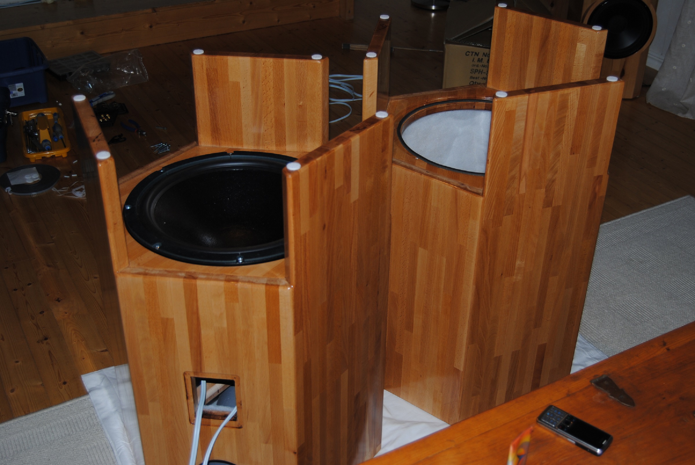

I guess this i all about cylindrical subwoofers but I built a hexagonal pair our of 28mm thick beech benchboard that I got from IKEA.
3 sides worked as legs, the other 3 ended at baffle about 15cm above the floor.
It had a reinforcement that also supported the vent.
The vent vas 110mm pvc tube and angled 90 deg (2x45) to fit the length.
Also the top was reinforced heavily.
The woofers was 15 inch Monacor subwoofers tunded to FS.
They sounded really nice and played very deep with dry bass.

Hexagonal 15 inch subwoofers
This is the only picture that I could find. It was 9 years ago, and I sold them in 2013.
The woofers were these ones MONACOR - Products - SPH-380TC
Out of memory the volume vas 135 liters tuned to 21 Hz.
The coils were in parallell, each woofer driven by one channel from a Alto MAC2400.
/Figge
