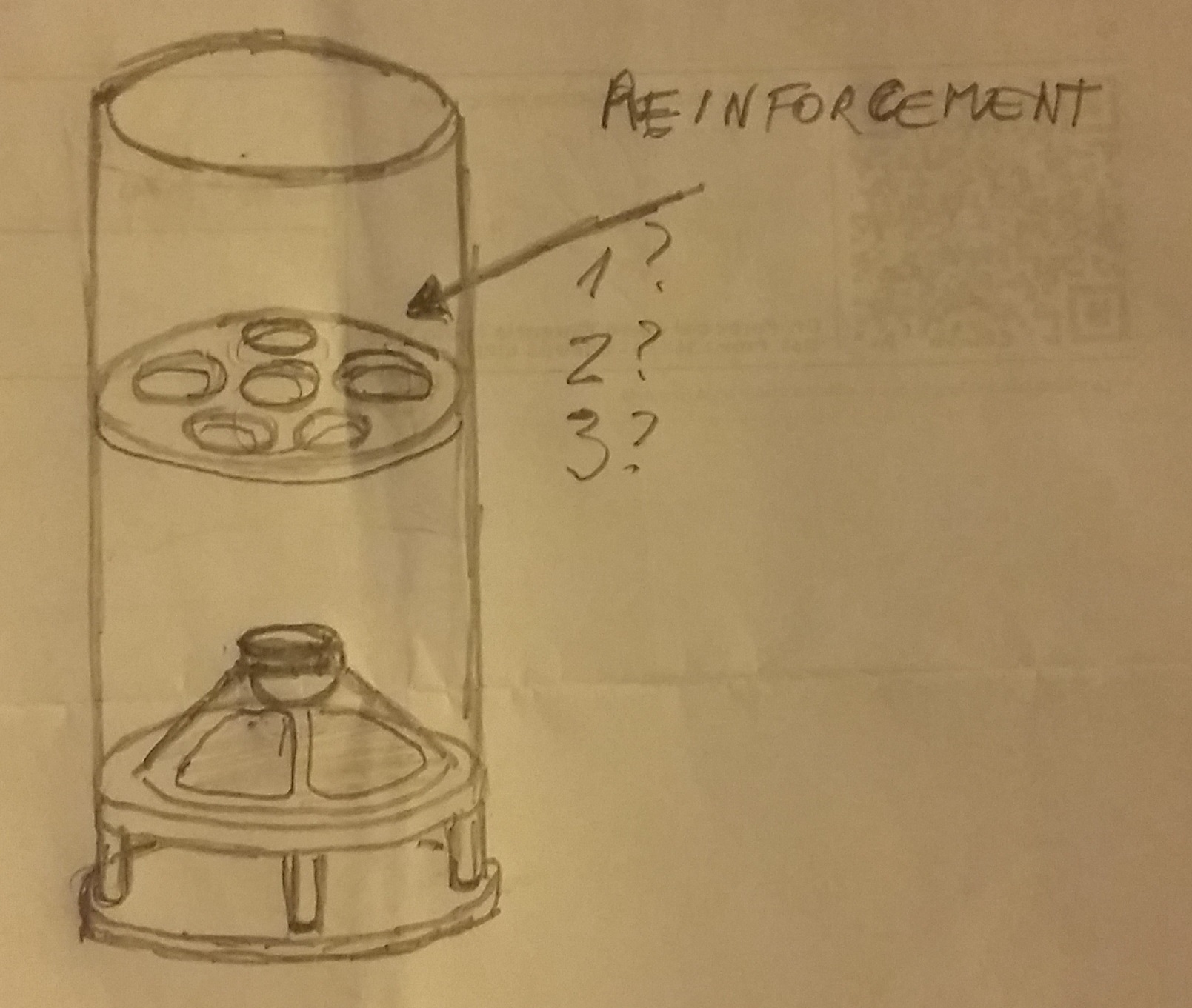

For my 18-inch speaker the tube would be 0.60 meters in internal diameter x 1 meter in height. I think with some internal reinforcements it could work.
Something like that :

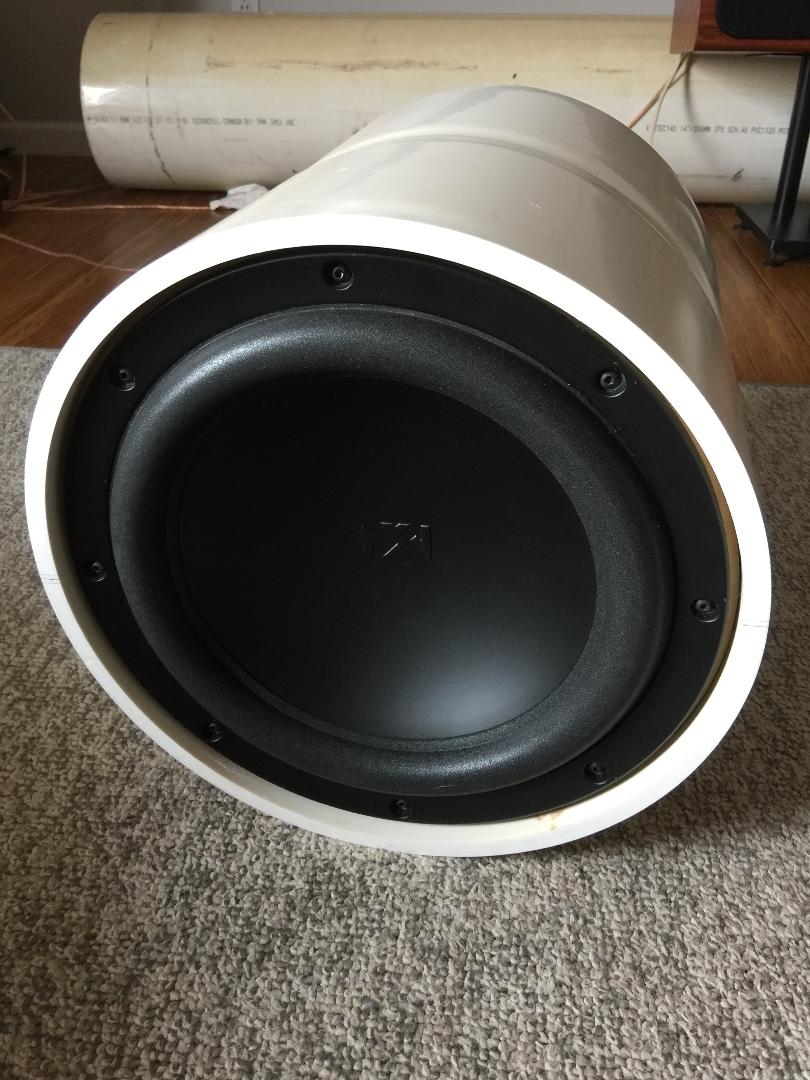

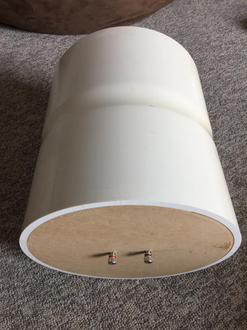

Here is the latest PVC subwoofer. I made 2 of them using 14" couplings and 12" NVX subwoofers. The only brace needed was for the back to stiffen the MDF. Once I get the MiniDSP running I will apply an LT. I need to finish the feet then paint them. I have already started the enclosure for the LAB 12s. The new build will be only 3 feet long and have cleaner lines. Still keeping with the opposed layout for force canceling. Good luck with your project.
Matt

I think it will not be easy but I should find PVC pipes with wall thicknesses like the one I see in the photograph. I imagine around 12 mm ..... that will be enough for me ....
