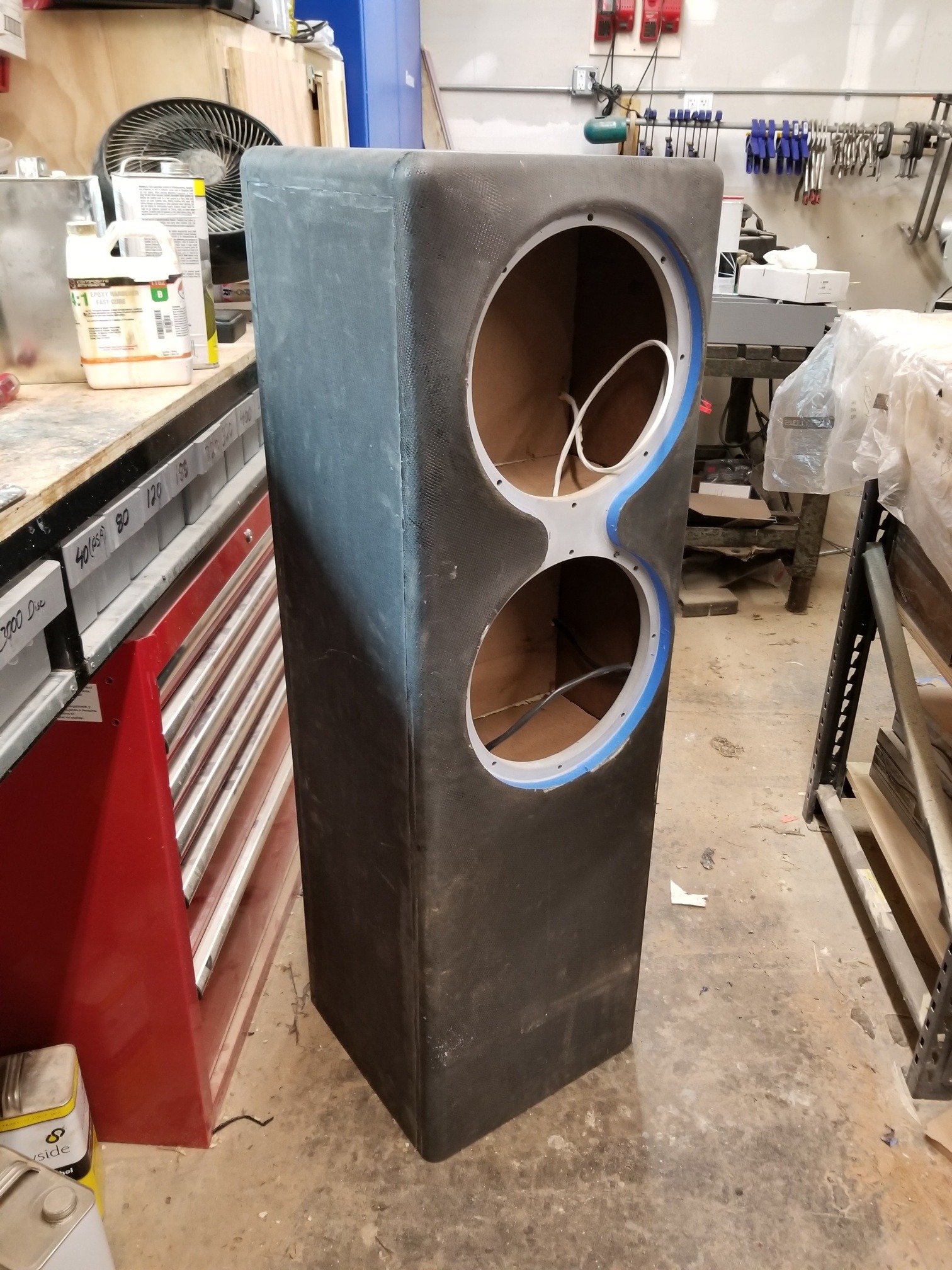

2 things I am recommending here, tell me if you have a problem with it...
1 - Polyurethane soaking mdf or composite wood panels for speaker enclosures. Its easy, cheap, and structurally beneficial.
2- Carbon fiber flakes for surface finishing and rigidity. Easy, not costly, no wasted inventory/ extraneous supplies, looks good, very strong, first attempt very likely good results.

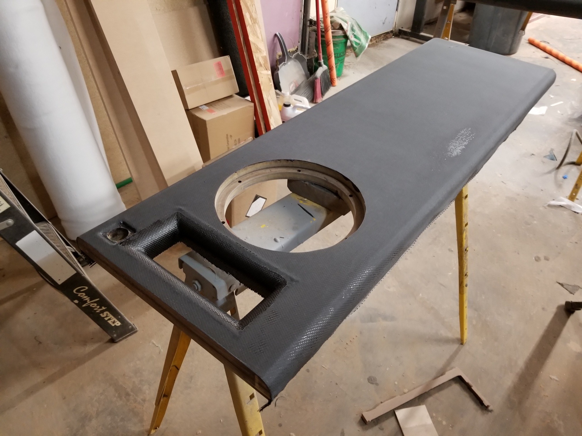

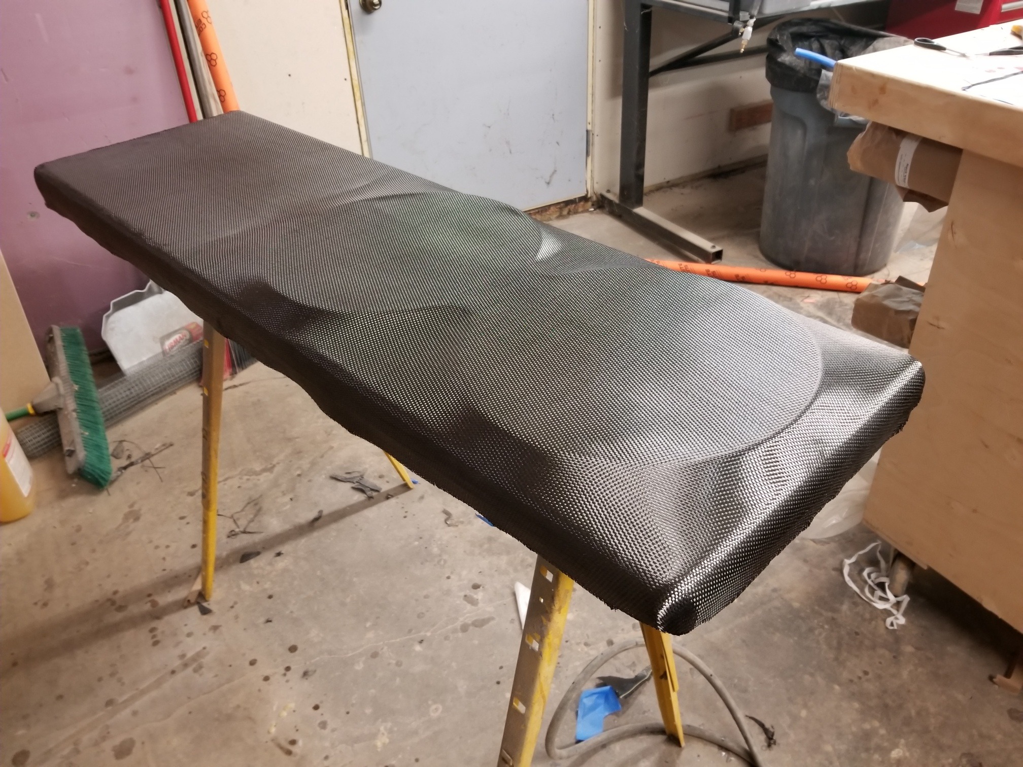

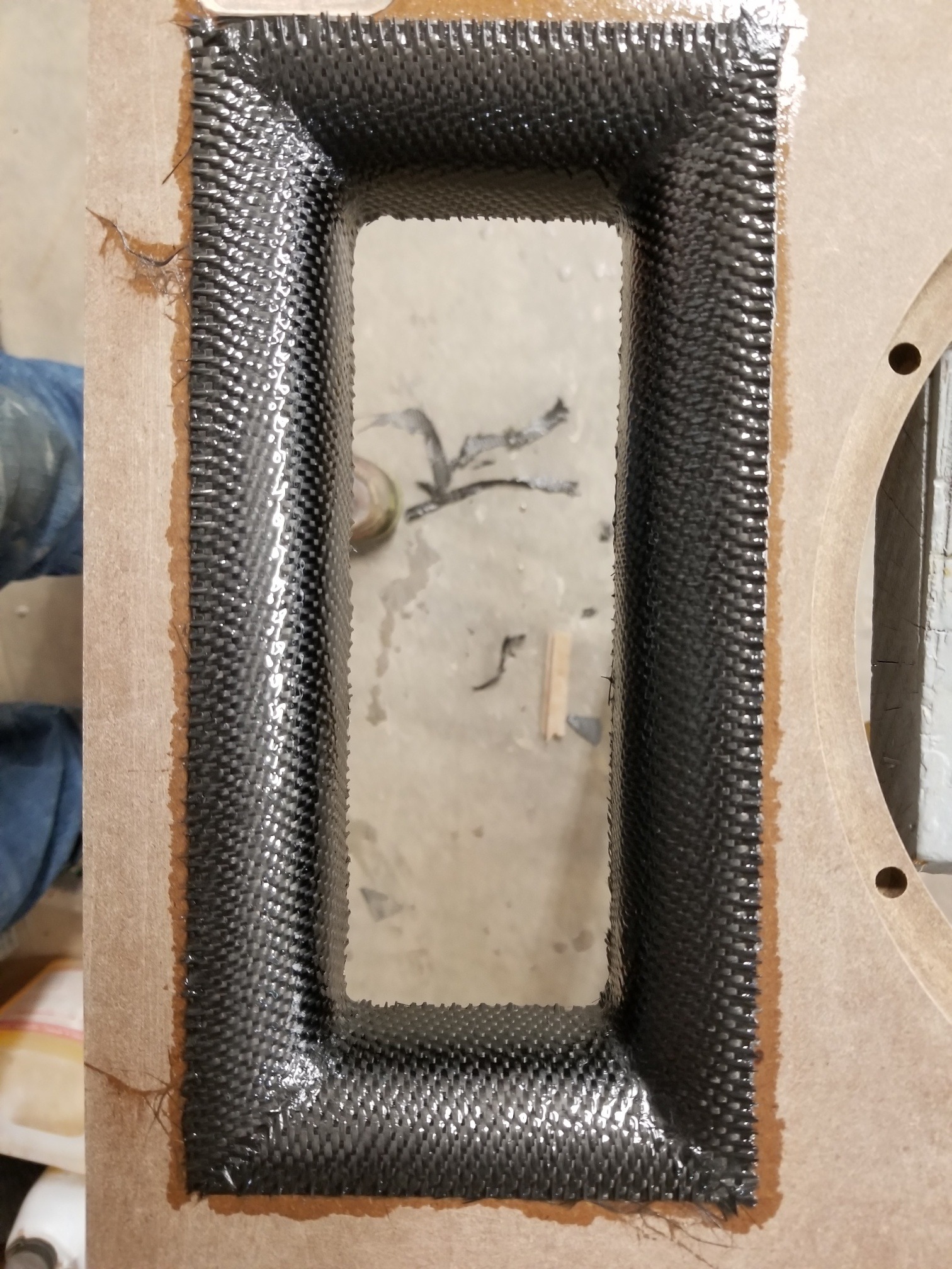

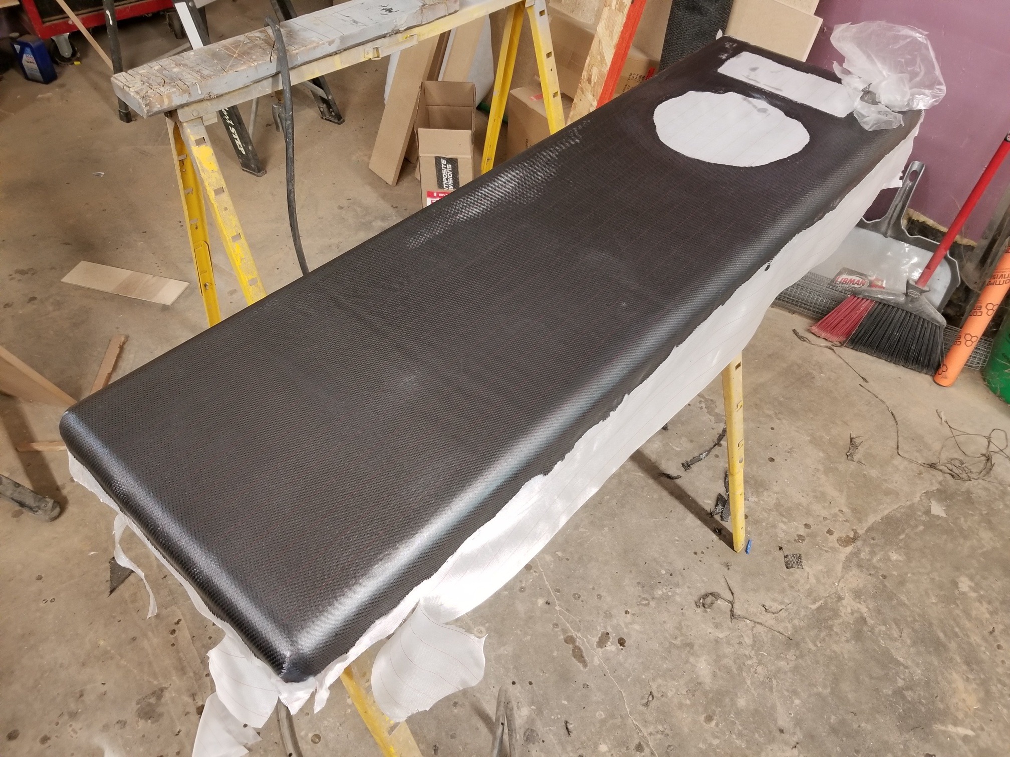

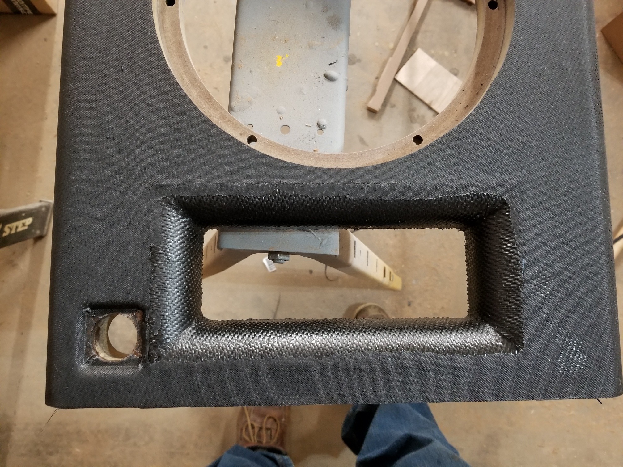

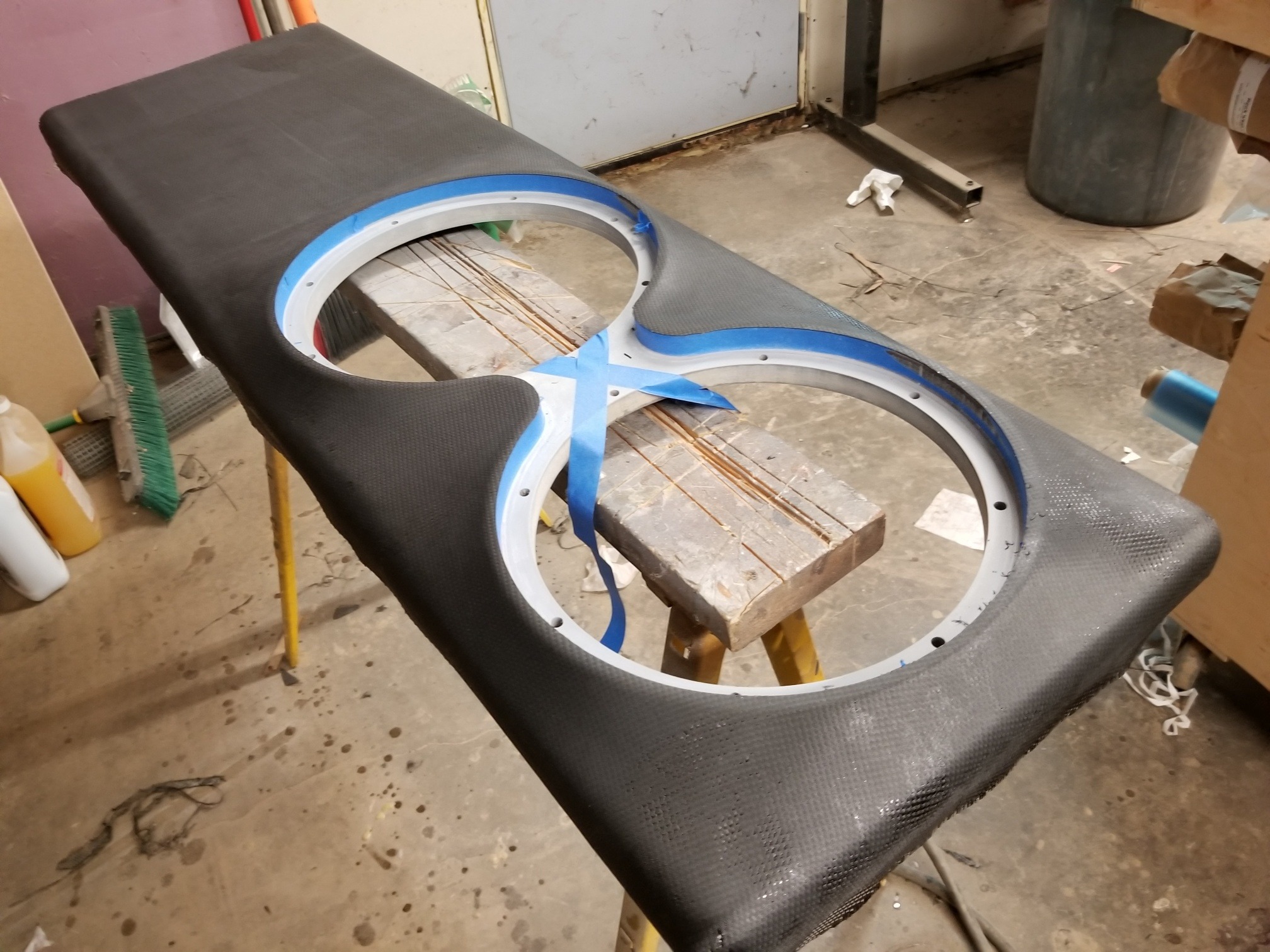

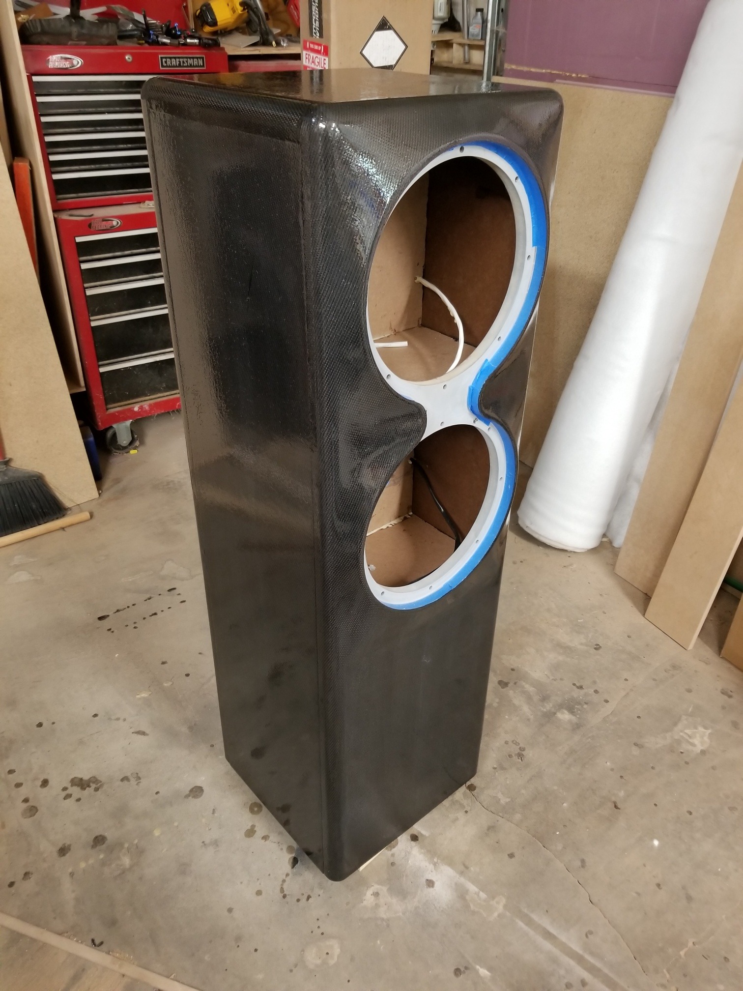

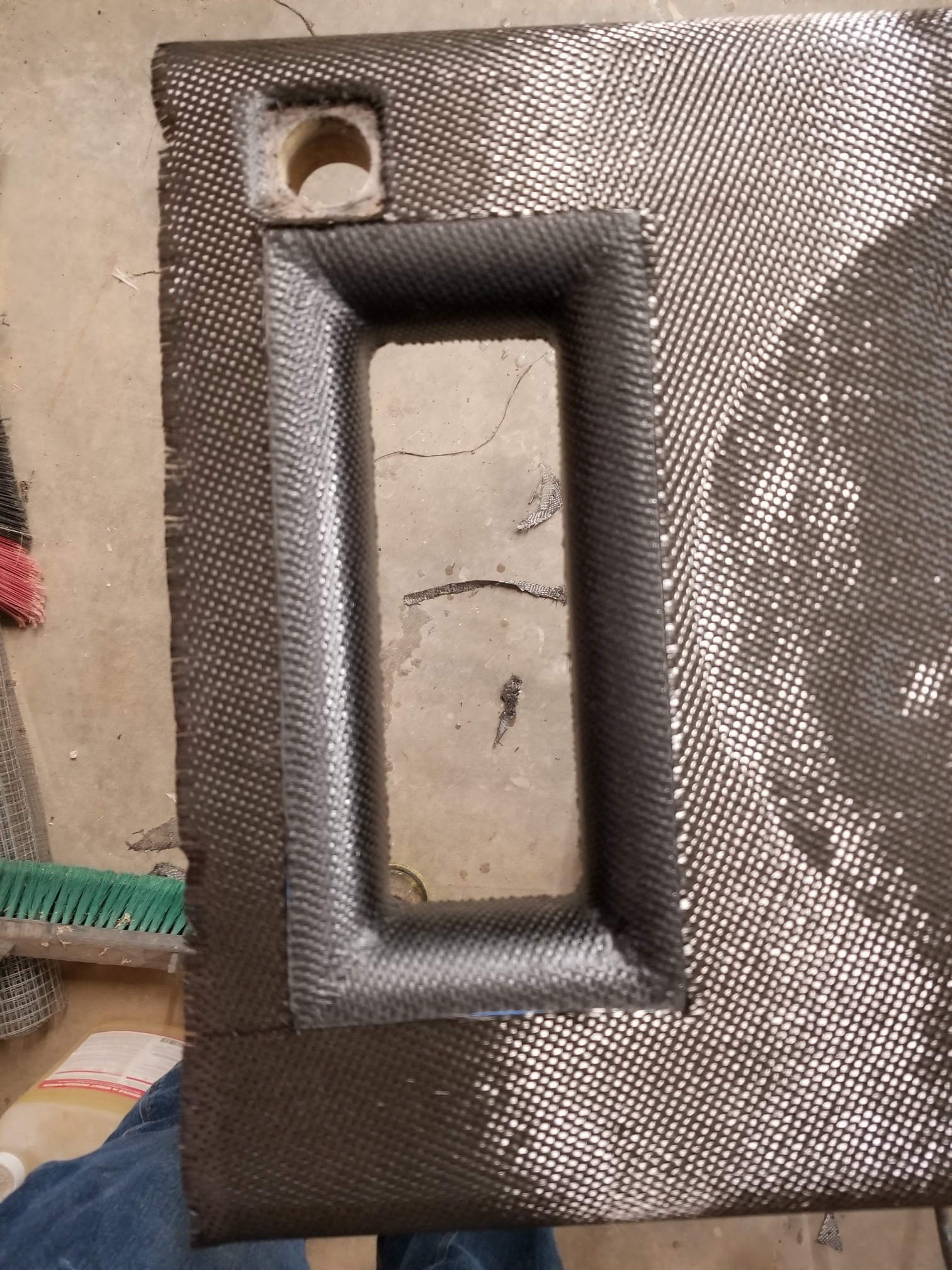

The carbon fiber speaker is taking shape! I hope to de-mystify carbon fiber a little here, since it works exactly the same as fiberglass!

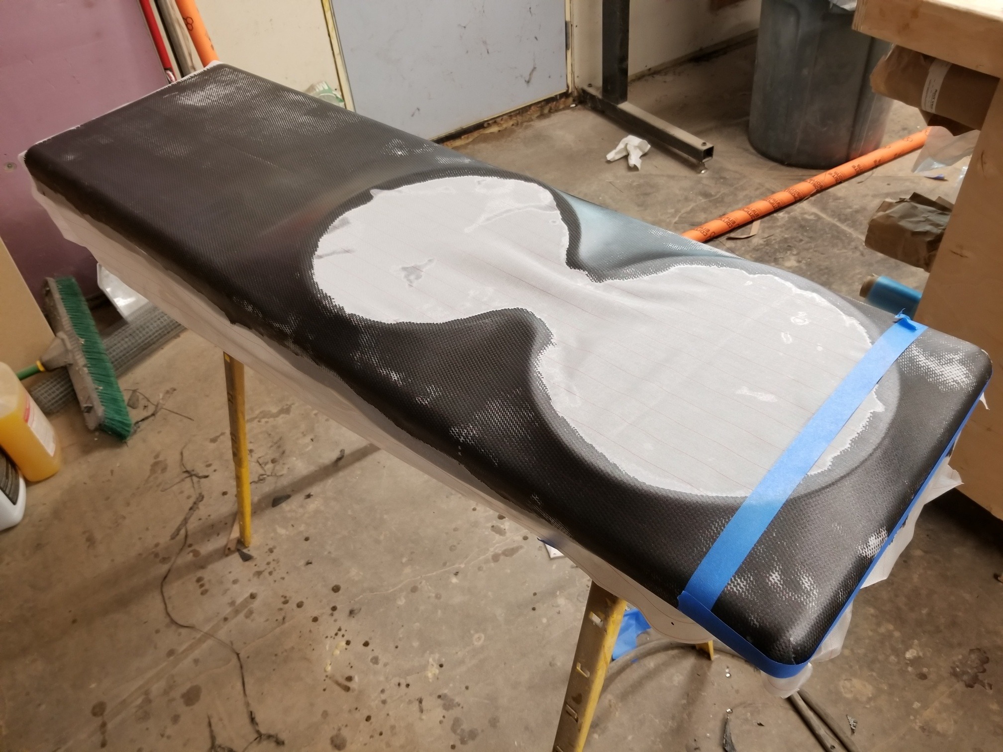

The process is quite straight forward. I used a 3m 71 adhesive to hold the carbon down to the speaker baffle. Of course it requires some care to avoid disrupting the weave of the carbon, but that isn't difficult.
I was concerned about how to laminate the port exit. I ended up doing the port first in a separate step. I used 4 pieces of carbon, glued them in place and trimmed in place as I installed each one. I just used a knife and cut against the wood. It was a bit fiddly, but the spray glue means it stays once you have it positioned. I also trimmed the outside edges--they extend slightly past the edge of the port flare.
Once cured, the carbon left a defined edge. So when I laminated the baffle, I layed an un-cut piece of carbon over the whole panel, glued it in place, and then used the proud edge of the cured carbon fiber to trim. Once sanded and finished, the transition should be just about invisible.
For laminating the main baffle, the only real "tricks" I used was to use the spray glue to hold the carbon in position, and put a layer of peel ply over the carbon once it was wetted out. The peel ply makes it easier to work out small bubbles and excess resin, without messing up the weave of the fabric. And it makes the carbon fabric lay a little flatter.
At the moment the carbon has a matt finish because of the peel ply, but once it is finished it is going be a gloss finish, and the weave of the fiberglass will really pop. I used 5 harness satin fabric, so it will have a different look than the standard 2x2 twill weave that us usually associated with carbon fiber.

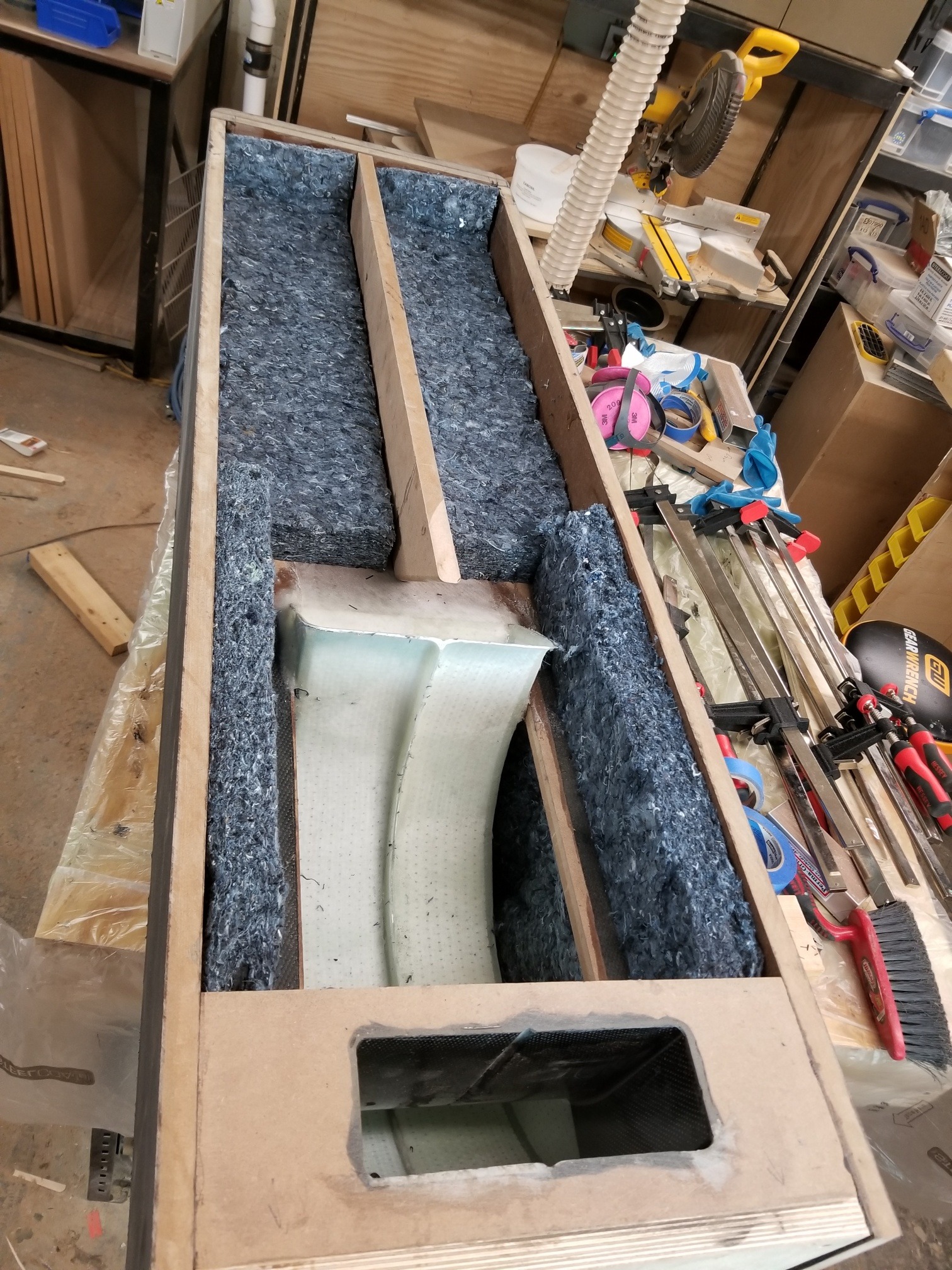

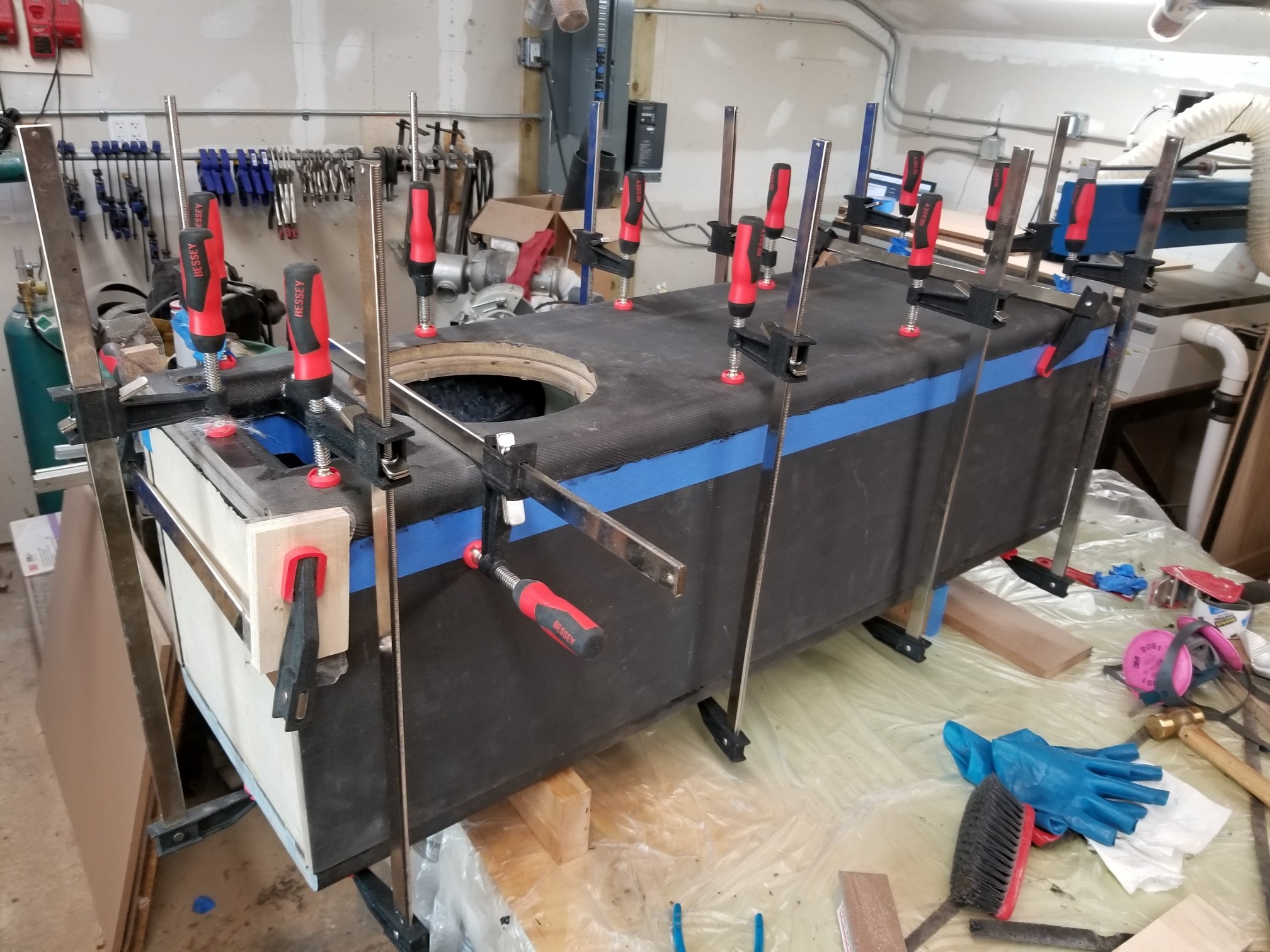

For everyone else, first step of finishing the speaker. I'm coating it with clear resin. Will do several coats to fill in the weave and any gaps in the seams. Sand between coats. It's a little slow, but a simple process. Once I have it built up and sanded flat, I'll coat with urethane clear coat and polish.
I did test out the subwoofer first, because I had a nagging concern that my experimental port design and reduced cabinet volume might not work quite right. But the results are excellent. It rolls off at 20hz, and there is zero port noise or resonance from the speaker. My prototypes had some "noise" when playing a tone. It was noise floor level, and might have just been gaps in the seams, since the prototypes were very quick and dirty (i.e. lazy) construction. At 20hz with this new sub, (20hz is essentially not audible), I mostly just heard cabinet doors rattling. But on other subs, I have started to hear harmonics when playing tones below 30hz. I'm calling it a win!
So yeah, I'm pretty happy with it. Time to start making the second one. But I'm not gonna be done in time to make it to the Parts Express speaker competition this year. Maybe next year?

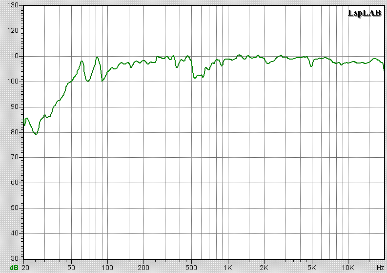

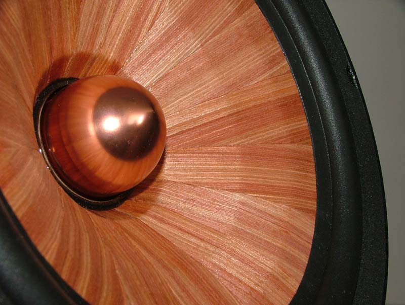

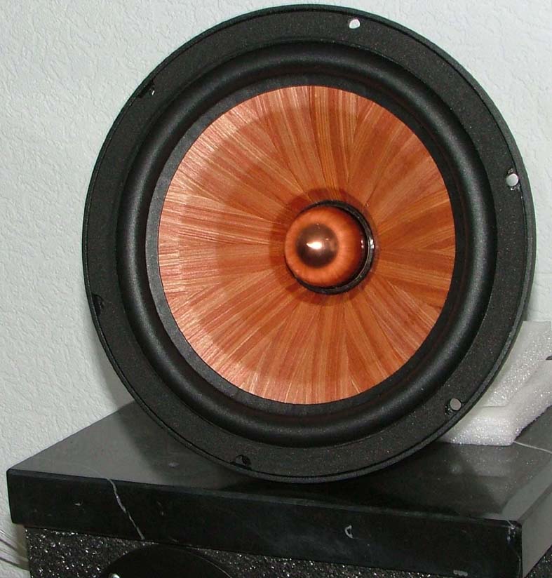

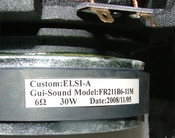

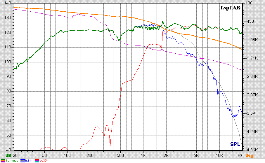

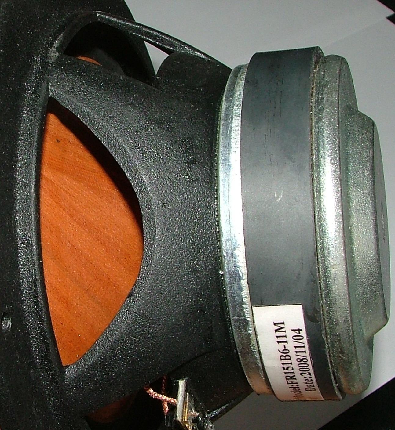

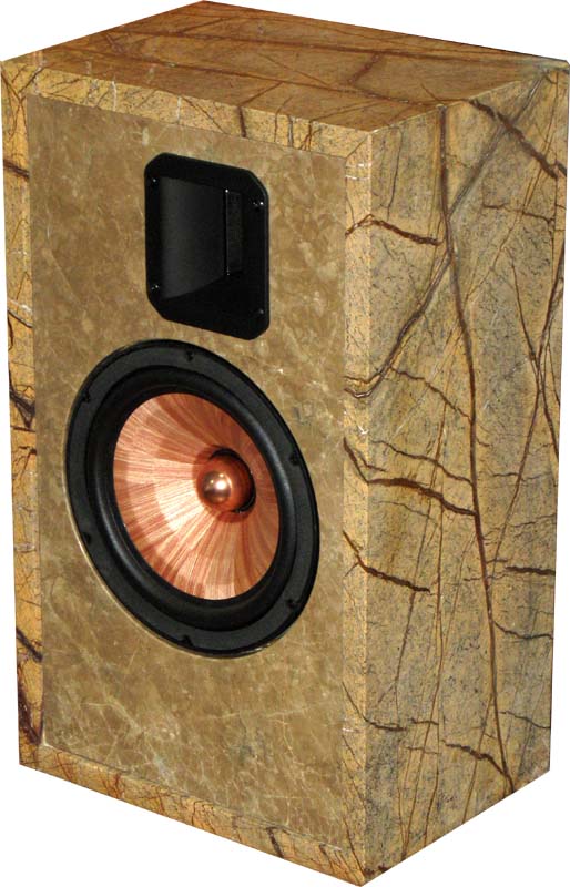

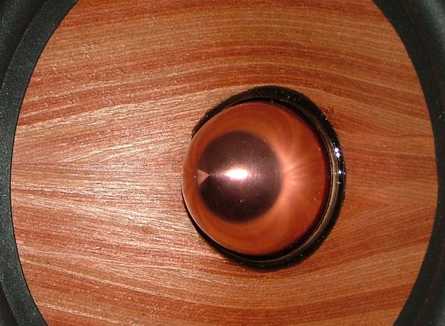

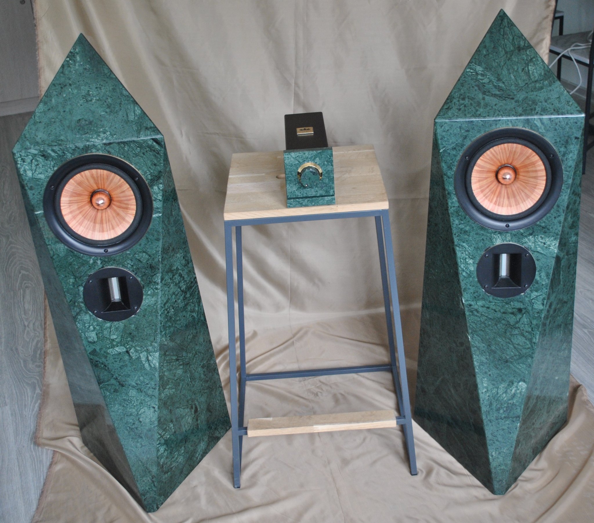

Wood coned? Any 5 dB/div SPL measurements?
http://www.gui-sound.com/e_prd1.asp?pid=2
Yes, wooden cones. I have it a few model for different resonators. Unfortunately I loose pictures collection after russian missl destroed my house in Hostomel near Kiev 24.02.2023. But to tell the true it's looks better, than sounding.

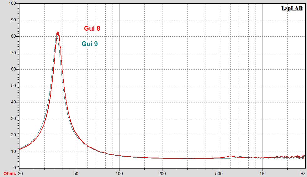

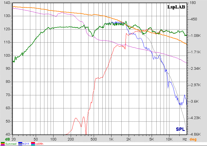

But measurement looks more better, than visual. This is sealed 20 litres with Fountek NeoCD 3.5H
