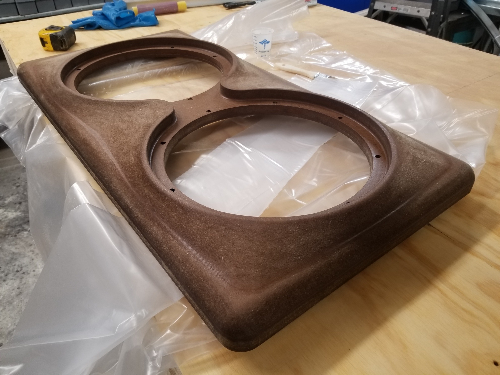

Like this?
When I'm machining molds out of MDF, I always seal them with epoxy. I kind of swore off polyesther resin a couple years ago in favor of epoxy. The epoxy costs more, but doesn't have the shrinkage issues that polyesther does.
But I admit I have been looking for an epoxy that cures faster, to seal MDF. I hadn't thought of using polyesther. When machining MDF I get best results machining when I seal the MDF before the final finish pass. That final pass takes off ~.010", and give an extremely smooth finish, since I'm essentially machining plastic.
The image is the baffle for the new speakers...atleast part of it. My CNC router is only a 30"x40" work surface, so I'm machining it in sections. I'm not worried about joints, because it'll all be covered with carbon fiber.

Has anybody tried using premixed shellac to coat the mdf? Highly soluble, should penetrate deeply, dries quickly and is easily sanded.
ripblade: that sounds like a generic sanding sealer product to me.
The big question is what are you doing after you seal it? If you just want to sand it smooth and apply a clear finish, then sanding sealer is the product you want to use. Sanding sealer won't significantly change the properties of the material.
rschmitt100 seemed to be suggesting that the polyesther resin would increase the strength of the MDF. I don't know how it affects acoustics, but it would strengthen the material to a degree, although the result will vary depending on the grade of MDF you start with.
I'm using epoxy because I'm trying to create a hard surface on the MDF that I can sand smooth and ultimately apply carbon fiber over the top of. Or I can use autobody products over it, like primer and clear coat. The thing is I know that epoxy is compatible with all the products I'll be using along the way, so it is the obvious choice for me.

hi fredygump,
nice baffle, I wonder if vacuum infusing mdf material would be possible.

rschmitt100: I'm not sure how you are thinking of doing an infusion? Vacuum infusion is just one technique, and I'm not sure why I would use that technique on this project.
The plan is a wet layup over the MDF. It's all that is required. I'm going to lay the fabric over the surface, and apply the resin on top. And I'll let the excess hang off the edges to cut once it is cured.
Vacuum infusion is good if you have a mold and are making complicated parts, because you have unlimited open time. But in my case, there is no mold, no flange. And doing it by hand will take less time than an infusion would take, even if you ignore the setup time. Another reason to use infusion or vacuum bagging is to reduce the amount of resin in the laminte, but in this case I don't care. I will be applying extra resin afterward to build up enough of a layer that I can sand everything flat, without going through the carbon.
I've put a lot of thought into how to coordinate the lamination and assembly, and the only thing I can imagine working well is to laminate the panels individually, and then assemble. The front and back panels include the side and top radius, so from the front or back it will be seamless. Side panels and top panel will be laminated separately also.
I am documenting as I go, and I'll create a build thread about it once I have one cabinet complete. It shouldn't take too long!
