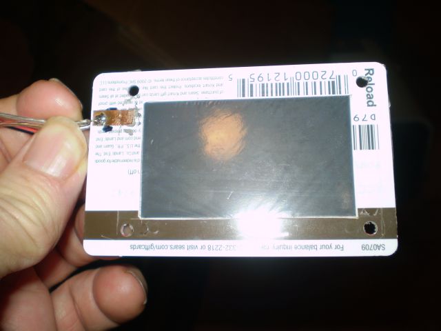

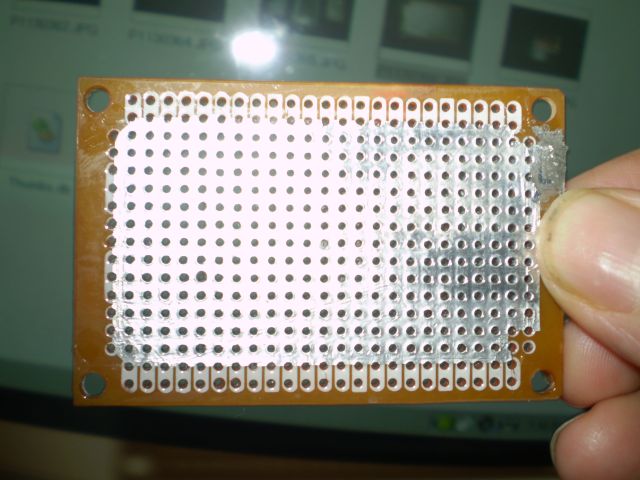

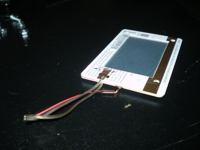

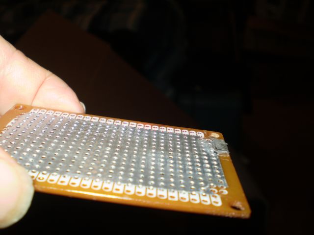

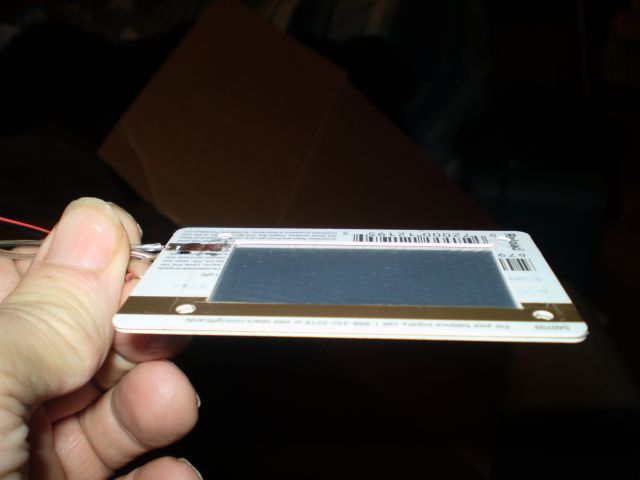

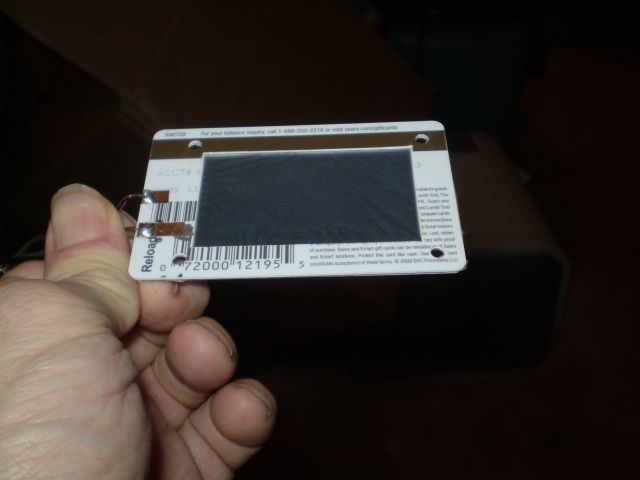

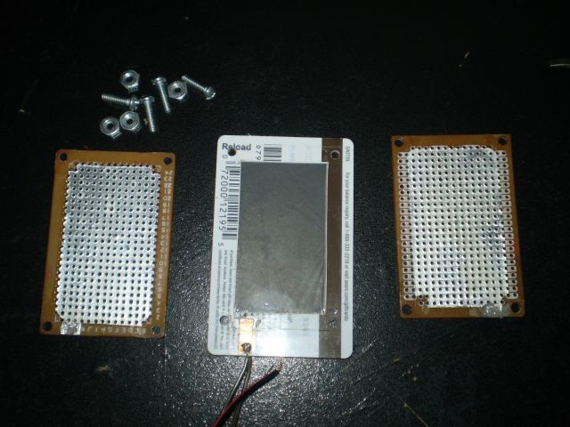

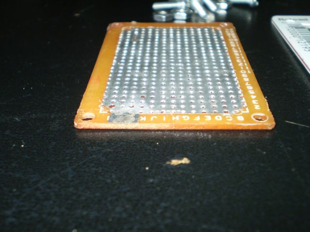

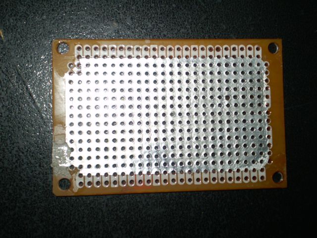

here are the expoded view pics of the tiny driver i had promised to post for you and everyone , wachara C. jer
Hi Geraldfryjr,
Those are very interesting pictures. You have a very innovative idea on making ESL headphones. Thanks for sharing. By the way, what kind of coating material do you use?
Hi Mavric,
I have tried a few hole patterns for the stators, and I like those with more open area better. The latest ones that I made were about at least 60% open area and with 6 millimeters hexagon holes. I think more open area stator has more openness in sound. However, it might be a little less efficient when compare to those with lesser open area.
If I were you, I would choose something that is easy to find. Hole size of around 3 millimeters with open area of around 40% or more should be good and shouldn't be too difficult to find.
wachara C. thank you for the complement.the coating on stator is common clear acrylic enamel and on the digphram used i used licron.it is all i have at the moment and it is what i used on the bigger panels.but my problem is the mylar is .1 mil without the coating (confrimed with a micrometer) with the coating it is about .2 or.3mil (with the latter being the closest average) which is what brought me back to diyaudio to see if there has been any innovative breakthroughs (in the last 7 years) on coating technology's,mavric's idea using rinho is one of them and the pva glue trick is another.now that they are apart i'm going to replace the digphram and try it.if the coating thickness results (as reported in another thread) is acheived ,then, i have some .06mil polyester i can try.jer
quote:"I have tried a few hole patterns for the stators, and I like those with more open area better. The latest ones that I made were about at least 60% open area and with 6 millimeters hexagon holes. I think more open area stator has more openness in sound.However, it might be a little less efficient when compare to those with lesser open area.
If I were you, I would choose something that is easy to find. Hole size of around 3 millimeters with open area of around 40% or more should be good and shouldn't be too difficult to find. " i have always wondered about ,if, such a large hole size would work well.imo for the sake of effiantecy anything larger than say 3/16" to 1/4" would be pushing the limits. although,however, i'm not saying it woudn't work,i personaly have not tried it and had planned to do research on this.i personaly would love to build some metal sheet stators my self as the are athseticly beutiful.but after seeing the prices (last night) of material it just brought me back to the realization of why i choose the construction i used.cheap and effective and still with great sound.now there is alot room for improvement for my design, i agree,such as(my biggest concern) panel viberations and such which can be remedied with some braces or just build a stronger suitable frame.hole size? i used window screen,my next step is to try 1/8" welded wire mesh but who's to say that the common 1/4" stuff you find in hardware store wouldn't work ethier .it has yet to be tried and some thing i had planned to do a long time ago,and the reasons i didn't yet, i have already explained earlier.so before you spend $$$$$ on some steel panels,may suggest to you to maybe building somthing smaller as a test first to see if the results are what you desire.that is how started on a very stirct budget and ended up with fabulous results.think about the weld wire technique is suggested as it is defintely a cheaper way to go and still acheiving the same high quality results.i would like some of your thoughts and views on this.jer
Jer, I have never done this before as i have said. I will try my best to explain.
> prepping the panels, i know they will have a ruff cut on the back end, that is where the orbital sander comes in, i have to prep the surface, rremoving any unwanted material, its not sand paper, i call it a "scuffer", then denatured alchohol is used to clean any debris from the surface.
> This is my last concern. the hole diameter. i have been given metric and standard. the panels will be about 13" by 48" . since i can on only run 4 ohm max, this will be a hybrid, elctronic crossover for the panels at 500 hz. and powered servo subs with variable cross over to compensate low end. which i allready have, plenty.

wachara C. the reason i had come up with i the aluminium tape idea is becuase i could not find a source of predrilled un etched copper clad board material and the the ones that i did find that could have posibaly been made to work were extremly expenceive for this application.someday i plan to purchase or build machine like yours oneday.very impressive.jer

i meant aluminium window screen.i think 60% would be fine.but no more than that though as it would decrease the efficiantcy(loudness) of the panel.also you stated the panel size which is fine,but you did not state the hole size and spacing( unless i had missed it somewhere) which is my major concern, without knowing this i can not make a proper recomendation.for example if you have panel with 1/2" holes it will be less efficiant than a panel with 1/8" holes ,even though they both have 60% open area. wacharaC. stated he used 6mm sized holes which is 1/4" imo thats quite large.it would be good to hear some more from him concerning this.since( in all of the post i have read so far)he is the only one i know of to try any hole size bigger than 5/64" or 3/16" (slightly bigger than an 1/8").jer

From what's available at McMaster-Carr, I think the choices boil down to 51% or 63% open with either .141 or .187 holes (for 51%) or .156 holes (for 63%). I think .141 holes are closest to the "Cookbook" ideal for 1/16" stator/diaphram spacing and would give the highest output. In your case, however, no one but maybe you has a feel for how much that Rhino lining might close up the holes-- maybe the safe bet would be to give up some efficiency and go with the larger holes-- it's a tough call.
