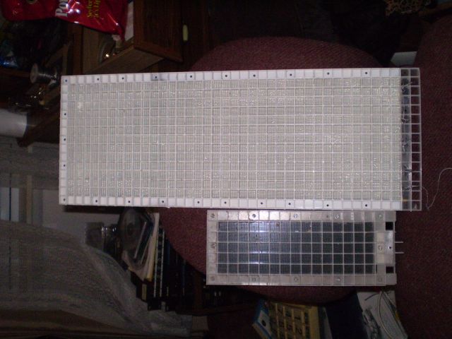

Hi Geraldfryjr.,

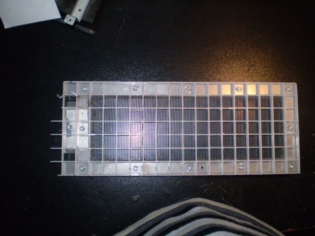

Those are nice looking stators. Do you make those?
Do you have any idea where we can buy the white plastic egg crate looking thing?

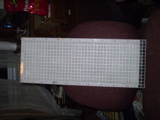

Seen similar on offices dual tube fluro's to difuse the light, perfect size for this app, stiff, light, and the squares are about 1/2inch
Cheers George

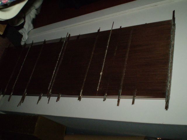

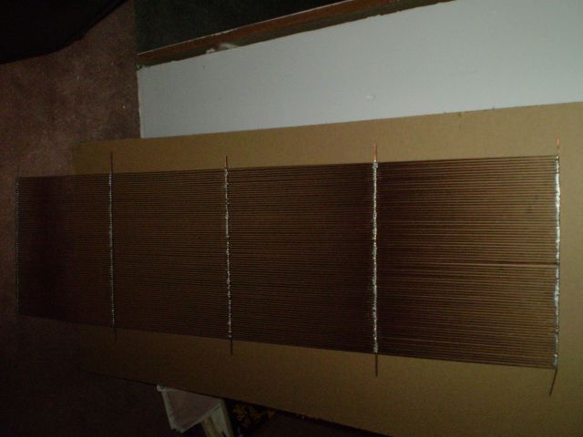

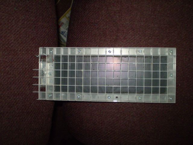

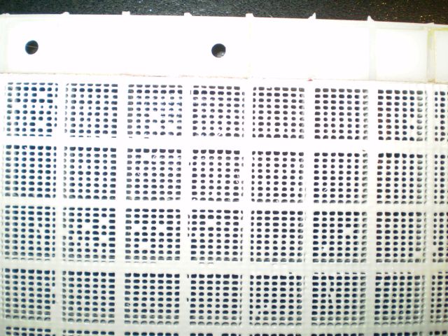

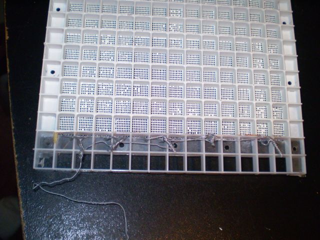

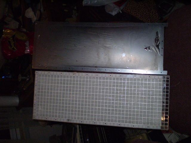

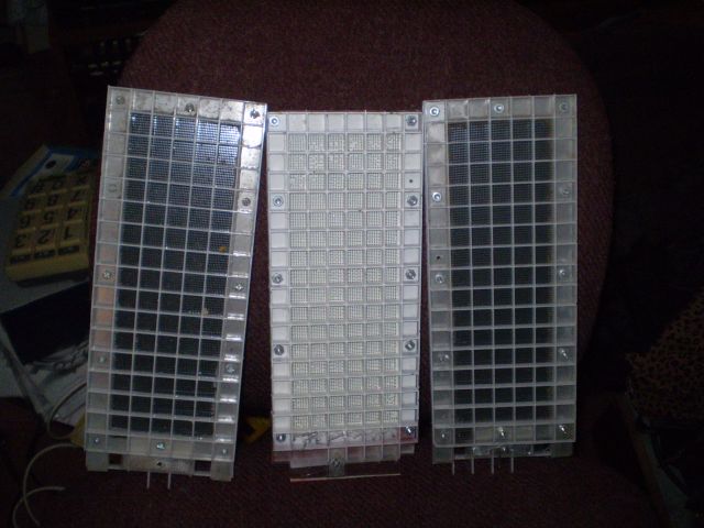

thanks,yes i did make them.here in the states you can get them at any home depot or menards .they're 2' x 4' standared lighting grates for florescent tube ceiling fixtures.i once had a source to get full size 4'x8' sheets but that was back in 2004.like i had stated in another thread a haven't done anything since, do to my stupidity (dui's), reasons that have set me back a few years.so i got my sh$# together and i'm back to r&d this stuff again those panels were were made in 03 or 04.man how time fly's. but they still work .the little ones (black stator) are the final design and i have (have had for years) the material to build full size 1'x4' panels.i plan to start them soon including finishing the wire grid ones also.jer
yes.i am familiar with headwise projects and have a complete (almost anyhow) photocopy of the audio amature book with esl's and amps for them.when i recently got back int r&d of this project i found a thread from 2006 on the same circuit i was developing ,needless to say i was locked up at the time,so then i decided it was still worth persuing.so i checked out what was going on now a days,so her i am.i used read these forums all the time but never posted in any discussions. i also used to play with my own diy ribbons back 1990 and so on.i still have my orginal stack of magnets and just recently bought some more smaller ones to build some nearfeild monitors to mix with.jer

i was wondering were you went.i enjoy chatting with you and would like very much to see you get your project underway no matter which technique you use ,you might discover something new that we all could learn from. jer p.s. did any of my pics help you?

"ha,ha,ha,as a test i was listening to some rain and thunder off of a cassette tape and my dog kept running to the window to watch the rain but there wasn't any.it was the funniest thing i ever saw" if a dog can believe it heard that rain from those speakers what does that tell ya! the transformers were little 15 watt 6v6 types from an old stereo tube amp i had(gone now and still very bitter).with some where around 20 to 30 watts they would play high 80db to low 90db range 10 feet away loud enough to enjoy but not rock your socks off .it was very hard to find any decent albums to play through them even frampton comes alive was badley eq'ed and some of darkside of the moon was anoying at times because you could every little detail inclueding the edits and overdubs but i got used to it .i guess i was just over whelmed by the detail! i wouldn't change a thing and swore i would never buy or especialy listen to a another box speaker again unless i had too.jer

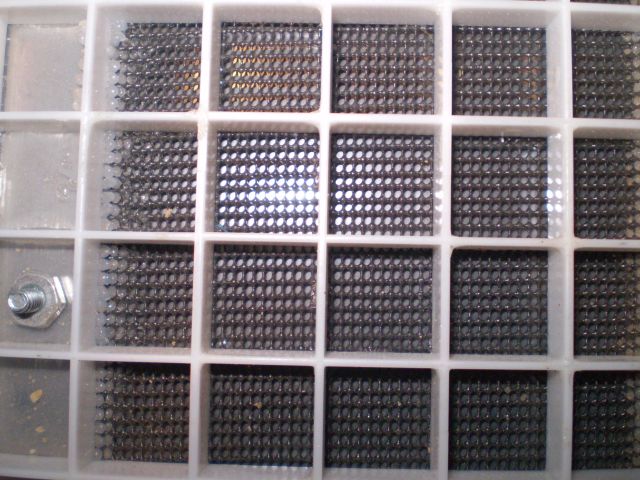

20 mils is good depending on the dielectric strength (v/mill,volts per mil) of the material.i'm asuming at least 200v to 400v.since you work with it, you might be able to obtain that data much easier than i.jer
i mean 20 mill thickness, i use a digi to measure the thickness between metal and material.

yes.i ment the coating thickness.i'll be waiting here for your progress.it takes alot of patience to build these things,but is well worth it.it would be wise to do a small test sample and hook up a bias supply and se if you get any arc threw on it to determin if the coating would be thick enough.as i did .as the white ones were painted and needed several more coats to get the desired insulating factor.jer
as you said the sprayer burps at times,you dont want any air bubbles as this would make a thin spot in the coating which is one reason i asked if it is sandable.if such is the case,you could sand it and recoat if nesessary.thicker is better as long as it doesn't plug up the holes too much.jer

it should,how ever stainless is very difficult to cut if needed, i have considerd using it myself as far as the open area is concerned it is probaly okay just remeber that when you have it coated, the area of the holes will be reduced slightly,now some where in these forums there is a discussion of effect of this, i don't remeber where at the moment,but as i posted earlier on my headphone driver it seemed to be lacking some high end possibaly due to small open area,i really need to measure it to be sure because it could be the material i was listening to or i am suffering more hearing loss on the high end than i relize.jer p.s. oh yeh not to mention the cost of stainless compared to other suitable materials.
