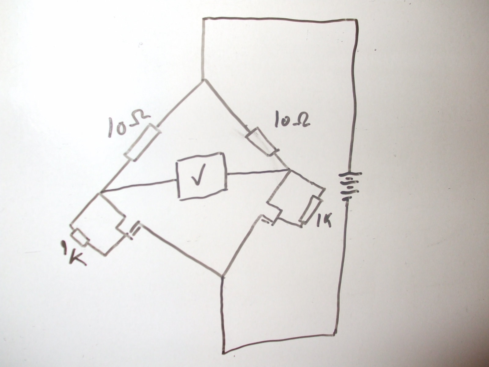

You guys are worrying too much, usual precautions when handling parts are plenty and more than sufficient. No need for copper wristbands or ESD-safe work places.
I never had a shot mosfet and I matched hundreds (all types, small signal and the big guys, N & P channel). The guys take 20V and that's quite some.
EDIT: same setup for verticals and laterals, for P-types swap + and - voltages (supply and ground) in comparison to N.

Yesterday I tried to make the setup for the old Hitachi's and came out with Vgs different for the N and P types. At the setup I used 15V and 100R not the 56R as recommended.
As Hannes told us the bic fet gate takes 20V, and by use of 15V you should be on the very safe side and unable to harm the gate.
The Vgs messurement showed from 1,251 down to 0,990 between N and P types (may be some of the devices slightly more ...I can't remember). with 15V across the setup and 0,990V you should have 14,01V across the 100R or 140,1mA "waterflow" through the device??
The test was done without heatsink and within 10 sek...next test shall be on a proper heatsink and...say 20-30 sek. what do you say?
Just to clarify things: that's 20V between gate and source (VGS), source and drain take a lot more (see datasheet); when measuring VGS one is far below 20V.
If you really have 14V across the load, you're right, it amounts to 140mA drain current. But as I said, better stay out of the linear region, so choose a much smaller resistor, 10R or so is plenty, and allow the fet a drain source voltage of 5V or more.

Hi Hannes,
Ok - the 2SJ50/2sk135 takes approx. 160V .
I shall try with the 10R resistor and start with 5V - 10V and 15V and the devices on a heatsink. Would you say about 10 to 30 seconds or longer time for heating up?

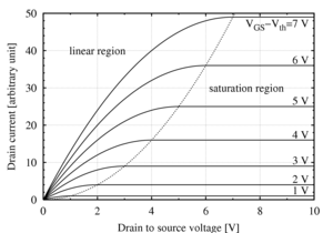

May I ask...what does it mean to stay out of the linear region?..just in short!

Hi Gudmund,
your obtainable level of matching is very likely to be more limited by the small number of fets that you have, waiting for perfect thermal equilibrium is already next level 😉
Of course it doesn't cost a thing, so you might wait 5-10s just for fun.
However, keep an eye on power dissipation, running fets at 14VDS x 0.14 A~ 2W is already more than I would do without a heatsink.
Easy - if you look at drain current versus VDS-curve in the datasheet, you see there are two different regions. For a low VDS, the fet behaves like a resistor, means drain current changes proportionally to VDS-voltage (increase VDS and drain current increases too). You don't want that as any ripple on your power supply rails will cause ripple in drain current and things are no longer really stable.
Above 3 VDS or so drain current is stable like a rock and does not vary almost any with VDS - that's the saturation region going from these 3 V to whatever limit. That saturation region is also the reason that it doesn't make much difference wether you match at 15 VDS or at 40 VDS.

Hi Hannes,
The test shall be limited to 5-10 sek. I shall stay away from second level now.🙂
Because of all the information from you and other good hifi people here, things begins to light up.
I think I found one picture which visual explains what you told me in words about staying out of the linear region and messure in the saturation region where the current does not change that much .
Please see the attached curve I found for mosfets...and this is the text below the picture:
"MOSFET drain current vs. drain-to-source voltage for several values of V G SV t h ; the boundary between linear ( Ohmic ) and saturation ( active ) modes is indicated by the upward curving parabola."
By 5V this fets draws about, or allows a drain current of approx. 25mA.... is this correct?
The picture also explains why 5V is sufficiant for messuring (in this voltage area).
It is quite remarkable that the current is stable, "like a rock" as you said, from Vgs at only 3V? ...but one does not understand everything yet. I think to have found and read something like a slight difference in gate capacitance between the Hitachi N and P fets. Even with the best matching between N and P outputs ,it will be difficult to reach the same AC signal amplification (positive and negative sinus) because of this difference in capacitance. Is this correct?

Hi Gudmund,
that's the exactly correct pic 😉
No; the plot shows drain current versus VDS (drain-source) for different VGS (gate-source). In any real application the gate sees in idle never 5 VGS, it's (depending on part) between 1-2 V for laterals and 3-4 V for verticals.
So, for your lateral parts, the 2VGS curve would apply roughly. Y-axis says 'arbitrary units' - means in this case corresponding drain current is device dependent. For the big parts this current is usually already a few A or so, far above any common bias current.
For the 2 VGS curve the linear region ends at 1 VDS or so.
Real perfect matching is simply impossible as charge carrier mobility is different. Even for the same transconductance the gate capacitances will be different, so frequency responses are different (though that usually does not matter at all).
No big deal and no need to worry, really.
Hi Hannes,
Oh..I think I wrote things a bit wrong in english - I did not mean 5 Vgs reading..contrary I did not read the curves right -
I understood that my Vgs readings from 1,4V down to approx. 1,0V by the applied voltage of 15V was expected from laterals, and that you recommended to lower the applied voltage in the small circuit to 5V(not Vgs) and the R1 to 10 Ohm ? ( I did use 100R in the first place to reduse ampere) ...or did I get your intention wrong?
it's not the Gate voltage you measure.
It's the Vgs that should be measured.
Now you have to decide @ what Id you want the Vgs while Vds is set to ?
