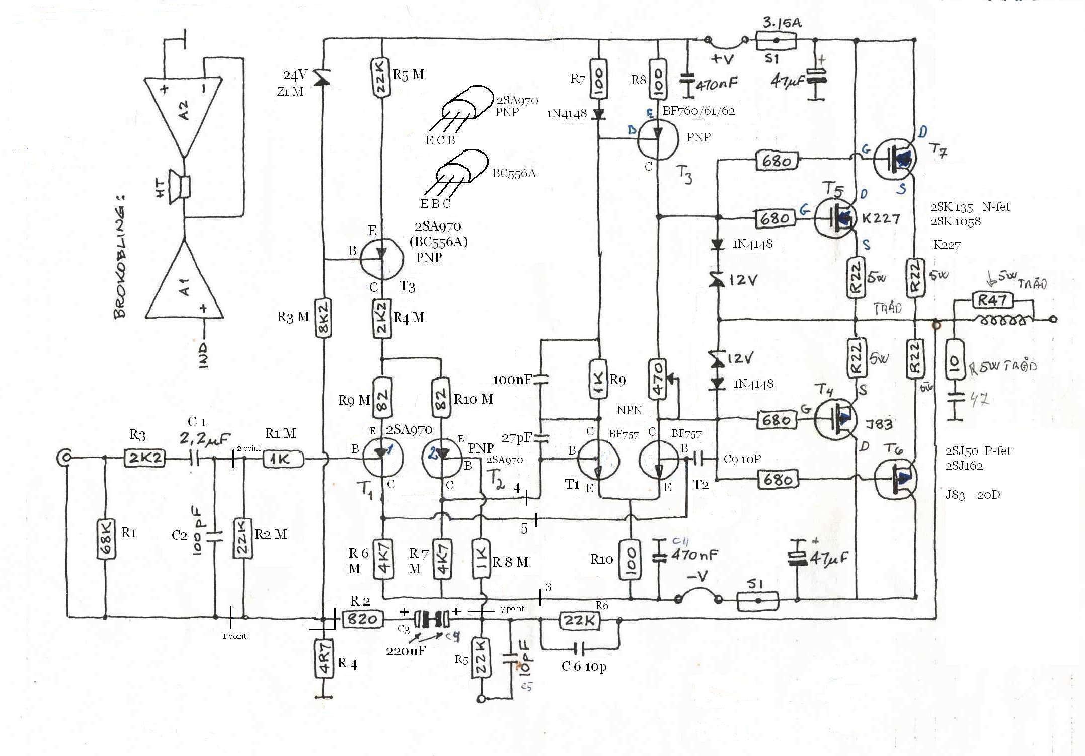

Hi , as being new in electronics I need a simple circuit to match a double pair of 2SJ50 / 2SK135 Hitachi mosfets for a 100watt amplifier.
Would it be difficult for "RS232" or someone else to draw the curcuit to show me the setup for matching output Hitachi mosfets?
Thanks for your cooperation in advance.
Gudmund

What do you suggest? It seems to me, without knowing, that it will be difficult to get the final result at operating voltage (approx 43Vac x 1,41 = 60Vdc) and Current approx 100mA per pair. Don't you think it will be sufficiant to messure on a woodboard at 15V and say: 170mA as I have seen Mr. Nelson Pass suggest. I have never seen the setup, and would like to have a drawing.
I wish to use a 1983 circuit which I owned back then, and liked the sound. Please find the circuit attached.

Thanks Eric, just looked fast on the circuit for IRF fets. Could the old Hitachi's be used in the same circuit? ...and with the same voltage of 22vdc? ..at which amount of mA should the messurement be taken, to ensure them to be matched sufficiently for the attached power circuit?
I'm not sure about the transistor substitution. In an ideal situation, you want to match your transistors at the voltage and current levels that they will see in the completed circuit. What I have discovered by playing around on my own, is that you can also achieve good matching at lower voltages and currents than the transistors will see in the completed circuit. Just keep an eye on the heat if using higher voltages and currents for matching. You might not be able to power them for more than 30-60 seconds before they get very hot.

Yes ...but could you draw the setup for me. I have made the PCB in Cadint and the layout is checked.. the PCB is ready for mounting components. I have never used 2SJ50/2SK135 and have 10 of each ...hobe this is enough to get two matched pairs for each channel.
Rgds. Gudmund

Yes...I have some TO3 heatsinks for tests...I might need to mount them on a heatsink by use of a higher voltage. Which voltage would you suggest and the approx resistor value in the shown circuit on your site?
Sorry, these details are missing from my web page - I'll update it shortly. Anyhow, I started with 22v rails and assume that the mosfets will drop 4v of power, so 22-4 = 18v. Then use Ohms Law (I=V/R) and plug in the voltage and current levels you wish to use for matching.
For me, I matched the bigger 240's at 22v and 1.125A. Plugging into Ohms Law, 1.125A= (22-4v)/ Resistor Value. Solving for R, you get R=V/I, or 18/1.125, or a 16 ohm resistor. For any other voltage and current combination, just plug in different numbers.

Thanks...at your example we need P = I x I X R which gives:
1.125 x 1.125 x 16 Ohm = 20.25Watt ...a test resistor of at least 25Watt.
Did you only use this voltage/ampere and resistor value? ....I have one question more, and then I shall leave you alone.
The gate has a voltage value where the fet "opens". Is it nessesary to messure this voltage value to state whether the two fets is considered to be a good match? If so ...how do we messure this ? by a 10K multiturn pot from the 22Vdc supply to the gate?
