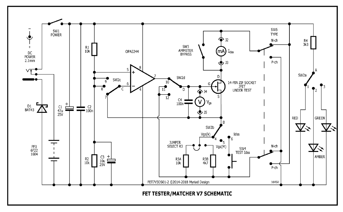

The title of the ZVP4424A datasheet says "ENHANCEMENT MODE". That means its Idss is zero. However JFETs are depletion mode devices; their Idss is not zero. So a JFET tester will not give correct readings on enhancement mode MOSFETs.
