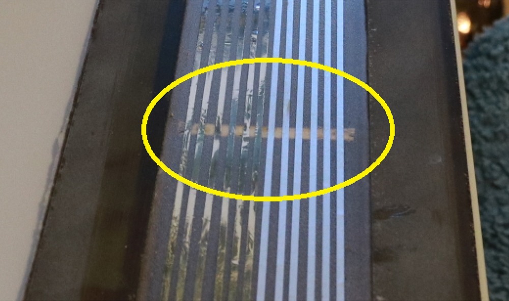

The middle of the three panels has several disks or "tuning pucks" attached to it. These tune the panel a little higher in frequency to suppliment the mid panel.
Here is a pic of a nude mid bass panel. I circled the tuning pucks in yellow.
With the RD-75's there is no help needed in the mid range which is why I would like to try replacing the mid bass panels with bass panels.

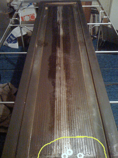

No that is not correct about the tuning. Tympani IVa looks like this without wiring. From left to right, low bass, midbass, tweeter and midarange. The order should not be like that, the tweeter/mid panel should be left of the basses so that the low bass driver end up in the center, taking maximum advantage of the baffle width.
That's what mine look like from the rear. I have my tweeters on the inside though...Thanks.

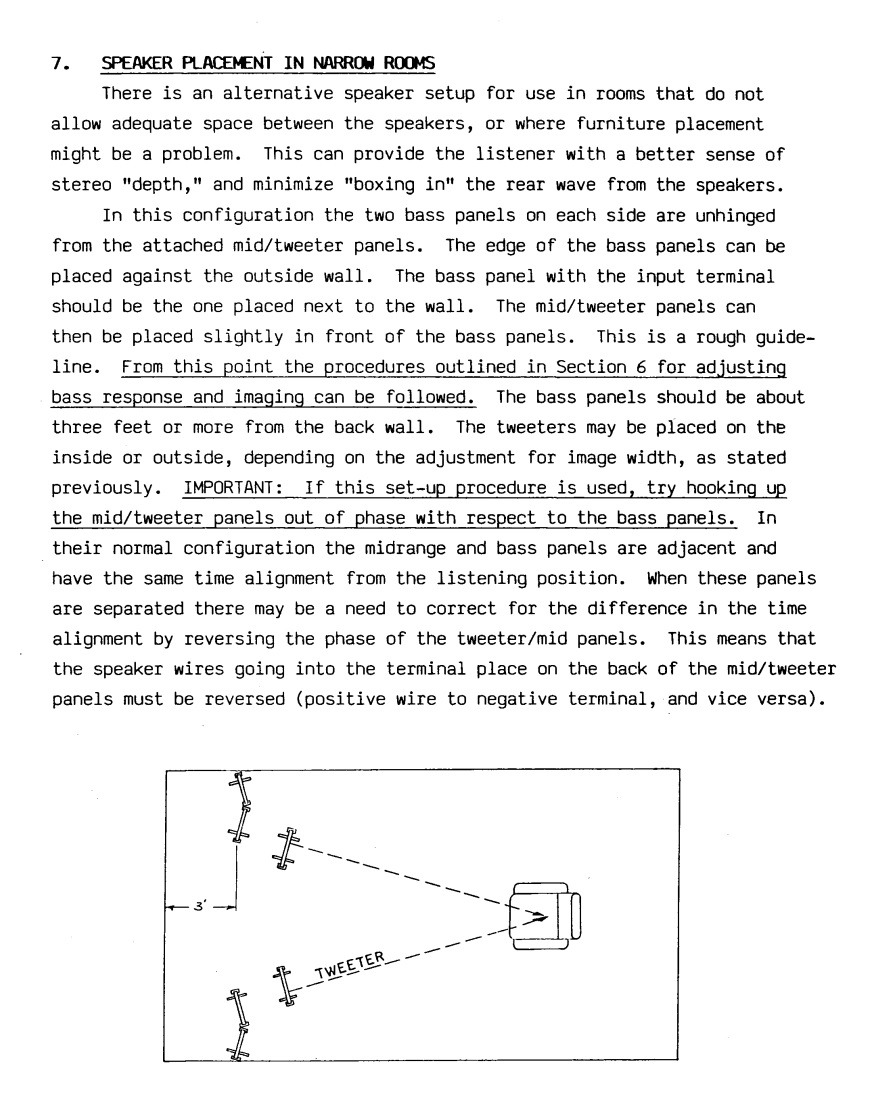

If you skip the mid/tweeter panel, the basses should be placed like "the narrow room setup" as suggested by Magnepan.
