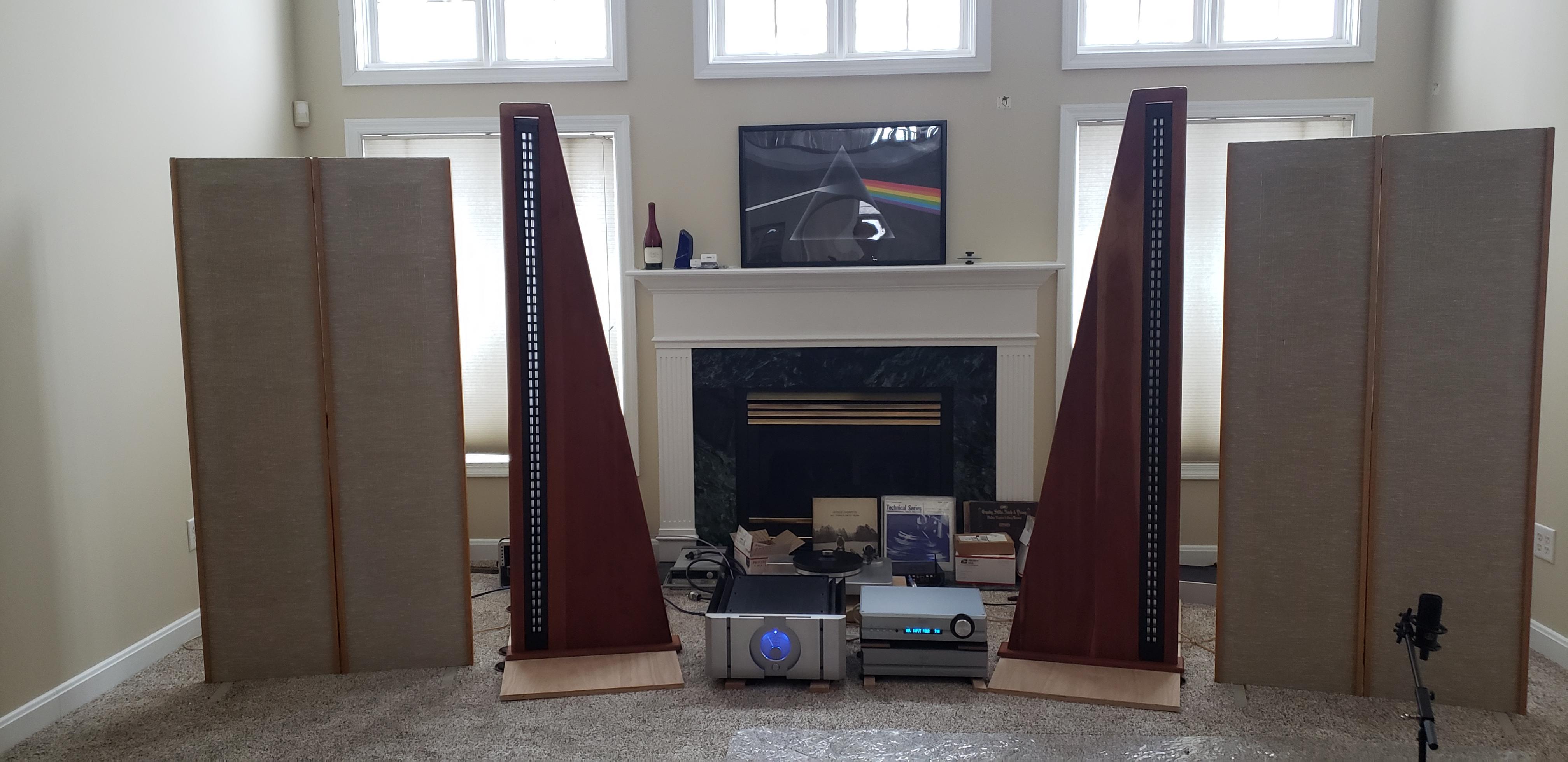

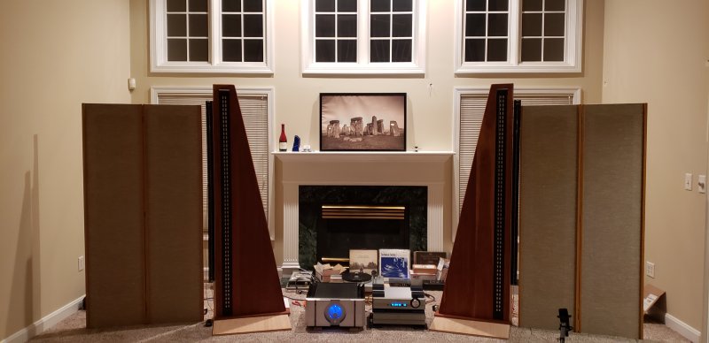

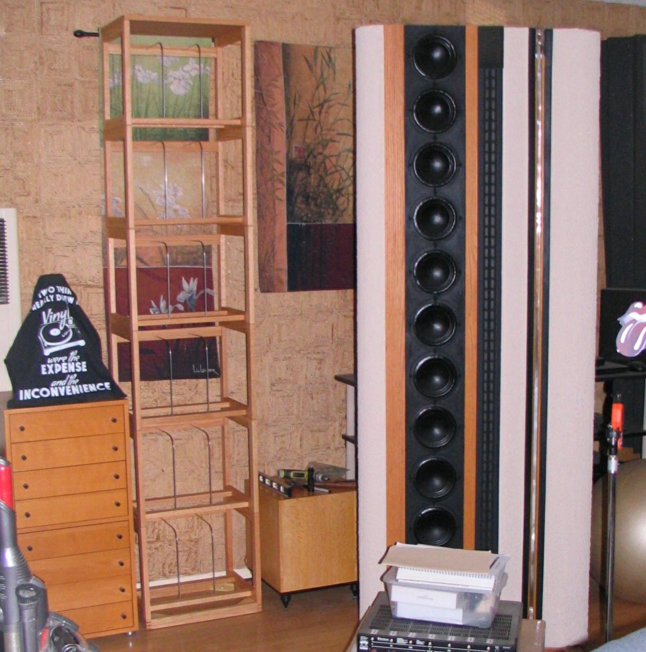

I only have two pair. One pair was in factory sealed boxes. A custom speaker builder had purchased them for a project that was later cancelled and they sat for like 10 years or so. They are the ones in the cabinets.
More than confused, you are mistaken. The two pair of Maggie panels are actually the two bass (technically a mid/bass and bass) panels from Tympani IVa's. I pulled the tweeters from the third panel and tacked them on the sides of the wings which have the RD75's. The RD-75's replaced the Maggie mid panels and they are spectacular.
I am looking (not very hard) for a pair of Tmpani IVa bass panels to swap in for the mid/bass panels.
I have a set of tympani iva's here and it looks to me like each side has one panel with the tweeter and a mid panel, the other two panels are bass panels. That's the way the external crossover box is set up as well- it splits the frequencies up so that the bass goes to the two panels and the mids/highs to the single panel which has an internal crossover to further split the signal. There is nothing inside the two bass panels to split the signal into bass and mid bass...So I am not sure what you mean above...

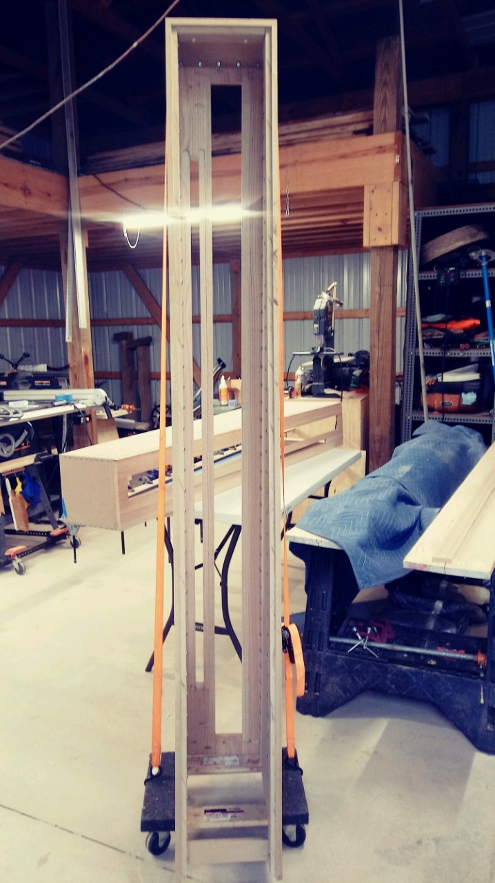

I plan to replace my two tympani bass panels with a AE dipole 18 in an h frame and a 4 sub set up, and use the tweeter in a new baffle with the Carver ribbons for the mid range. So I may have 2 sets of tympani bass panels I don't need...maybe you might end up with an extra pair of rd-75 ??? hmmmmm....lol...
The Tympani IVa has two differently tuned bass drivers each side. If you detach the mid/tweeter panel you will lose bass as the baffle width shrinks. Better to have the basses close to the side walls, the low bass drivers next to the walls. The two bass drivers are connected in parallel.

No that is not correct about the tuning. Tympani IVa looks like this without wiring. From left to right, low bass, midbass, tweeter and midarange. The order should not be like that, the tweeter/mid panel should be left of the basses so that the low bass driver end up in the center, taking maximum advantage of the baffle width.
That's what mine look like from the rear. I have my tweeters on the inside though...Thanks.

I was able to source a set of RD-50's so I will try them with the magnepan tweeter and the AE dipole 18's in h-frames. I ordered 2 3 channel Hypex NCx500 amps, hoping they arrive in July. Should have my test baffles together and playing with all this by the end of July. Can't wait!

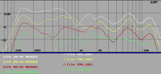

I’ve played around quite a lot with Magnepan 3.7s. Actually the bass panel is a very good midrange, with 10 dB higher sensitivity than the midrange panel and much lower distortion. I currently use the bass panel between 600 and 2500 Hz. The tweeter comes in at 4000 Hz. The mid panel fills the small gap between 2500 and 4000 Hz. Below 600 there’s a dipole mid bass system with four 12” Eminence Delta 12A, which is crossed over at 80 to a large double bass array. Yes - it’s a 5-way system. It’s active all the way, with MiniDSP Flex and Hypex amps.Thanks, I would appreciate that! I will keep you posted as to my progress...Once the Spring arrives I will be able to get back out to the shop and build the h-frames and 4 subs. I will try that with the Magnepan tweeter and midrange panel first, then build a baffle for the magnepan tweeter and carver ribbon midrange.
