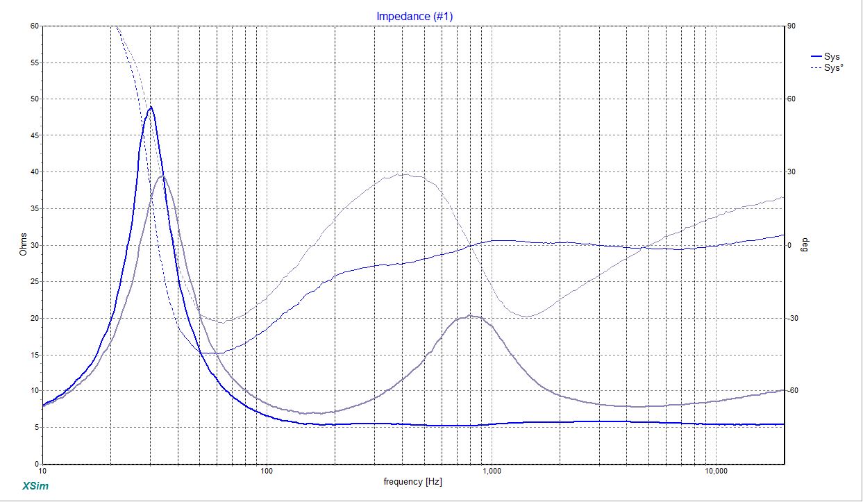

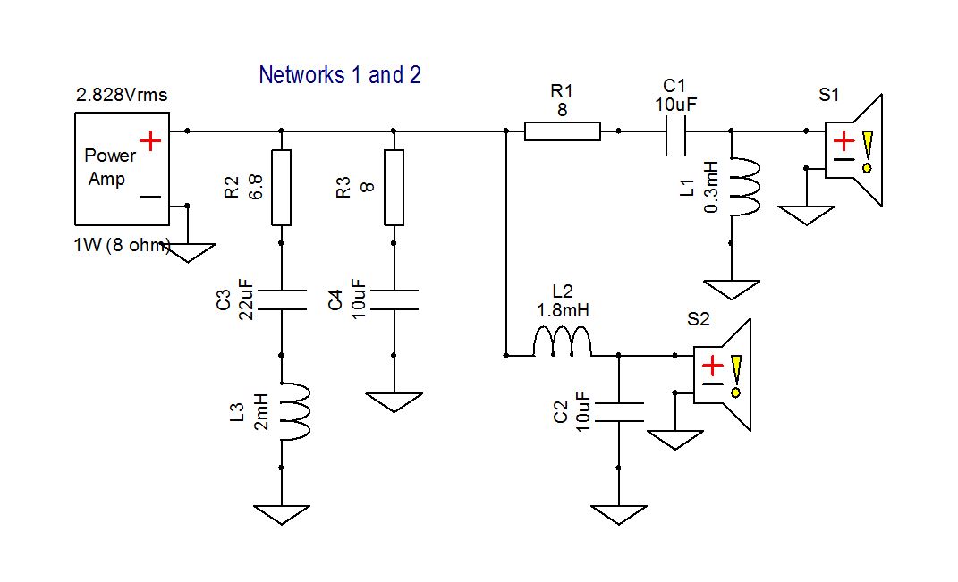

Thanks, matching amps to loudspeakers is very easy when your amp is not utter rubbish. Those with significant output impedance can benefit from flattening loudspeaker impedance as seen by the amp. These speakers have simple RLC and RC networks in parallel with amp out terminals tailored for exact impedance peaks. You can turn any loudspeaker with such networks into one that can be good partner to any amp, as long as nominal impedance is within acceptable limits that amp is comfortable working with. A dead short of a loudspeaker is obviously not our goal.

These networks can be physically placed anywhere you prefer, directly on amp OUT, or at speaker terminal IN from the outside of loudspeaker enclosure, or directly on crossover board where the low and high pass filters are, as long as it's electrically as depicted.
Lojzek,
When you speak of RLC and RC networks used to tame impedence peaks; are you referring to those implemented in the X over design?
Yes. Once upon a time, KEF implemented complex crossovers with networks like that, to make the impedance peak-free (I don't recall ever seeing measurements of the results). Their advertising quoted Richard Small as saying "We've made your amplifier twice as powerful!" and he got a lot of flak for it. Later on when I talked to him about that he laughed and said that yeah, perhaps that had not been a good phrasing.
What he meant was that many amplifiers have trouble delivering current into impedances with severe phase angles which many speakers have. The amps will exceed the transistors' SOA (Safe Operating Area),* distorting and/or going into protection mode. All kinds of evil things may happen at the outputs which are not good for sound quality or your speakers. The KEF setup would let many amplifiers deliver more actual power to the speakers. This is probably more relevant to receivers than to massive outboard amps. I don't think KEF does this any more, at least they don't market it, probably because the huge capacitors and inductors needed to try and notch out bass impedance peaks get really expensive.
