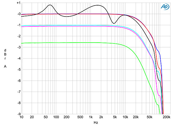

I agree, it actually does change a lot. That's a very easy thing to try out for yourself, use a woofer or sub directly connected to the amp with just the cable in it. Listen to it. Then insert a 0,2 - 0,5 Ohm resistor in series and listen again. It instantly gets a bit boomier and the resolution goes down aswell. Or try it with a simulation:
attachment.php
The woofer loses overall spl but between 45 and 90Hz only around 0,5dB while above it loses up to ca. 2dB. Or in other words, you get a 'loudness' effect of ~1,5dB. If you want to simulate it yourself, use a higher Qts driver (this one got a Qts of 0,47) to see it clearly, the difference is smaller on lower Qts drivers.
