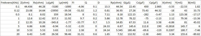

Hi
I have just measured my Loudspeaker (Royd Sintra II) with an LCR meter.
I got these values @1V
(KHz)___Z(ohm)____Rs(ohm)__Ls(µH)___Lp(mH)
0.1____44.436_____44.28____-5180____-1000
0.12___23.08______14.64____-23950___-39.58
0.5_____8.1________8.02_____359_____18.54
1_____12.6________12.42____337.3____11.92
2_____12.35_______10.26____-545.8____-1.77
5______6.86________6.86____-8.94_____-5.32
10 5.53 5.53 3.63 2.13
20 6.43 5.49 26.58 98.46
I'm a little bit confused about the value to chose for Rs .
I think I will use a 15µH inductor.

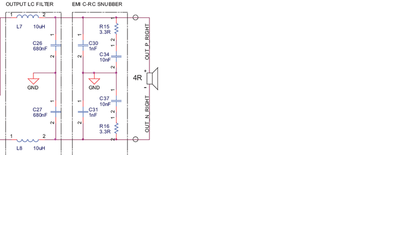

When I read about Zobel filter I can't find a digram that match the one for my amp(se attachment).
Please give some help🙂

There isn't one in the application notes.
Page 29 Iraudamp 7s:
"The IRAUDAMP7S has an RC network called Zobel network (R30 and C13) to damp the
resonance and prevent peaking frequency response with light loading impedance. (Fig 32) The
Zobel network is not thermally rated to handle continuous supersonic frequencies above 20kHz.
These supersonic input frequencies can be filtered out by adding R2 and C2 as shown on main
schematic Fig 33 and Fig 34. This RC filter works also as an input RF filter to prevent potential
radio frequency interferences."

IRS2092 designs from IR don't use a zobel network.
But my board has a TPA3116 chip.

But what about the Snupper(se diagram). Shall I use other values here or how do I calculate new values.
Or shall I bypass the snubber and calculate a new Zobel filter and use an adon board ?
Regards Bjarne
