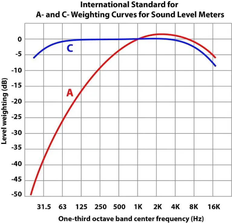

SPL meter says.." yes, but, as far as i know, most usual sonometers aren't they weighted "curve A" ? ... This A curve mean a non flat response, more or less following the human ears sensitivity curve ... "on risque de tourner un peu en rond" ...
"A weighted" is just an averaging method. There is also a C weighted, which typically yields a higher value. But most things are measured A weighted.
I think you are referring to the decibel scale being a logarithmic scale, which corresponds to how we hear. But the averaging method is "linear" on the decibel scale. So we don't have to do anything special to interpret an A weighted SPL measurement.
Yes, there are always details and nuance. But I think we are still drawing the wrong conclusions from the information!
Yes, SPL meters do not measure the full audible frequency range! They are not supposed to! The specs on the meter will tell you what frequency range it can measure.
DBa is a standardized, representative measurement used for pretty much everything. Someone decided that a limited frequency band represents the entire freqency range well enought that it is not necessary to measure the entire audible range!
Now, if a person calibrated their subwoofer with an SPL meter that only measures dBa, their result would be hilariously wrong! But nobody does that, right?
I hope we all use a calibrated measurement microphone? With a calibrated microphone, you know that the measurements are correct relative to each other, but by default we don't know if the actual SPL is correct. To find out the actual SPL, we reference a dBa SPL meter...computer plays a tone specific for a dBa SPL meter, and we input the value. The computer makes an adjustement, and now our measurement mic is calibrated to give us accurate SPL across the entire range, even at frequencies the SPL meter can't detect.
When I posted about listening at low levels, I also switched my SPL meter to dBc. It gave me a different number, but the relative difference between the music level and the ambient noise was the same! Everyone is accustomed to dBa measurements, so that is what I used!
