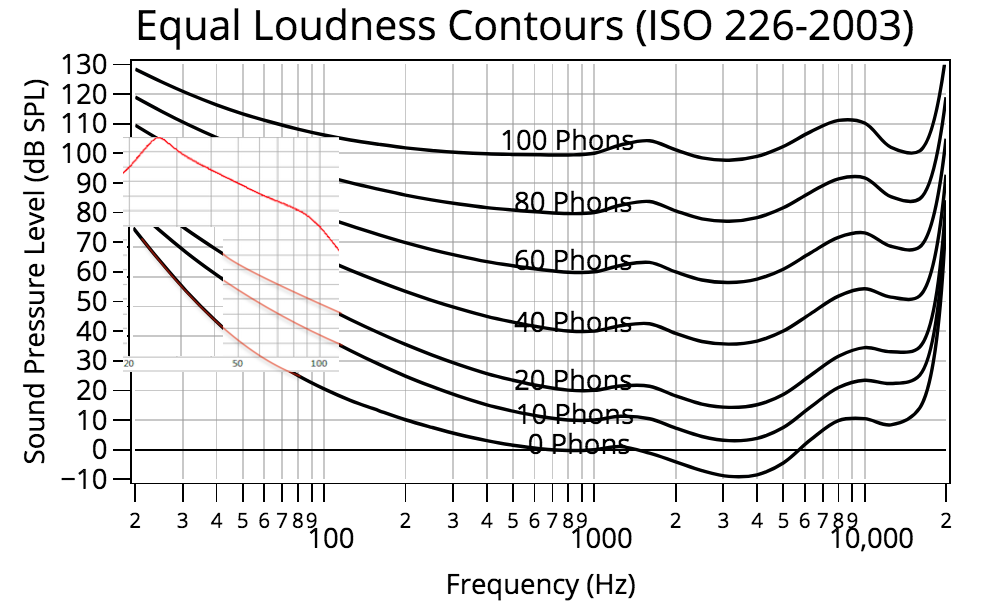

When designing a sub should I aim to get the SPL graph to match the equal loudness curve? That's what I was doing initially while trying to design something useful for a cheap driver. I didn't have much hopes for this driver, but found a design that should work well. It matches the equal loudness graph from 27-80Hz for 60dB listening. I wanted to compare its simulated performance to something, and having looked up a 15" Hsu sub, they show a mostly flat graph that slopes down as the frequency decreases. They should know what sounds good, so am I doing it wrong?
I don't know. I thought the point is to compensate for our subjective ears, but then part of that is up to whoever edits the sound track. As for nature, it depends on how efficient the source is at exciting a particular frequency. After further thought, it makes sense for it to be flat with the option to boost or buck a little. But then again, non-amplified instruments tend to lack in bass naturally. I know there have been some times when I listen to very quiet music just before sleeping, and that equal loudness curve matches what I think I'm listening to; 50-60db in the deepest bass, and almost nothing in the upper mid range. It is annoying when someone way over compensates bass in the recording or when it's almost nonexistent below 200Hz as in some recordings I found from the 70's

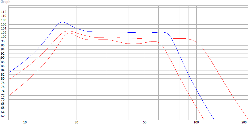

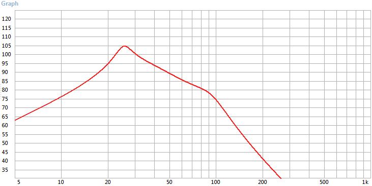

Without having checked any other software, this is the best I could get the MCM 55-3234 drivers to perform according to my preferences. Now I just need to run these designs through a subwoofer specific software to see how it matches up since WinISD doesn't consider how port characteristics affect SPL. I have these drivers sitting around in their box still with the hope of one day adding them to a 15cuft ported box that doesn't perform how I'd like (because I just built a box and put speakers in it with no simulations), but now I know that would make the problem worse.
4th order bandpass with 1, 2, and 4 drivers with the low pass and bass boost filters found on a plate amp keeps the size reasonable: 6cuft for the 2 quieter curves, and 10cuft for the higher, with that one having headroom for another 1kW peak output while the others are limited by excursion.

The correction you need is the difference of this curve at the level it is played versus the level where it was intended to play ( basically at what level it was mastered)
Something like this:

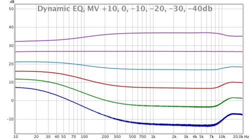

I use it in the form of dynamic EQ as executed by Marantz Audysey and I must say I am happy with it and don't recognize any of the above.If the low frequencies are boosted for "equal loudness", you will get ear fatigue. It isn't natural. It isn't good for your ears. It's better to train yourself to recognize what a correct frequency response sounds like.
There is no correct frequency response, it is dependent on your listening level and at what level the recording was made.
If they are not the same you perceive a frequency response that is offset-ed by the deltas in the equal loudness response for these levels.
