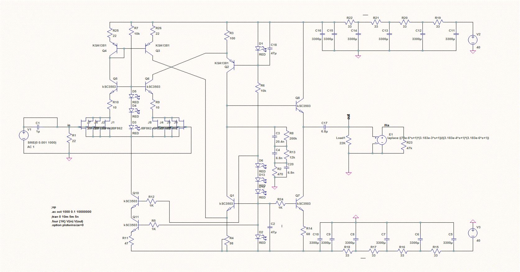

Here it is......
I have no idea, I made for a power amp... hence the big transistors. The Riaa developed along the way, as I could see the gain-bandwidth was very high.. This was really the start of the persue of a one stage Riaa...that with JG and me collaborating on the paradise. This here the oneshot had all the good things from the paradise, the natural distortion distribution with lower distortion with higher frequency. Only thing is the noise and that it's merely a concept not a final circuit.
But made with the steep low noise fets, it can be a good contender.
one very good reason, we opted for bipolars...:) and we got into mirror type circuits. The onestage came from here, the input from JG's circuits..
In all a fruitful combination. There was never the intention on making a balanced input. more to do the best we could with the combinded knowledge we had.. also we wanted easy to get parts. so that it was possible to build for "normal" DIY'ers
And Stefanoo, we did not want to make the End Of Life phono stage. Just something good and innovative. That brings in a lot of new people into the game. That it got as good as it is plus extremely affordable and success guarantied happened because we all crushed our crowns and worked as a team.
Did you end up building the power amp with this topology?
No. this remained just a study, I drifted into CFB for power amps. Now looking at this again, I see fantastic options for forming a CFB structures around it making it into something spectacular. But that is another story.
Now the balanced input, novel folding and JG's special Jfets is on the table, something good in terms of a Riaa should be possible. Wonder if one could find a model of that Jfet, sure somebody somewhere must have made one...:)
