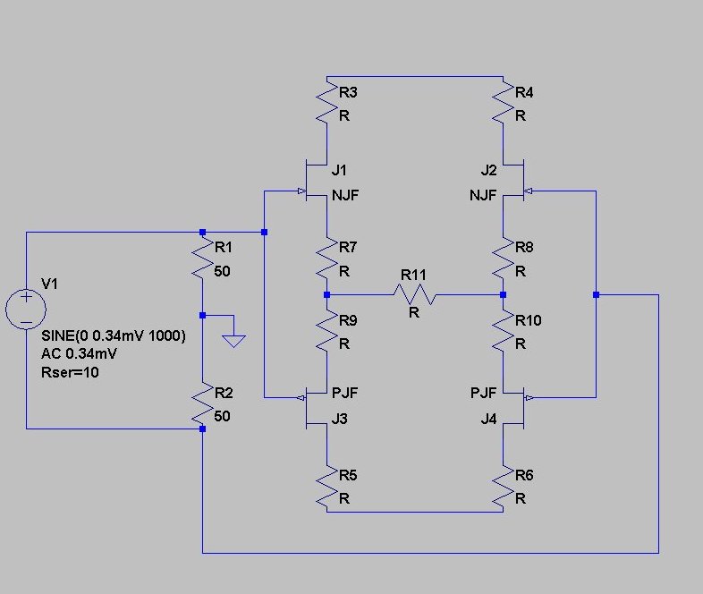

You could also make a parallel symmetric long tail pair with P-Channels on the negative side. That would have 3dB noise advantage over a single N-Channel long tail pair.

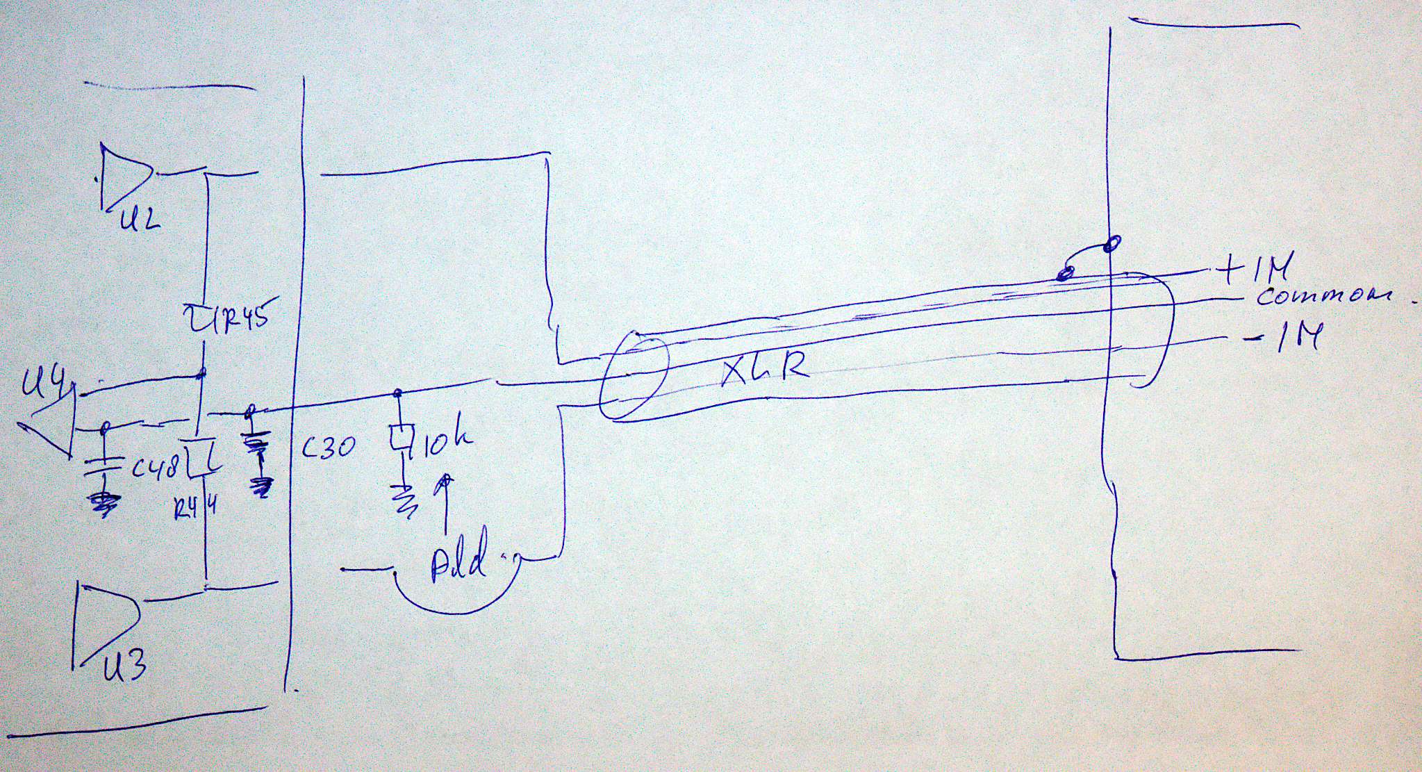

I am not an expert of servos and I might not understand the way you intend to use that circuit (maybe here a drawing could help) but, if I am understanding right by connecting the input to GND, you are actually using a differential amplifier to sense the common mode ouput offset and injecting it back to the stage.
If my understanding is correct, then I am afraid that the authority of this servo control could be way to high to not only influence very low frequencies but a higher badwidht causing perhaps suppression of musical signal as well.
My two cents and I could be wrong f so, please explain.
Like in the picture, it would not fight AC differences between source and destination equipment, only DC (but I did read some ware, I think it was one of dself's books, that this can/will be helpful).
Cool to invent a cartridge with a center-tap.... Who will you find to build it for You....?? 🙂
Or do I misunderstand your schematic..???
The LTP has a common reference so you can use the cartridge floating....
Here is a possible revision of that.
Now the they are both referenced to the same poin LTP's style.

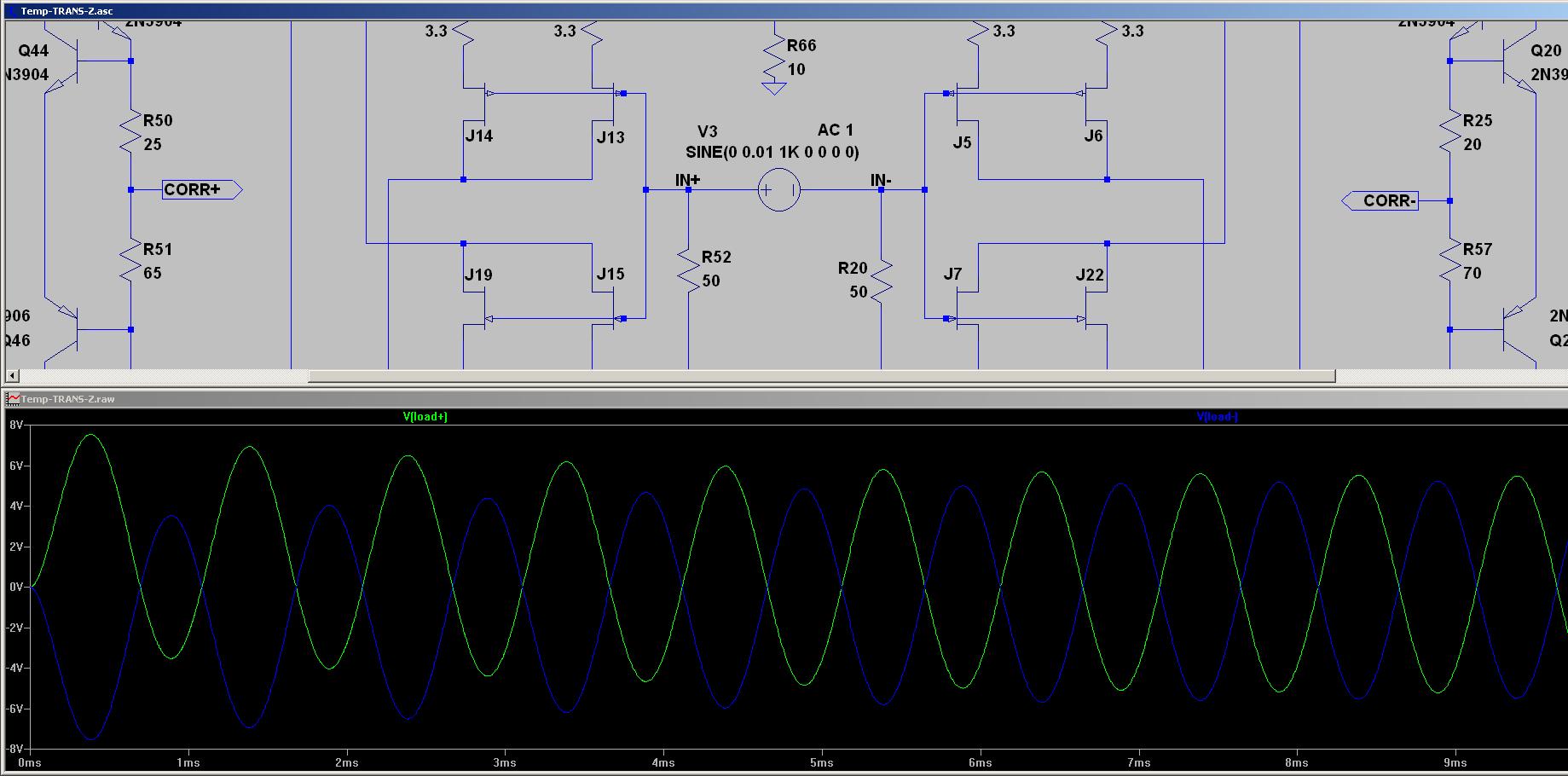

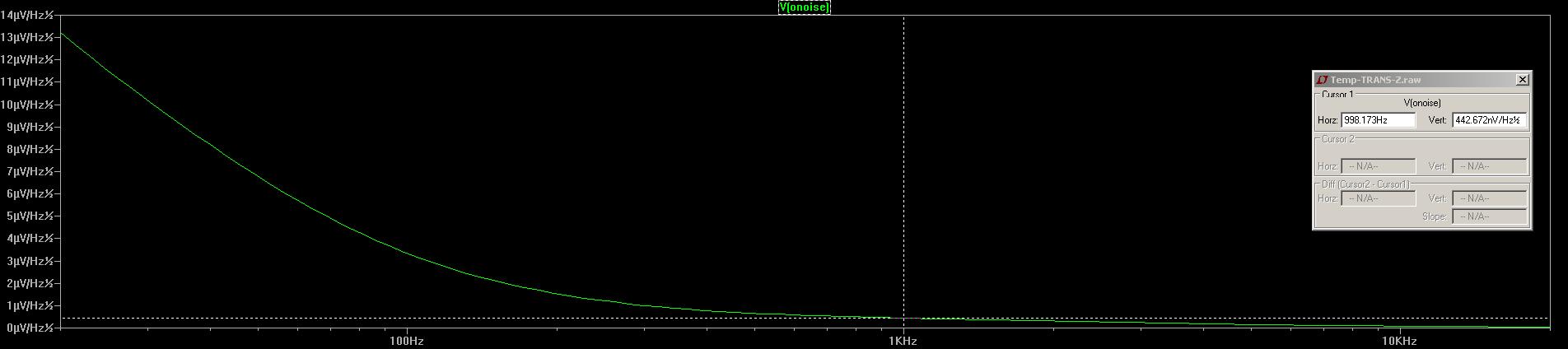

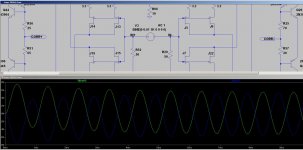

Here it is:
As you can see I have deliberately made the two side very different in terms of output offset however both sides are corrected down to 0.
In the first versions I would have gotten with this configuration a common mode offset.
In this arrangement, things change, take a look here.
Simulation seems to be set up properly thus I would hope that this is going to reflect the reality as well.
Here it is:
I'm not (yet) totally convinced, would you do the same simulation with both side a negative start offset (not one positive and the other negative). Already it looks better than I expected 🙂 maybe I should have given it a bit more time (but I do not have that much of it (time) 🙂).
