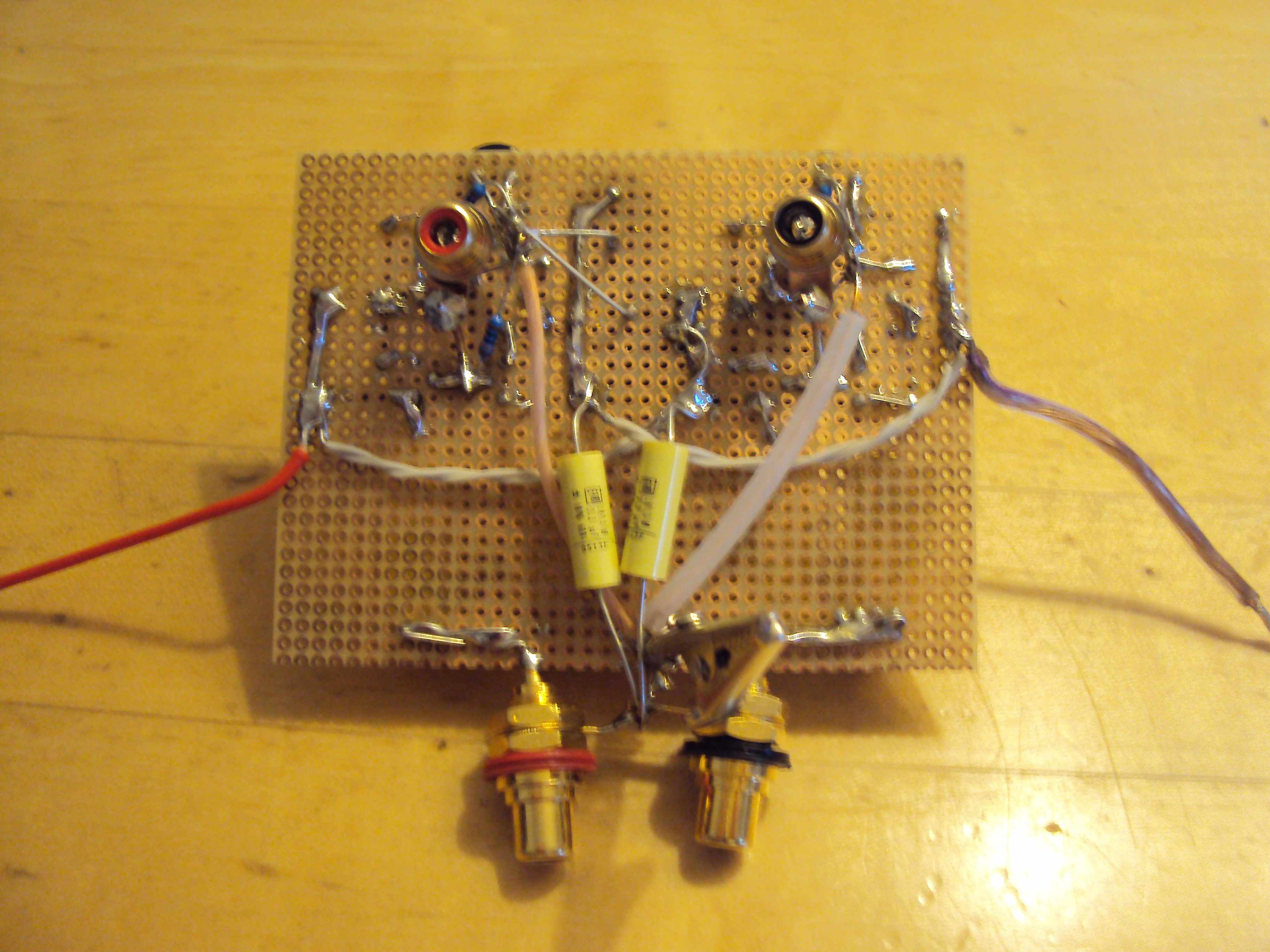

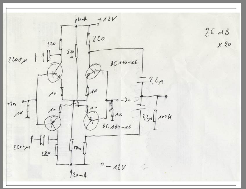

Here is the basic structure of the input gain cell. It looks very simple on the surface but works better then expected. The way i have drawn it, it is made for battery supply.
There can be many improvements being made, better PSU rejection by CCSs, lower noise etc. but try this before you draw conclusions.

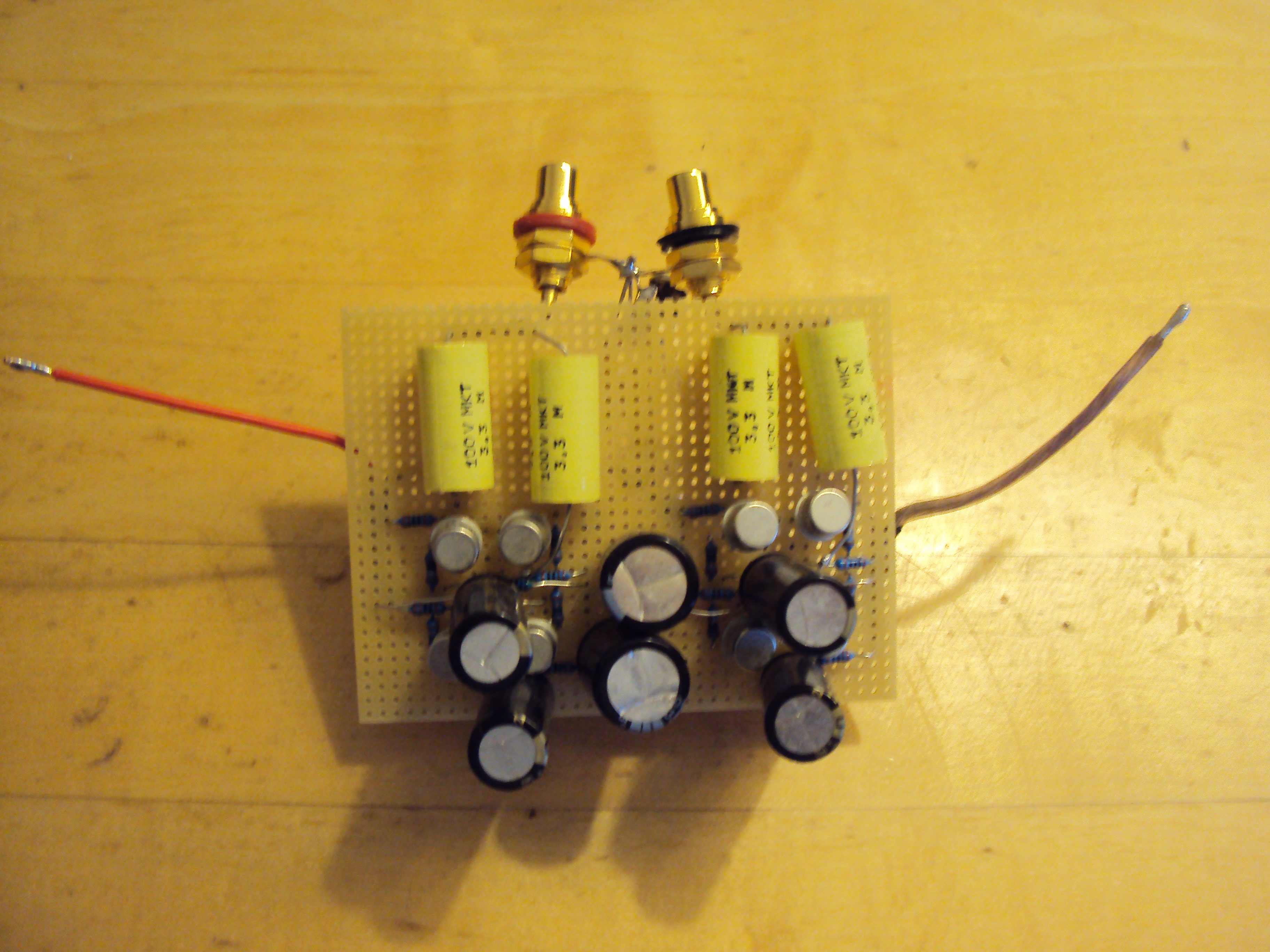

Here are the pictures....
Thank you very much Joachim:)
Wich Hfe the max. possible and all matcheds?
Hfe is not very high in this stone old BCs and it is not necessary in this circuit.
I chose them because they have very low noise and they are very symmetrical.
I was especially pleased with the high early voltage of the PNP up to high currents so this circuit can be driven with 10mA on each transistor. This lowers the voltage noise.
At the price of a bit more distortion the emitter resistors can be cut in half and also the collector resistors for a 3dB noise reduction.
DC cancels at the input to a high degree. The circuit also does bal-unbal conversion.
Yes, i matched Hfe. I can not remember but it was between 150 and 200.
