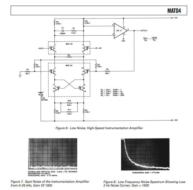

I would like to know your opinion if for this balance desing you think we should persue the scheme in rev 7 and try the InterFet device or re-arrange for a differential BJT kind of technology.
I am eager to see the Interfet at work, bipolar works anyway. That is always an option and i did it in the Paradise.
See an even better bipolar low noise circuit. Forget the post before.
that is an interesting circuit.
If you are eager to see the Interfet at work then let's continue with that path.
The only thing is that I am concerned with gain.
With 750mS dual package there shouldn't in theory be any issue with reaching out the needed gain, it's just that on simulation it looks like a huge amount of current is required.

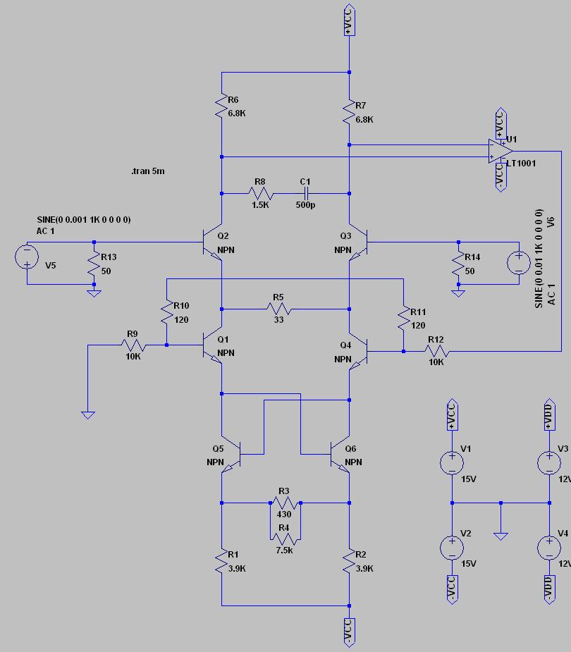

Joachim I am trying to get this application circuit working on spice but it appears not to work.
I am attaching the picture of the simulation, I am sure I am missing some stupid connection or something.
use this link :http://gcheney.eng.uml.edu/Courses/Fall2012/16565/mat04.pdf
