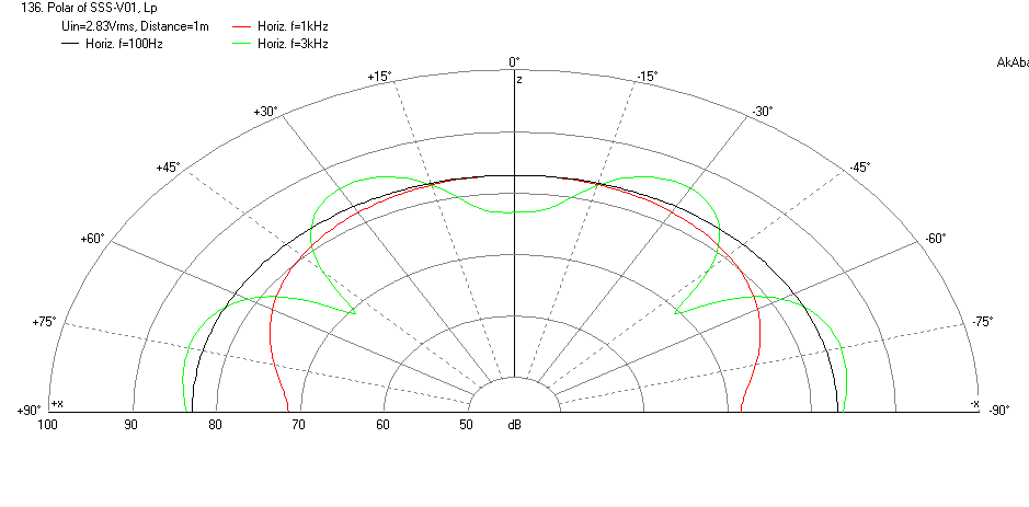

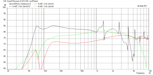

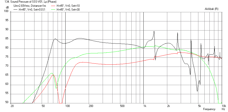

Sim of 3-driver SSS
I am trying to get a better understanding of how the resistor and capacitor values in the psychoacoustic filter affects the polar response so that I can set the values with some semblance of analysis rather than guessing. Akabak cannot model the side wall reflections so this is really just to understand what the sound field looks like from the speaker in open space. I can turn reflections on but that is only back wall and floor - no sides.

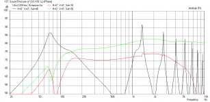

The simulation is for a 3-driver (Vifa TC9FD) SSS with 45 deg side-firing drivers and bottom mounted reflex port. I wired the psychoacoustic filter as I have it built currently with 5 ohm and 4 uF capacitor. The sim assumes the signal is evenly divided by driving both the right and left channels in parallel, the matrix circuitry takes over from there to feed into the single center driver and bleeding some power off through the RC filter.

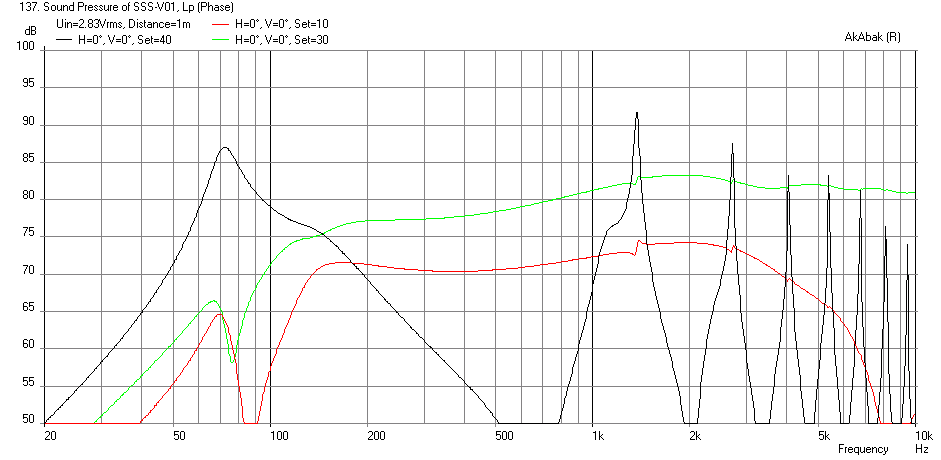

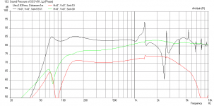

Here is the frequency response of the individual drivers and port (right, center, port):

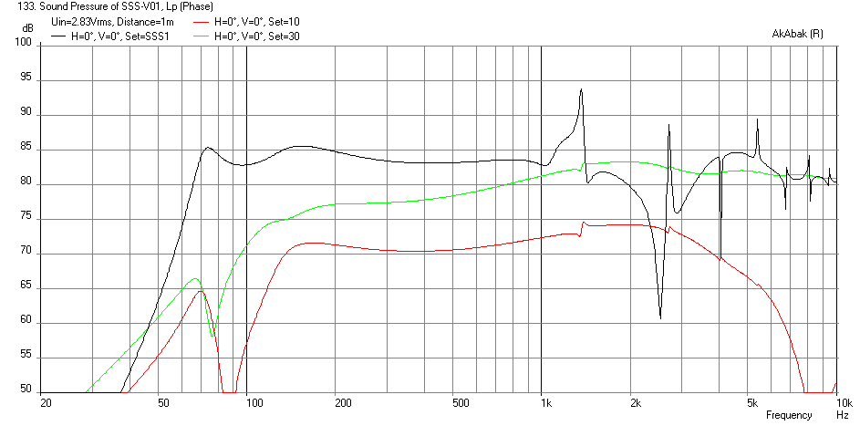

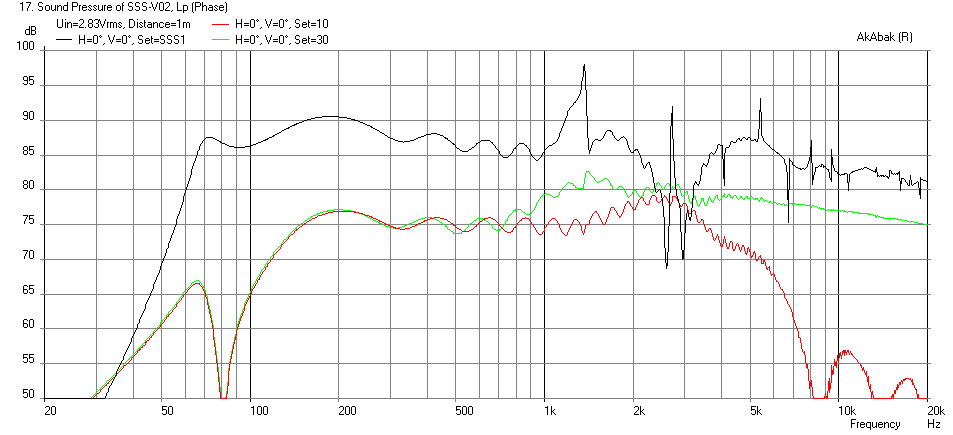

Here is the frequency response at 0 deg on-axis (total - black, front -red, side - green):

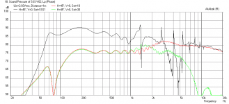

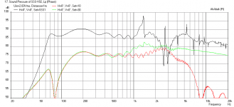

Here is the frequency response at 45 deg off-axis (total - black, front - red, right side - green):
As you can see, the port output indicates there may be leakage at higher frequencies (which probably will not be as bad in reality as there is foam lining and stuffing inside the box to absorb much of that).

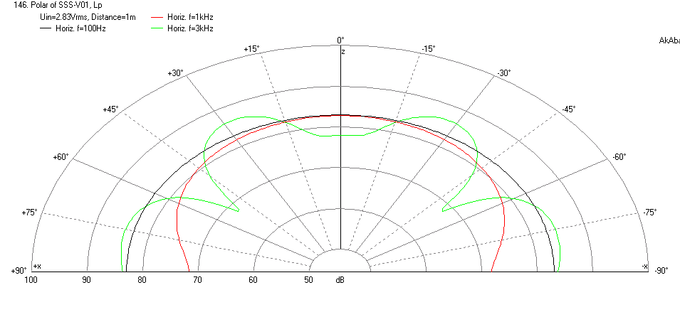

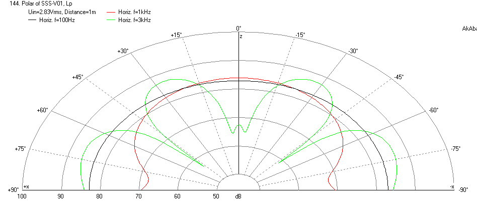

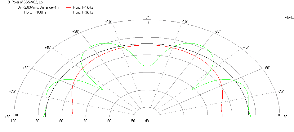

Here is the polar response (100 Hz, 1 kHz, 3kHz):

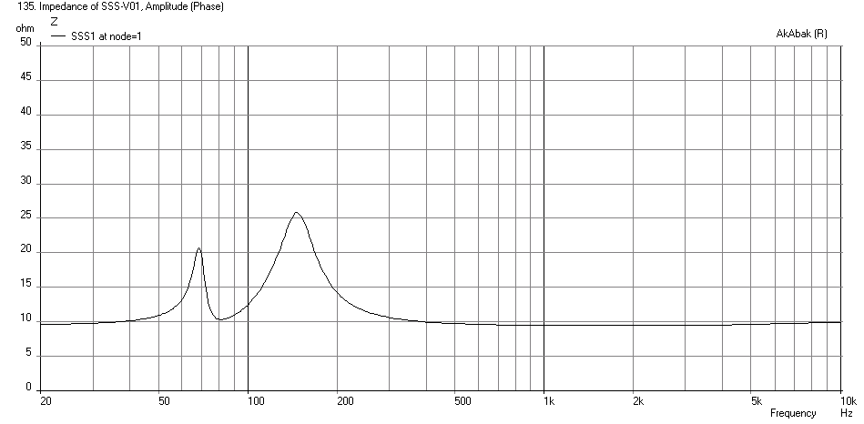

Here is the impedance of the system (for a 3 x 6.3 ohm driver system it appears to be a nominally 10 ohm total impedance):

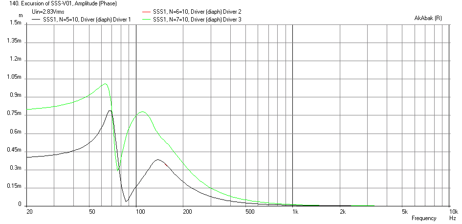

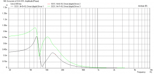

Here is the cone displacement:
What I am seeing is that the middle driver has about double the excursion of the sides and this probably indicates it would be a good thing to have another driver in the middle channel (for a 4 driver system as Nagaoka had it) to keep all driver cone displacements under control.

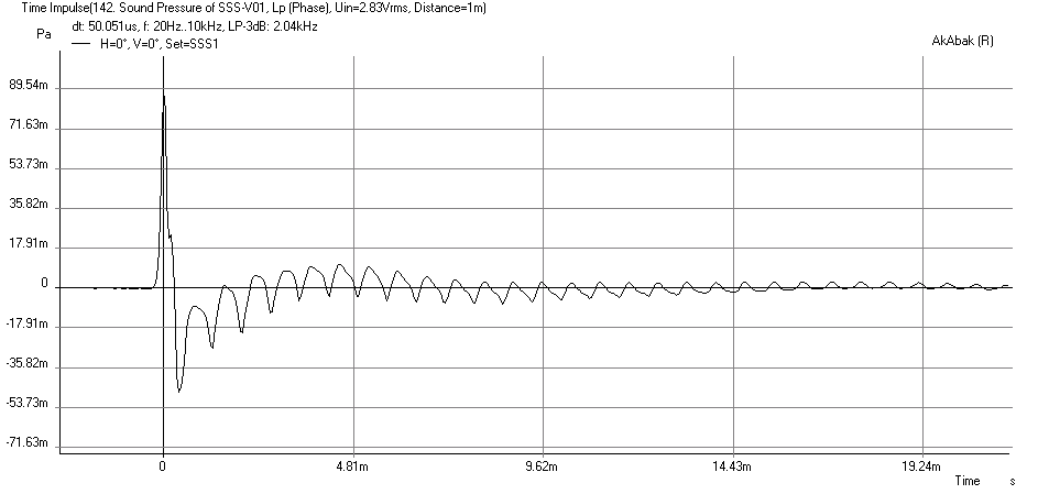

Here is the impulse response:
I think that the IR oscillations are due to the fact that I don't have the box properly damped in the simulation. Decreasing the Q really cleans up the oscillations.
So the point of this was to give me a tool to play with the values of the psyhoacoustic filter. If I set the capacitor value to 10 uF, the polar plot looks like this:
Here is the response with the psychoacoustic filter bypassed (all current going through center channel):
All the lobing present in the polars indicates that this speaker is not for near field use - you will hear what is essentially large scale comb filtering effects as you move your head about or walk about near the speaker. However, in a suitable room with sidewalls that reflect those lobes and re-form them to a central image farther away, I think the sound will be more uniform and the apparent sweet spot will be larger.
The next thing to explore is the angle of the side firing drivers (90 deg, maybe even backwards?).

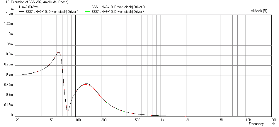

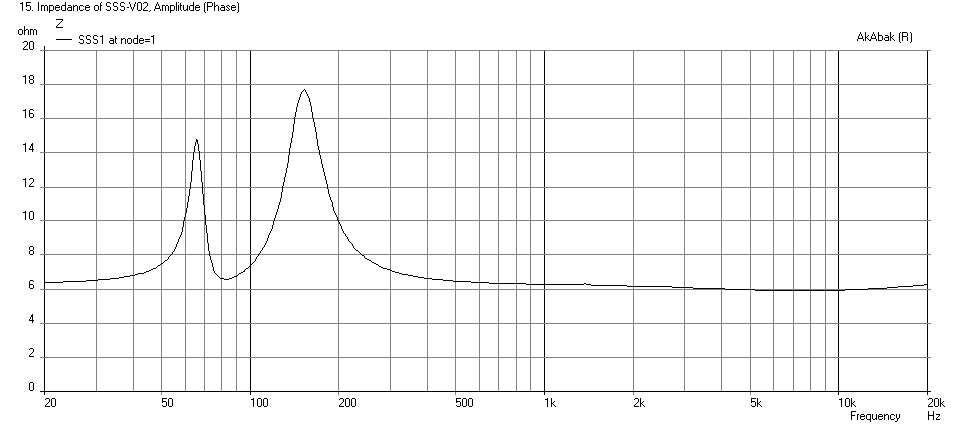

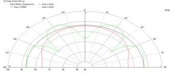

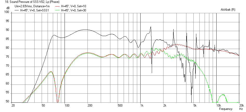

4-driver SSS sim

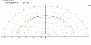

In seeing that the excursion of the middle driver was so much higher than the left and right, I added a 4th driver in the sim so that the two center channels are now in parallel. This helps a lot as the cone excursion is now identical for all 4 drivers. I have turned on wall and floor reflections with the speaker mounted flush to the back wall and driver centerline at 48 in above the floor.
Here is the new cone displacement:
This is the frequency response at 0 deg (on axis):
This is the frequency response at 45 deg off axis:

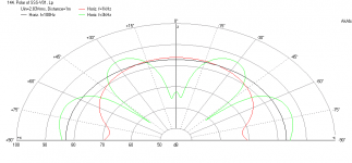

Here is the polar response:

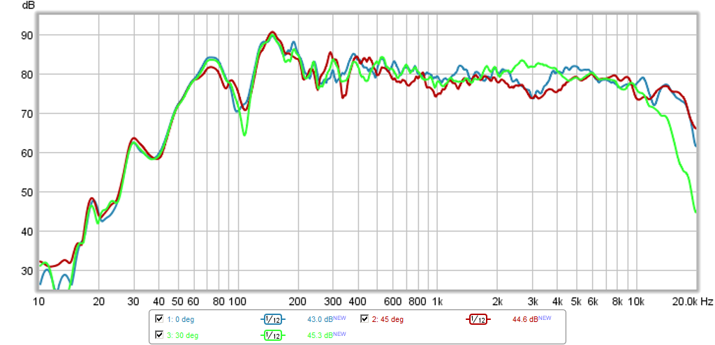

Measurement of SSS
Mic at 1 meter away, speaker 2 in from back wall at 50 in above ground sitting on top of amplifier deck (which may be causing bounce dip).
0 deg, 30 deg, 45 deg. The response in the mid to high freq is pretty flat and bass reaches 70 Hz as predicted. The +10 dB peak at 150 hz may be a problem though - not sure what it is caused by. Also, no BSC needed as predicted.
