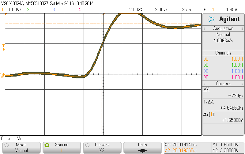

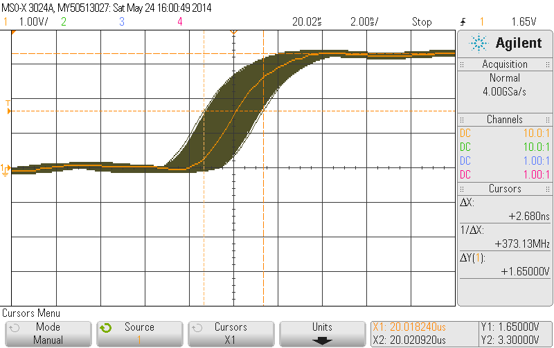

I have just measured the jitter on the MCLK from the USBStreamer. I used an oscilloscope set up to trigger at 1.65V and with a pre-trigger of around 20us (roughly one sample at 48 kHz sampling). I have used infinite persistence to record the peak to peak jitter. The result is not directly comparable to other measurement methods. But it certainly gives an indication of the jitter level. I assume that the jitter on the Toslink/ADAT output is the same plus the jitter added by the optical transmission.
The result is a peak to peak jitter of 2.68ns. The jitter does not change when changing the sample frequency from 48 to 96 or 192 kHz. This is not surprising since the MCLK is the same.
For comparison I measured the jitter on my latest design, where I use low phase noise crystal oscillators from NDK. The result in this case is 220ps peak to peak. I think this approaches the limit of the test equipment/method. So the actual jitter is probably lower. There is some ringing, but that is just due to the non-ideal oscilloscope probe wiring.
With the Master clock and isolator I feed this low jitter MCLK back to the USBStreamer.
