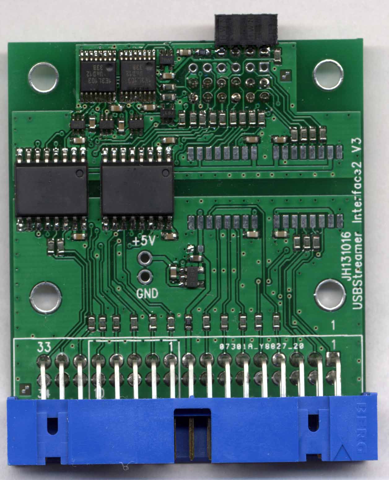

Here is a scan of the V3. V5 will be very similar.
On V5 I decided to remove also the local 3.3V regulator, since it can be supplied from the ADC/DAC board. The optional PLL is placed in this area, just below the middle of the PCB. In the top area the added mux has been squeezed in.
The V3 has space for additional isolators, but, as shown in the picture, I haven't mounted these, since I only needed a 2-channel version for now. And I have a limited number of isolators on hand.

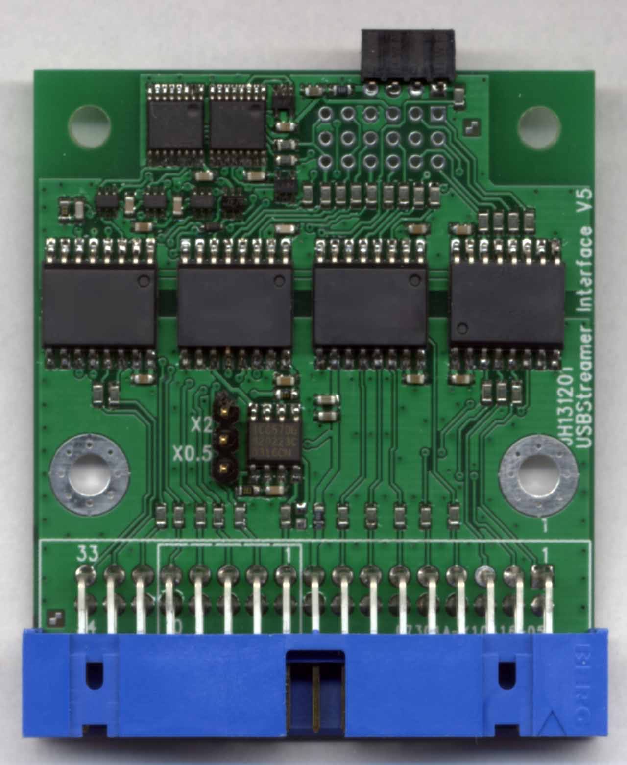

V5 is now up and running. The mux on the USB side seems to work as intended. So when the power on the isolated side is turned OFF, the USBStreamer just gets its own MCLK back and there is no lock up problem. The transition seems to be smooth with no (apparent) interruption in the playback.
The PLL has only been tested briefly, but it is in the circuit and seems to work OK. Next step is to try it with a 12.288MHz clock input and X2 operation, so that the USBStreamer will still get 24.576 MHz.
I don't have a 45/49 MHz design to test it with, but I don't think that this will be a problem.
On this version I mounted all isolators to get 8 channels in/out. I decided to use one of the cables, which came with the USBStreamer, to connect it to the USBStreamer. On the previous versions I used a connector with an extension. The cable provides more flexibility in terms of positioning the interface and the USBStreamer in a box.

I have just made a test of the V5 with clocks of 11.2896/12.288 MHz, using the PLL to generate 22.5792/24.576 MHz. It works as intended.
No, the SCLK and LRCK still come from the USBStreamer. So the USBStreamer is still the I2S master.
Only the MCLK is "injected" into the USBStreamer from outside. This part is not described in the manual, since the USBStreamer was not designed for that. It requires a HW modification.
