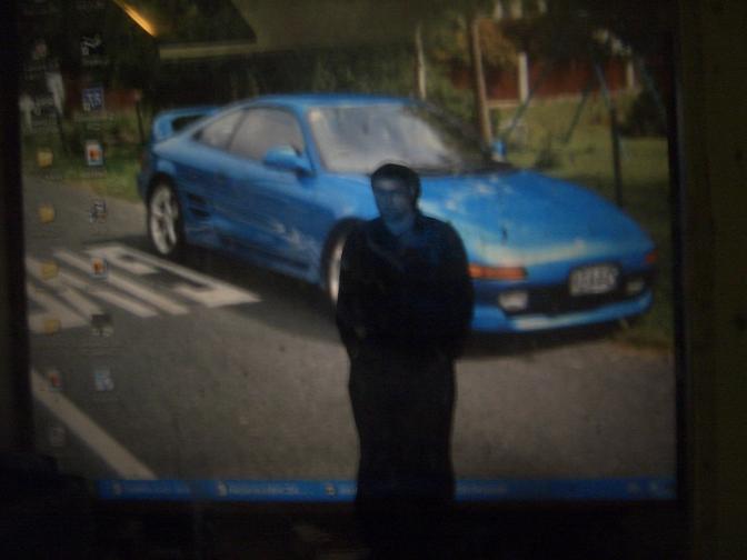

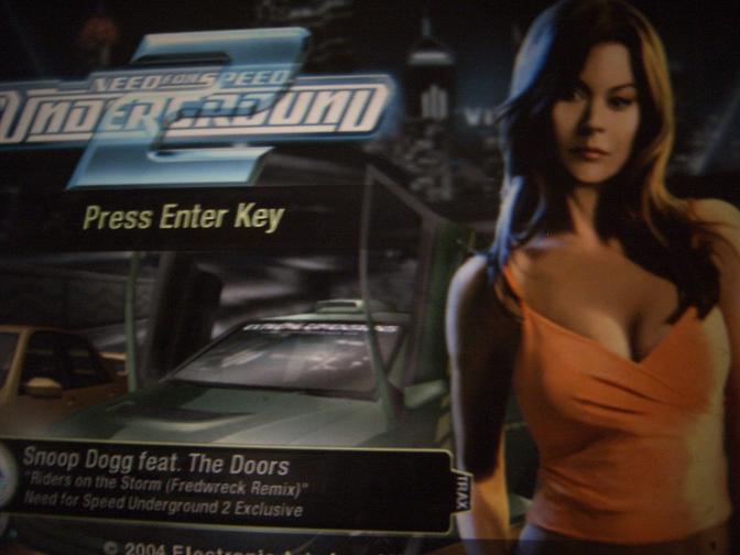

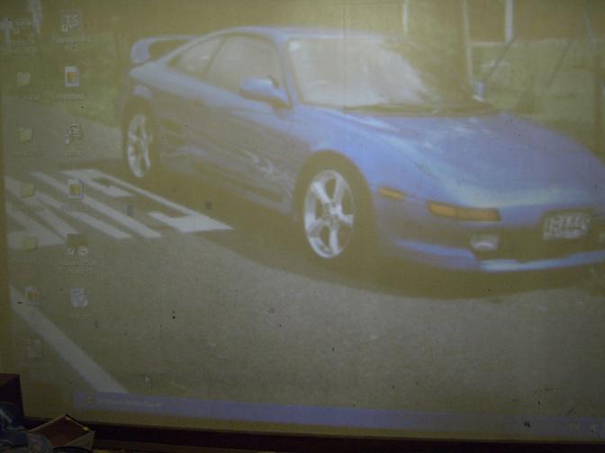

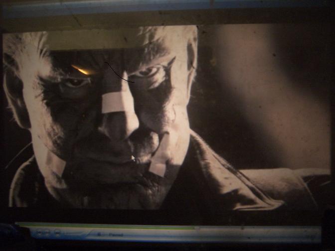

Finally a proper camera to take some pictures, all be it a bit out of focus cause im not quite upto standard on using the camera but anyway.
Lumenlab fresnel lenses, lumenlab projection lens, DIYLABS 400w HQI bulb and icecap ballast.. Viewsonic VE150 LCD (1024x768/30ms/300:1)
180" onto a off white wall... projected from 14ft or so through a window hehe, pictures were taken through a window too, couldnt get back further enough to get the entire screen.
Lights off, and my bed blocked the bottem left corner.

nah its fine sitting at the back of the room, bout 4metres from the screen, projector is more so sitting on the varender to keep it out of the room, noise and heat, but the resuilting image is rather large.
and the projector just sits on the varander..
an acceptable brightness at that image size tho?
