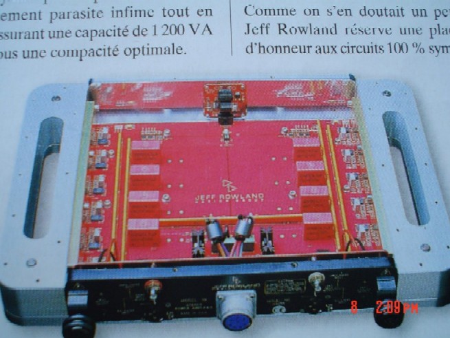

I am not an expert on Jeff Rowlands nice stuff, but if I recall correctly, he don't use DC-servos, but trimmer to fight the dc-offset issue. If this is correct, it means that the OPA213X, that "jacco" is talking about is for something else (most likely some kind of buffer/gain stage).
(and why is he in the need for a SSM2141, if the has an input tranformer ???)

Here are some pics of the M10.
Wow! 🙂

Hi Everybody
I was not the most active student in French at High school, but look/reading Jacco’s pictures it is not at all clear to me that the OPA2134 Jeff Rowland uses are for the servo. Since each LM3886 have its own trimmer I am pretty sure that the OPA2134 used is for “something else” (buffer ??).
Anyway, the picture of the M10 from Jacoo are very nice and it does make you start to “dream”. My dream would be to make something similar to the M10 (not to difficult). This would then have different PSU-options:
