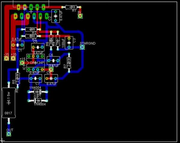

Nicks said:hi all again,
It seems to be hard finding the drv134 over here...
What about using SSM2142 from analog devices?
By the looks it should be the same thing (read same function).
Any comments?
It's a direct replacement. Go ahead.
Carlos
HI Nicks
You should make your your tracks that carry large current much bigger. And maybe you should also make "on-board" regulators for your op-amps, then you only have to supply the +/- 35 V and you seems to have enough space for it.
You could also make the hole of one of your layers GND.
Have Fun 🙂
THomas
Have Fun 🙂
THomas

Hi Nicks
Looks better, but your output-tracks and some of your ground trakcs have to be bigger(the last depending on how you connect your speaker).
I would make a on-board regulator for your op-amp. And the OPA134 is not the best choice for low off-set as you need.
Have fun
Thomas
Have fun
Thomas

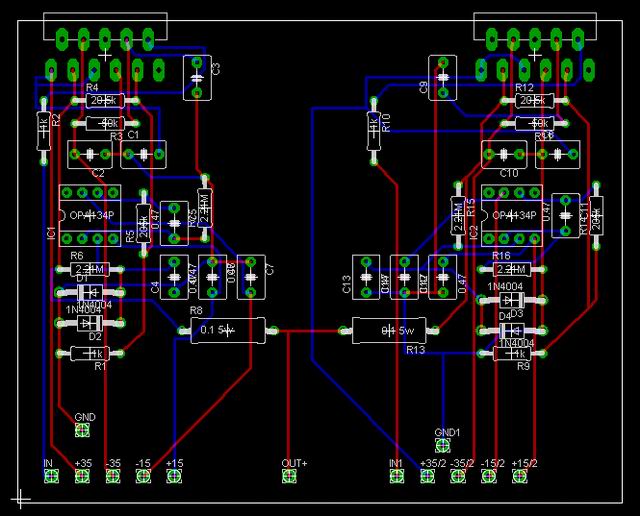

Tlmadsen, thank you for your support. 🙂
i was thinking of parallelling 4 chips on each side.
Then use the SSM2142 opamp to "split" the signal, giving 4 chips inverted signal and 4 chips noninverted.
Much like the BPA 200. but using 8 chips per channel.
so, i cant see the "need" for bigger ground tracks since the speaker never will be connected to it. I hope i am correct here.
which opamp do you recommend instead of the opa134?
Best regards
Nicks
Best regards
Nicks
Hello Nicks
I would say, do the output traces as big as the rail traces. And edit that footprint of the output resistor to get bigger pad to solder on.
OPamps, the expensive OPA627 or AD8610 perhaps, AD8610 is max +/-13V i think.
Hi Nicks
You are right about the ground track if you connect your speaker (-) straigt to your PSU. However having low-resistance ground tracks/path is always good for your design.
I take it from your PCB that the opamp in question is the one used for the DC-servo ??
Using a OPA627 or AD8610 is totally wast of money and I will be VERY impressed if you can hear any difference.
Use something like LF412 or AD712 (dual, so you only need one with your two amps on each board))
Have a look at http://www.diyaudio.com/forums/showthread.php?s=&threadid=19157
2 x 4 LM3886 will give you Power, but make sure you get propper cooling, otherwise you can't take advantage of all your LM3886 (and running at +/- 42 V DC is OK).
Have fun 🙂
Thomas
Have fun 🙂
Thomas
