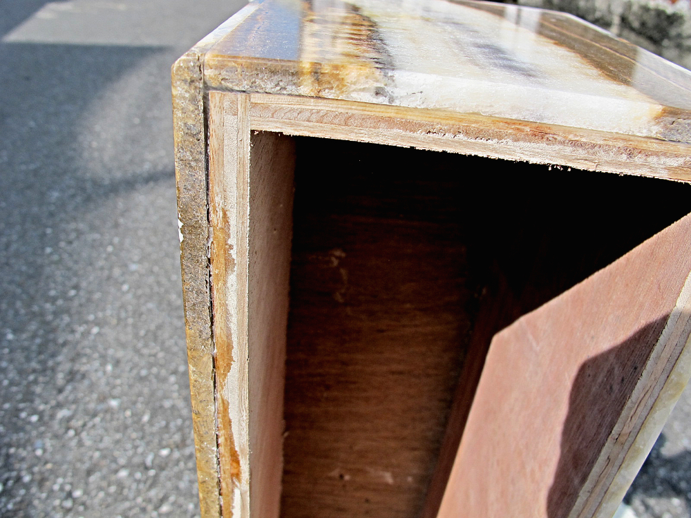

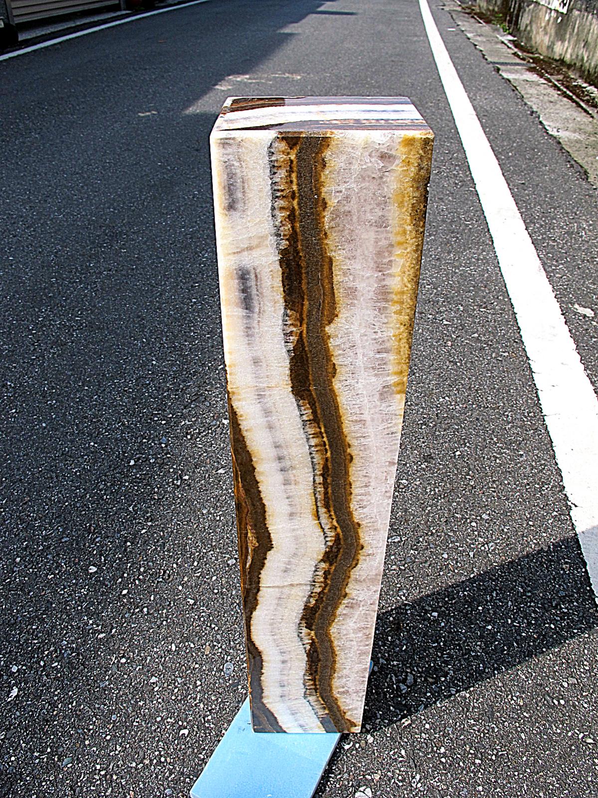

Marble does not have a great shear strength and 1.5cm is actually very thin for marble. The guys i get my stuff of don't even like handling 2cm - you have to remember is is a sedimentary rock laid down in layers. They have a tendency to brake along these lines. Granite is igneous and has an interlinked crystalline structure which gives it far grater strength.
I am just worried that all your hard work could easily be ruined in the future by a small accident cracking one of the panels.
As far as the isolation goes - super bouncy balls rock. Literally. The one downer is the only place i can find them is a bubble gum type vending machine in the sea gardens. There are the super bouncy one that are great for this job and solid rubber ones that are US. The ratio of rubber to super is about 6 to 1 against - so i now have a huge collection of 1" solid rubber balls. Everyone who visits HAS to bounce the ***** and inevitably looses them. Then my dog keeps finding them and choking on them.
Oh, I can find those superballs very easily around here. I'll give it a shot.

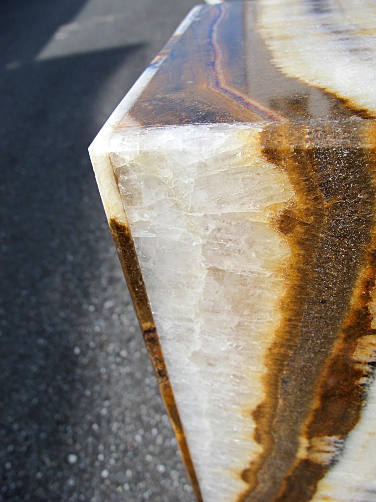

About the thickness of the stone. The factory I am dealing with can cut marble and even onyx down to 0.6cm. They are one of the very few factories in the world that can do it. Everybody else want at least 2+cm...
I'm going to get a test box made of onyx cut at 0.6cm. Hopefully this Monday.
For strength, they usually back it up (epoxy) with plywood, honeycombed aluminium, or a combination of both.
They can cut onyx down to 1cm without backing to install a light and have it lit from the inside. Would never work with a speaker because of the stuffing, but still, a very cool effect.
The balls are not necessarily well damped, they deform and return to their shape so they will be allowing the cabinet to move. The one thing that mass loading on the top of the cabinet, and these balls, seem to have in common is they alter the interaction of your cabinet with the floor.
Here's a prototype I got.
It is onyx, cut at 0.6cm, backed with a 0.8cm plywood. Beveled edges on all sides.
Total weight of one cabinet, without the wood baffle and driver is 8.7kg.
It is simply gorgeous.
