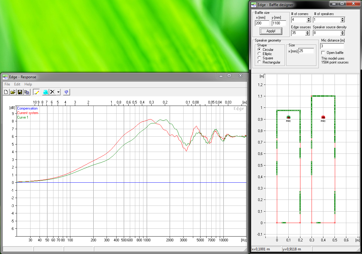

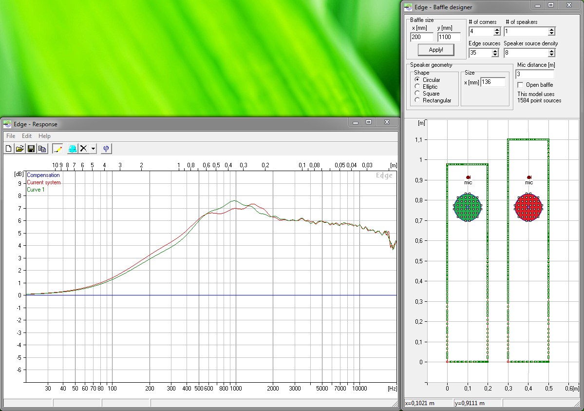

Did look bit into baffle and diffraction effects so we have some more data to look at in this regard to isolate from weight and tension talk, hope research data/math/methods used is right done and Stuck In Bulgaria can check if these settings is okay:
Normal baffle: 200mm x 975mm baffle with woofer piston 136mm (diameter middle of surround) at height 765mm, tweeter piston 25mm at height 912mm.
Baffle plus 125mm stacked granite at top: 200mm x 1100mm baffle with driver diameters and positions as above.
Started in The Edge make the two woofer and tweeter scenarios seen in attachment 1 plus two and exported those four responses as frd-files.

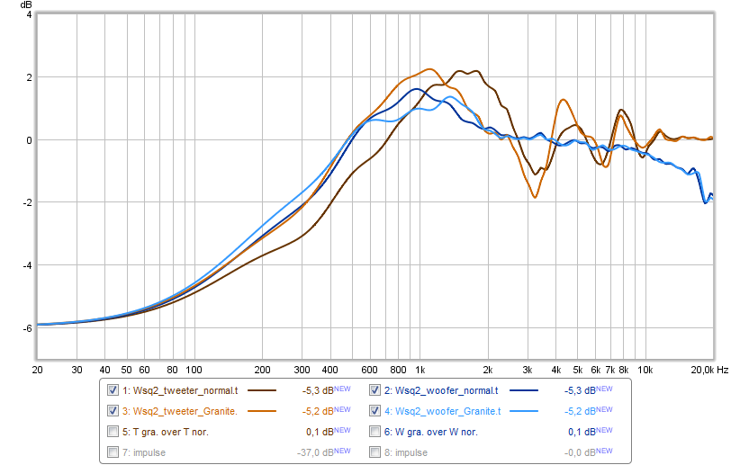

Imported files to REW to later do some math here is overlay of them four ones:
attachment.php
This plot should be the exiting one and tell difference for response with baffle set 125mm higher verse normal.

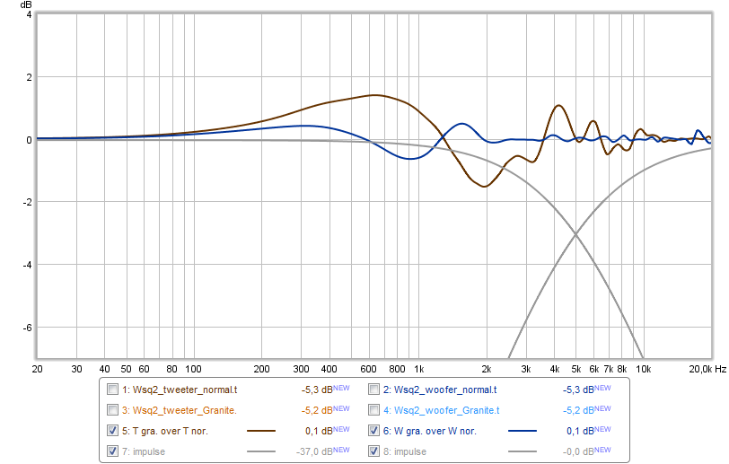

Math used was let REW output (Granite / Normal) for tweeter (Brown) and woofer (Blue) and we now see that

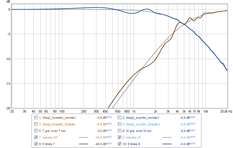

isolated response change and as help to mind added the 1st order 5kHz XO point. Think about what we don't know
is how real response was with normal baffle in situation for particular living room but below should tell the new EQ
corrected response:
