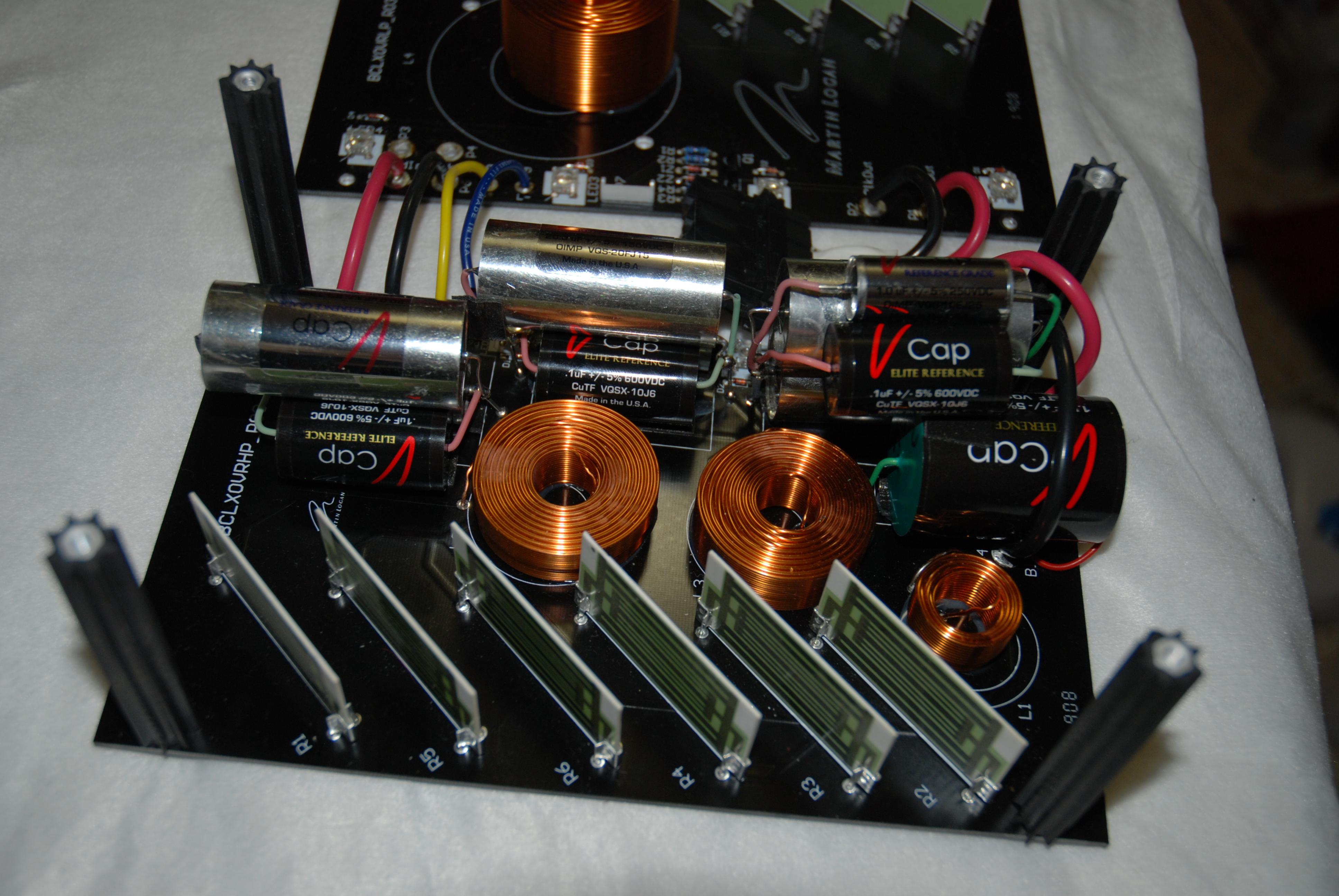

The Solen was a 250 volt cap not very big - look up the dimensions of that cap . Whatever you use will be bigger, - there is also room on the LF crossover board to mount more caps. A single 22uf maybe to big to mount where the Solen was, and you might need to use a combination of smaller caps to fit ( like I did) . If your going to change just the main coupling cap you could outboard it externaly inside the speaker's base and just lift one lead from the Solen.
Jantzen is about double size of the original Solen.
C1 Solen 22uF 400V removed from circuit board.

Jantzen hot glued to circuit board from one end then reassemble the crossover and hot glued the other end of the cap. Now it's sort of sandwiched between the circuit boards. Warning, Jantzen has aluminium frame tube so it must be installed clear and insulated from other components.

Populated with V-Caps
C1 and C2 (22uF): 20uF 150V OIMP + 2uF 250V OIMP + 0.1uF 600V CuTF
C3 (33uF): 20uF 150V OIMP + 12uF 150V OIMP + 1uF 250V OIMP + 0.1uF 600V CuTF
C4 (1.5uF): 1.5uF 300V TFTF
Each individual V=Cap was measured and larger values built up to match original Solen values (in brackets) as closely as possible.
As can be seen in the photo, there is no additional room, even to bypass C4 with a 0.1 600V CuTF.
Next modification will likely be the power resistors.
And no, I haven't yet measured the inductors since sketching the x-over, sorry.

Good job there :cheers:
Let us know the results if you do measure inductors as well. (R & L)
I consider C1 and L4 to be the most critical components in the circuit as this is almost first order crossover. All other capacitors have series and or parallel components so the sound signature is not only that of a single component. Most of the signal (level) ending to the drivers are passing straight through C1 and L4. I have no doubt that careful selection of each component will result notable improvement but still ML has done a good job to begin with. BTW I thought this kind of thick film resistors are quite optimal with extremely low sound coloration. What are you planning to use instead?
Complete rebuild of crossover would probably require making an external crossover unit as size of components are likely to be bigger the original.
Initial impression with modification is increased resolution and cleanness. Was bit concerned about overly brightness based on what I read about Jantzen silver cap but actually it's pretty smooth and even more "solid" sounding (maybe even more dynamic?) than Solen MKP. I think bigger caps (uF) are generally less upfront sounding than same caps in smaller size (capacitance).

I would agree C1 is the capacitor to replace if you are only going to do one. Similar for L4.
I am considering using paralleled Duelund 10W CAST Carbon/Silver for all except the series parallel combination of R2,3,5,6 (value 5R1). All reviews I have read on these resistors have been positive (except for cost). I have not found any comments/reviews on the OHMITE TA025 25W Thick Film in the stock cross over. Mounting the Duelund's will require some creativity but I have a few ideas. It will be a while before I do this.

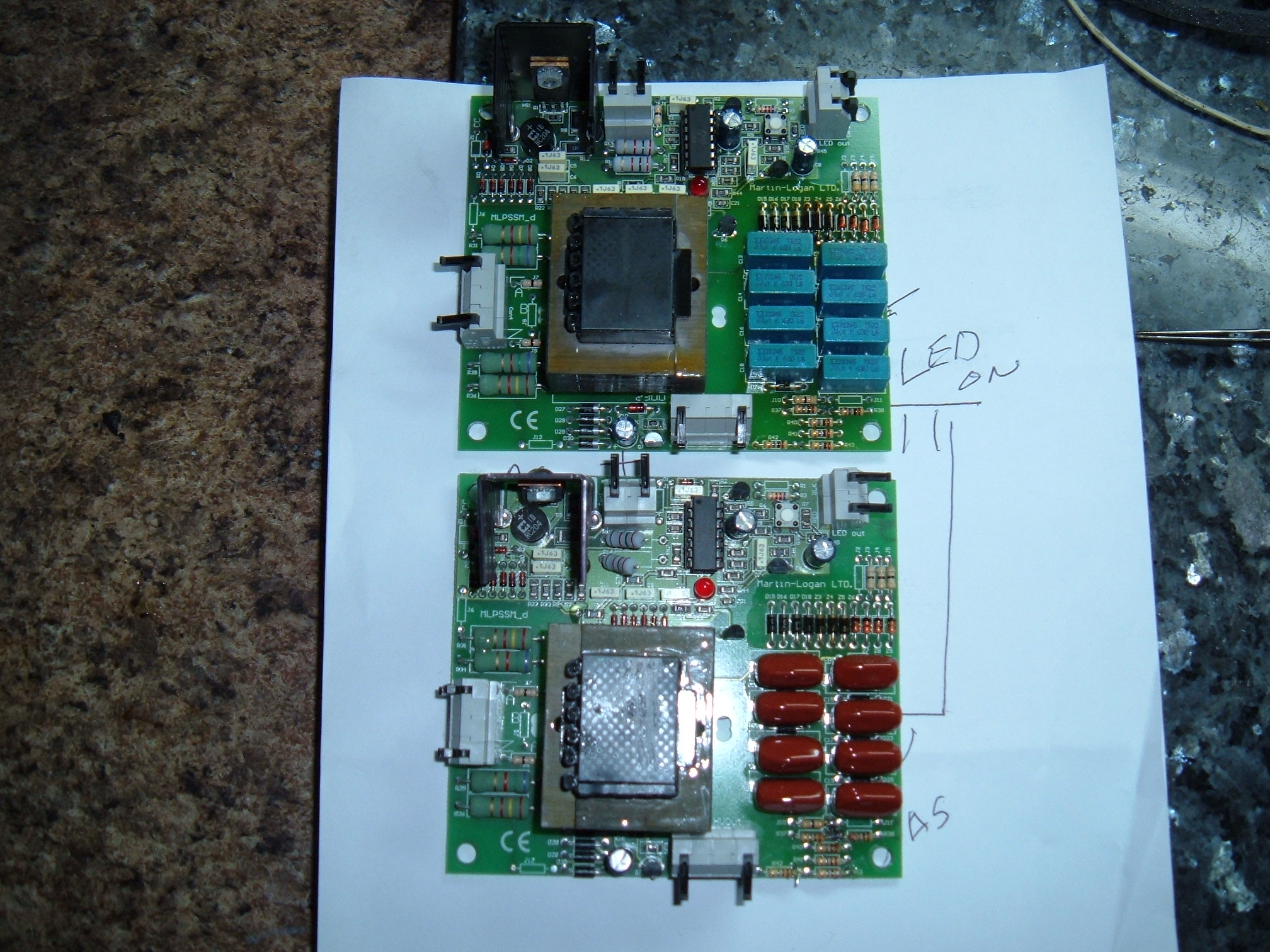

I got my 6th pr of ML Ascent......an looking at why the sound-topend-mid... was the best I have ever got out of any stock MLs........in the pic is why......you see the bias board with the brown polyprolen caps.....that came out of my Prodigy-Odyssey-Ascent I-SL3s it gos on an on......most with the Solen caps in the crossovers...some with no name caps
by the way I have never seen anything BUt these brown caps in the ML bias boards....old are new......But in the CLX..........
Then you see bias board with the Blue caps...what must have just for instore demo.....out of this one pr.....
Thats were this pr came from was a shops demo pr... they put this pr of Ascent in the back room here in fl....an the panels fell out-down. to the floor...all 5 pr I have got ....this had happen.....yes it pulled all the wires loose ...from the panels...an thay would not play.....so thay got $40. from me for the pr of speakers....sold as parts.....but I work on ML panels a lot....took about a hr...an there playing now...
So now back to the sound of thees bias board caps......I have used V-caps in the crossovers.......an minny other caps to tune the best sound out of ESLs..........well you have to know none do what the bule cap upgread in the bias..... did for getting the best sound I got yet out of logans.....I have said this be for...but more time needs to be put in to the type of parts in the bias in any ESLs......it look to me like the bias sets up.....it can be said... is the sound......

As for the blue an brown caps.....ML uses longer diodes stringd low V caps....1mf 630v..
the brown ones are a dime a dozon....I use them in tube amps from time to time....but there too dark sound.....the blue caps....S+M 33345 1u 630v.......never seen...
So because of the low v cap used...you can find minny ....vary good caps....how about the better diodes....An the bias feeder res.....10-15mg ohms.....theres better sounding for sure.....you can get the ones there using from ratshik........Anyone....????....thay got sound better...
the only way that a sonic difference could possibly occur is due to a difference in Bias voltage level.
If that is the same the only difference would take place in the listener´s brain, as the Bias supply is completely out of the signal path.
But then again, our Brains are strong in imaginating 😉

Well The caps are the same 630v....1u....an if the better sounds ...are only in my in my brain.........or I gess it......its Voodoo-Magic......right.....better parts can sound better....just not to you ...or if it not on paper...good luck

Yes i agree Calvin, i had no expectation of any sound change, I was just looking for better quality / longer life components and was surprised when I listened

My point being the change to the sound that these Caps gave.....no upgread to the crossover would have...ever....I have now to be sure it not in my mind...put these bias boards in my SL3s.....had same change....it give a sweet topend that made me think the
the mylar was diff.....Lot more 3d....extended..top....only chang was the bias board...all stock crossovers........
Sorry but I see the Bias as the-in signal path......in any ESLs...it the mylar that makes the sound.....cant get closer to the path....as I hear-see it....I well be working on a mix.....of caps
It means I was surprised - the new resistors and Wima cap in the HV setups sounded cleaner, more detailed - the first 15 minutes they seemed muddy and I thought I made a mistake or the new components were breaking down, then as the music played they got more resolving than the original parts. I didn't expect that.
