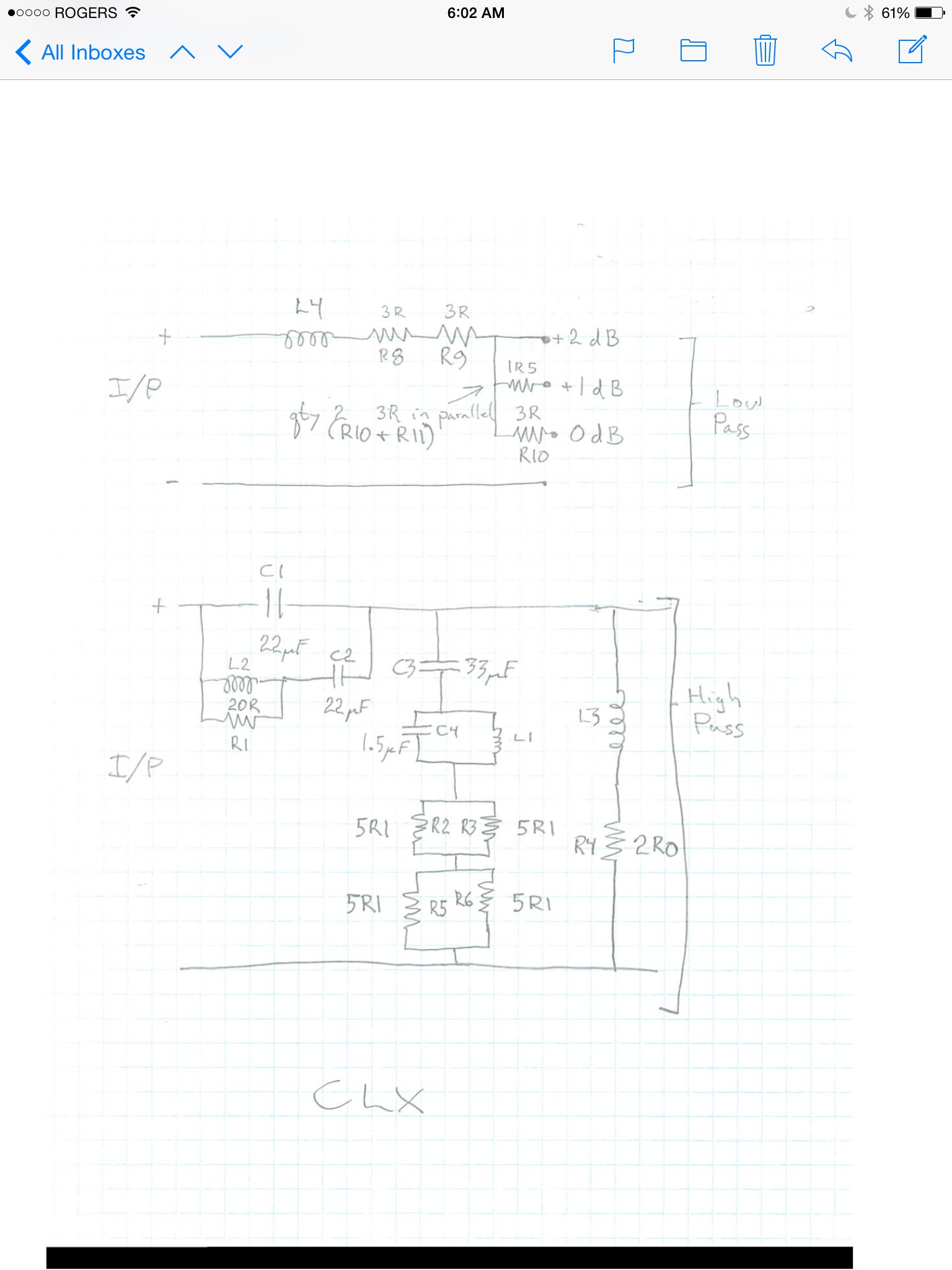

Schematic courtesy of a friend updating his CLXs
No inductance values yet - will try to get the inductance and series resistance of the coils - all air core -

There are 4 Solen caps in the crossover board.
The crossover caps are 2 x 22uf, 1 x 33 uf, 1 x 1.5 uf
22uf - replaced with a parrallel sandwich of 2 x 9 uf 100V MIT PPFXS
The 2 x 9 uf and 0.01 uf caps fit where the Solens did
Note - The 9uf MIT PPFXS cap is the largest cap with the same width of the Solen caps which is why it was chosen - becuase it fits, takes the least space, and sounds good.
Thinking about changing C1, the series capacitor for HP.
What is the size that actually fits?
Considering Jantzen which is 52*70mm 22uF 800V and Mundorf 51*106mm 22uF 800V.
