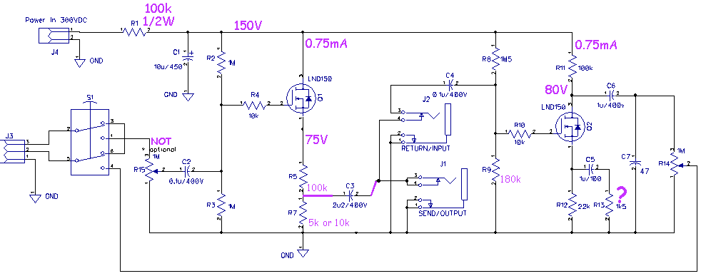

Marshall FX loop
> thinking about the heat dissipation
The signals at the jack are part-Volt. WTH do you need a 280V supply?
From clean sheet I would pad-down first (since this may be coming from a clipping tube stage). However I don't feel like re-drawing. Still the pad may usefully be made part of the driver. And even if you only have 300V power, you can drop a lot on-board so the transistors don't cook. I also would not use R13 (or not so small) if you have to pad-down after. C5 may be smaller than best bass response needs.
This comes down to personal preference. 300 volts DC is conveniently available, most 9V FX pedals can put out up to 6 volts peak-to-peak, and typical (half-12AX7) recovery-stage gain is 50x.)
Put together, that means if the FX recovery amp can cope with 300 volts p-p output, the FX loop is very unlikely to ever clip, even fed from an overenthusiastic distortion pedal turned up to maximum gain and maximum output level.
Is this absolutely necessary? Probably not. But is it a bad thing to have the extra headroom? Probably not.
I assumed the loop output would drive either a normal 12AX7 gain stage, or a long-tailed-pair phase splitter. The first of those will typically accept nearly 4Vpp before it starts to clip, the LTP will need twice that, or 8V pp.
R13 was chosen to provide a voltage gain of 50x, bringing a nominal 100 mV RMS signal at the "Return" jack up to 5 volts RMS at the MOSFET drain. Enough to just clip the subsequent stage, if that is desired.
Cobretti is the only one who knows exactly what comes before or after the FX loop, so he's the only one who can make a more informed set of design choices.

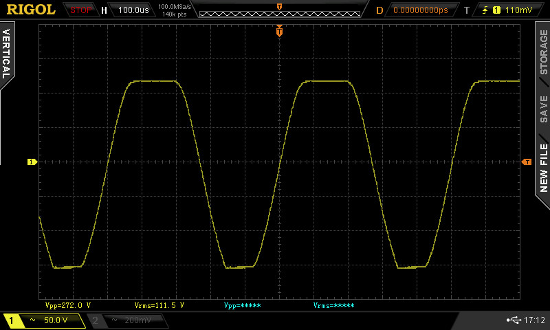

Thanks for your help guys. I have changed the 47K R5 to 100K. It did help to reduce some heat of the Q1 transistor, but the transistor is still hot, but nothing to worry about I guess. I have also reduced the R12 to 15k as Gnobuddy suggested and the output is now more symmetrical. I didn't resolve the low frequency roll off yet but I think it might be coming from the SEND stage around Q1. The small (78 mVrms when testing) sine wave on the SEND jack seemed some kind of refined - more sinusoidal compared to 3.4Vrms signal coming from the treble potentiometer side, that I distorted on purpose so I can compare in and out. I hope I am not dealing with something stupid like those plated contacts on the Neutrik jacks, are they fooling me? I was recently reading about ferrous materials in signal path in SS amplifiers, especially magnetic banana binding posts can ruin your day when you do your low THD measurement, the number can change by order of magnitude.
...Q1...still hot, but nothing to worry about I guess.
Yes, it should be fine. Approx 1.5 mA, a bit over 150 volts from drain to source, so under 250 mW power dissipation. This should be fine - typically, the TO92 package can dissipate up to 600 mW before the semiconductor inside cooks, so you are now operating at less than half of maximum dissipation.

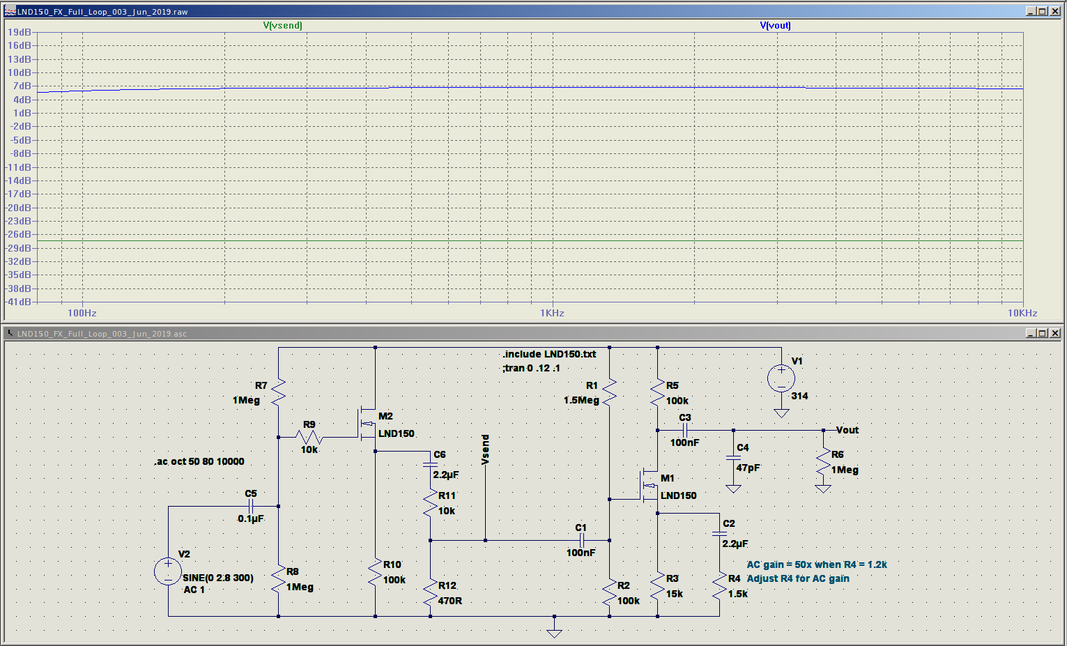

If you used the values in your last schematic, no it is not the send stage. See attached LTSpice simulation, which shows both the send and return stages are flat from below 80 Hz to beyond 10 kHz, which covers the full guitar range.
I chose the "Return" MOSFETs 1 uF source bypass cap to cause very slight bass loss at 82 Hz. As I mentioned earlier, you can increase this to 2.2 uF if you want to eliminate the very slight bass loss (I did this in the LTSpice sim attached to this post.) Or just go for massive overkill and plug in a 10uF, 25V electrolytic capacitor, positive terminal to the MOSFET source.
Speaking of which, there is nothing wrong with electrolytic caps. Every famous piece of music you ever heard has passed through dozens of electrolytic caps before it reached your ears - they are in every classic guitar amp, every mixing desk, every microphone preamp. Just about every analog piece of audio electronics is full of aluminium electrolytic caps, except for a few overpriced toys sold to audiophiles with too much money and too little knowledge.
You can also use multi-layer ceramic caps (MLCC), which are now available up to 25uF or so, at low cost. They are excellent capacitors, compact, affordable, and work very well. Get the through-hole versions, unless you're prepared to deal with SMD components!
The source impedance is much lower on the Send jack, and I'm guessing that reduced the amount of hum and noise pickup that the oscilloscope was seeing.
Neutrik jacks have a long history of excellence. Plated contacts are a good thing, as that reduces corrosion, reduces contact resistance, and extends contact life.
I have never had a problem with a new Neutrik. Like all jacks, they will eventually fail, usually after ten or twenty years, but that is to be expected. Mechanical parts always wear out eventually.

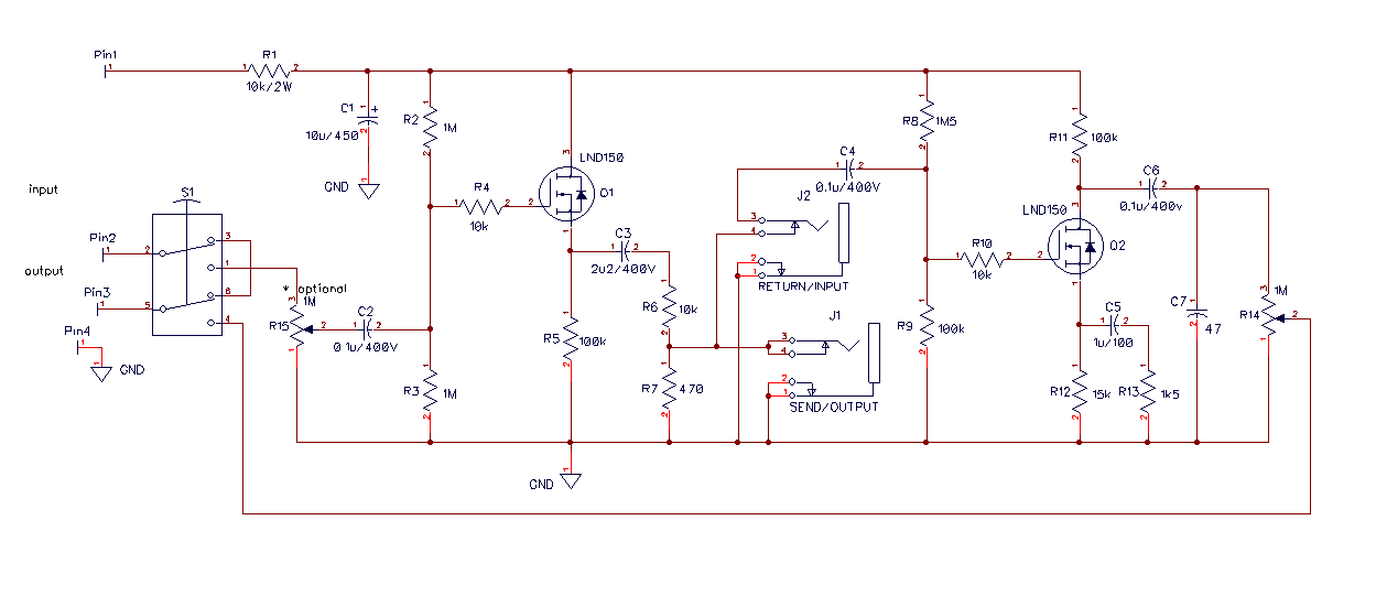

Hi guys. I read everything. I try to understand how you choose the values for the CS amplifier in the return side. Let's say I have a 300V supply and an lnd150. I want the maximum AC voltage gain, I understand I have to bias the mosfet as symmetrical as possible to have the lowest distortion. But can it get get the maximum swing with any Id ?
Do you choose the gate voltage arbitrarily (20V why not 60V, or half the supply) ? Any gate voltage will give me the same gain ?
I understand the gate voltage is used to bias the mosfet with Rs source to an Id, but why did you set Id to 1.3mA (with the 15K) ? why not 2mA ?
In 1948, getting enough voltage gain was difficult. Even relatively new "high gain" triodes like the 6AV6 (identical to one of the two triodes in a 12AX7) struggled to get a voltage gain of fifty times (34 dB) in a practical circuit.
That was more than seventy years ago. Modern semiconductor devices have enormous amounts of gain available. Left to itself, an LND150 will give you too much gain - far too much to be usable. So we definitely don't want the maximum voltage gain we can get from it!
Instead, we need to lower the gain from its maximum, and set it to the value we want. In this circuit, this is done by only partially bypassing the source resistor. R13 (1.5k) keeps C5 from ever completely bypassing R12. (The numbers are from Cobretti's latest schematic, in the post immediately after yours.)

I don't think Cobretti ever specified what the desired output signal level was. I assumed it could be anywhere from 4 Vpp (to fully drive a half-12AX7 gain stage) to 70Vpp (to fully drive a cathodyne phase-splitter.)
While the nominal "instrument level" signal from a guitar pedal is 100 mV, any member of Spinal Tap could easily achieve 6 Vpp from his ThunderThrobber Maxblood distortion pedal powered by the usual 9V, simply by turning up gain and output level knobs to eleven.
At the same time, assuming 30 mV in (from a more refined guitarist) and a voltage gain of x50 gives you about 5Vpp output...just about right for a subsequent half-12AX7 gain stage. And a voltage gain of x50, combined with a maximum input of 6 Vpp, requires a B+ voltage of 300 volts.
So I don't think running the FX loop in a tube guitar amp on 300 VDC is a terrible idea, though 100 Vdc might have made some things easier. I think having a large power supply voltage here allows the FX loop to have one of the nice features of a tube guitar amp - lots of headroom before clipping, which in turn guarantees no nasty solid-state distortion from the FX loop.
-Gnobuddy
