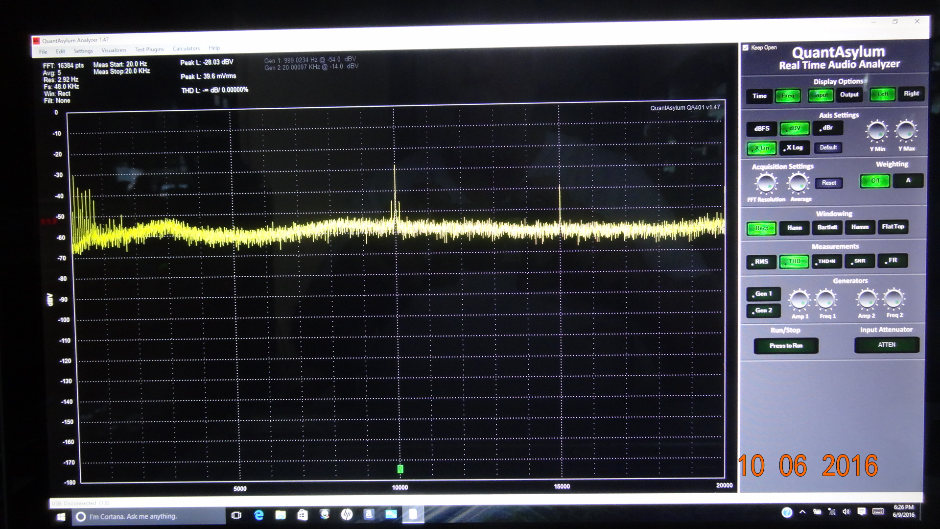

It was mentioned before but if you do not like to do matching of transistors, you can buy a complete matched set of all transistors from Tech-DIY LLC. This takes a lot of the work/time out of the project. The output devices supplied are 2 each of the -649/669 types.

Recently, I tried this package of matched transistors and tested it. The results are excellent: All harmonics were well below -100dB. depending on PS voltage and load, the harmonics were typically in the -110-130db areas. Again, using only 2 diode bias; two diode produce 100mA ouput current draw while 3 diodes will double that to 200mA idle in OPS.
So,you can use the matched semiconductor package from Tec-DIY LLC. without worry about the results not being as good. Plus, you can use +/-24vdc PS for greater load driving ability at very low distortion as the output devices are rated for higher voltage. However, the drivers (Vas stage) and OP stage will need greater heat sinking if you do.
THx-RNMarsh
So, when do you need to use 3 diode bias string? Well, if your headphones are <100 Ohms, the thd will be higher with 2 diodes and <100 Ohms.
Use three diodes for <100 Ohm headphones to keep the thd at minimum.
THx-RNMarsh
THx-RNMarsh
